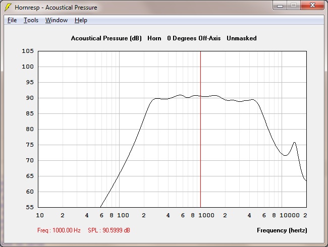

Tools --> Driver Arrangement.
It shows up on the Input Parameters screen, e.g. Nd [2P 2S] is how it displays when you wire 4 drivers in series / parallel to maintain the same resistance as a single driver.

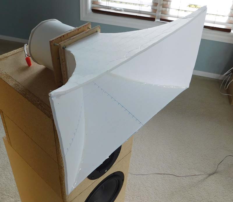

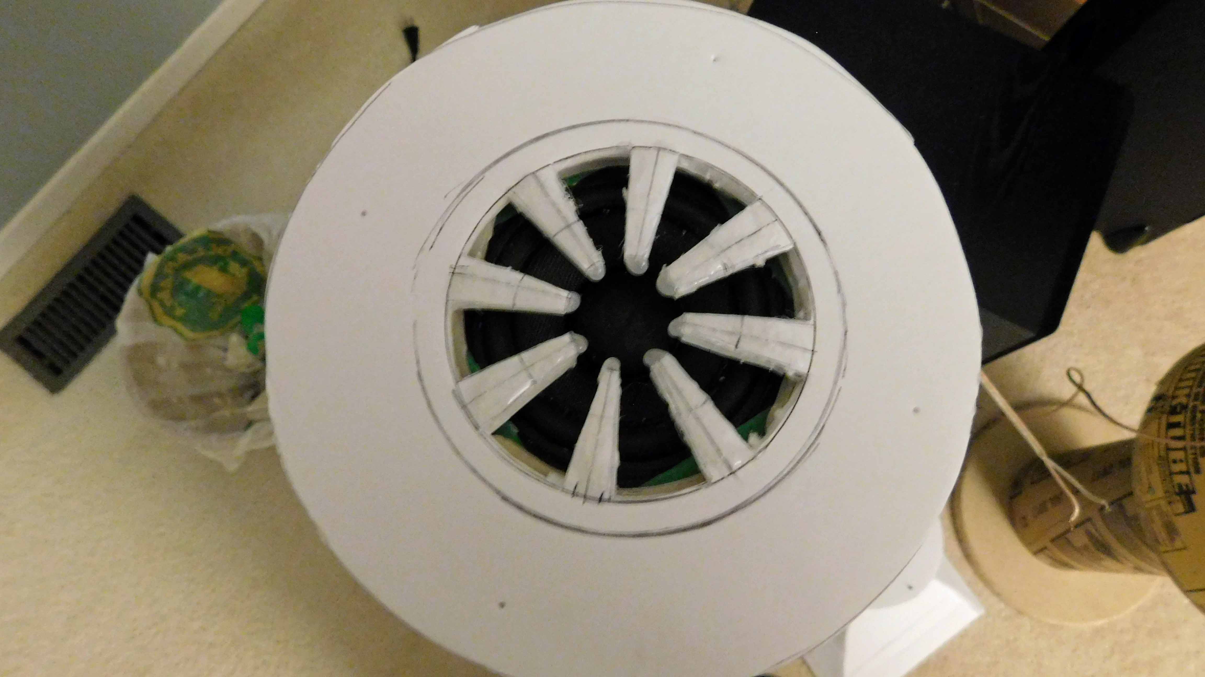

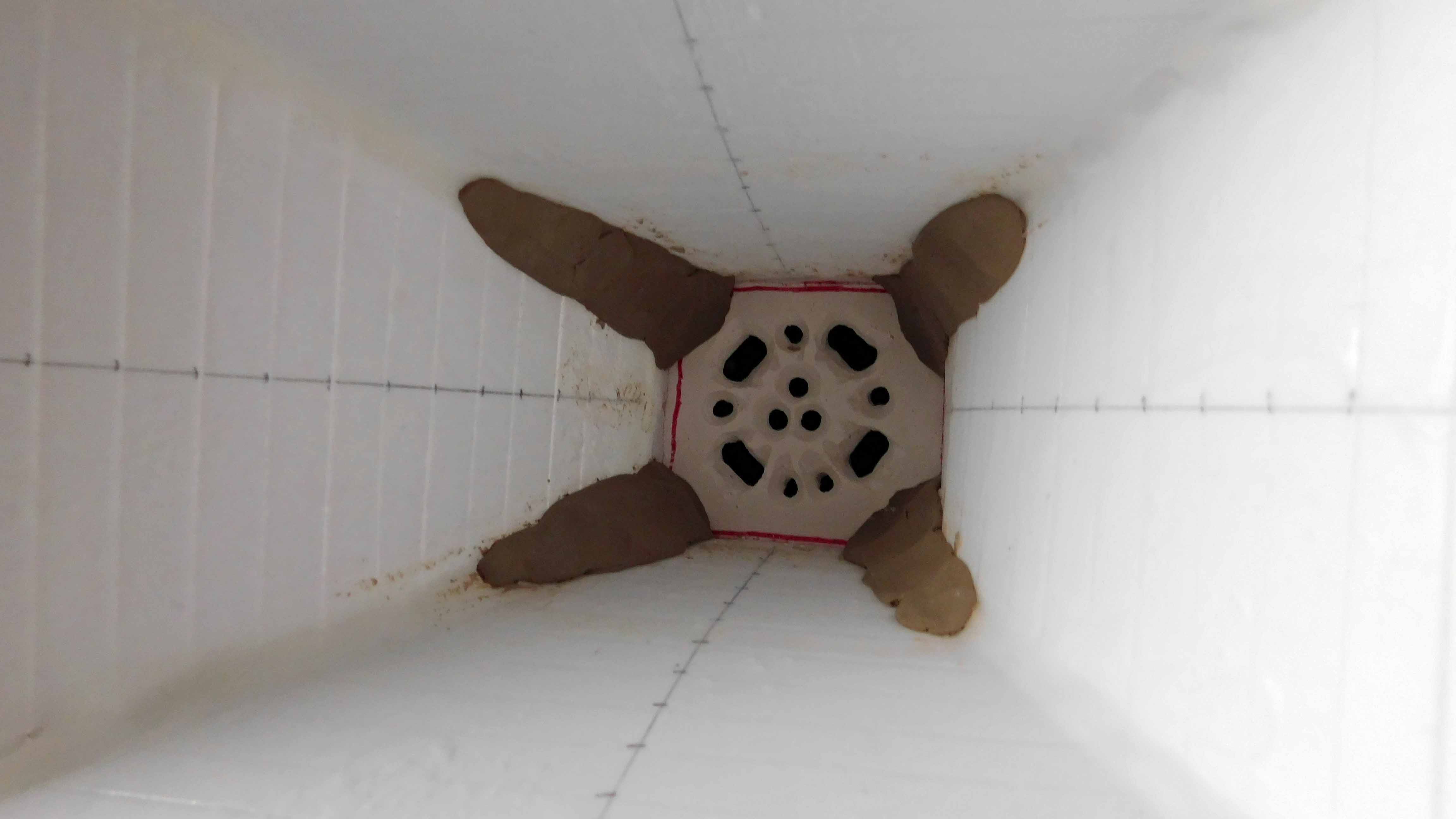

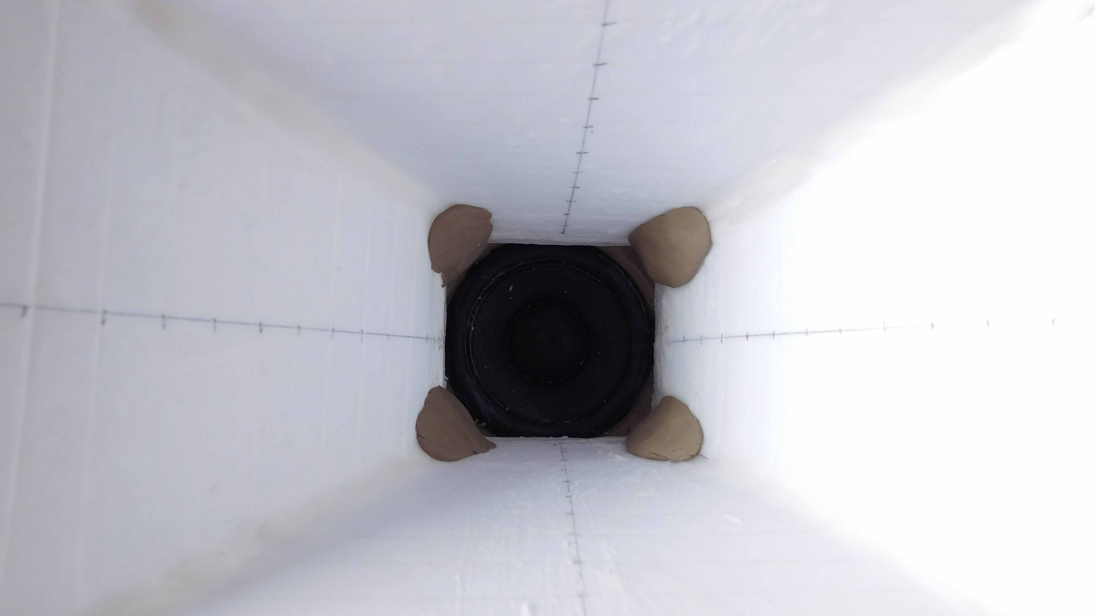

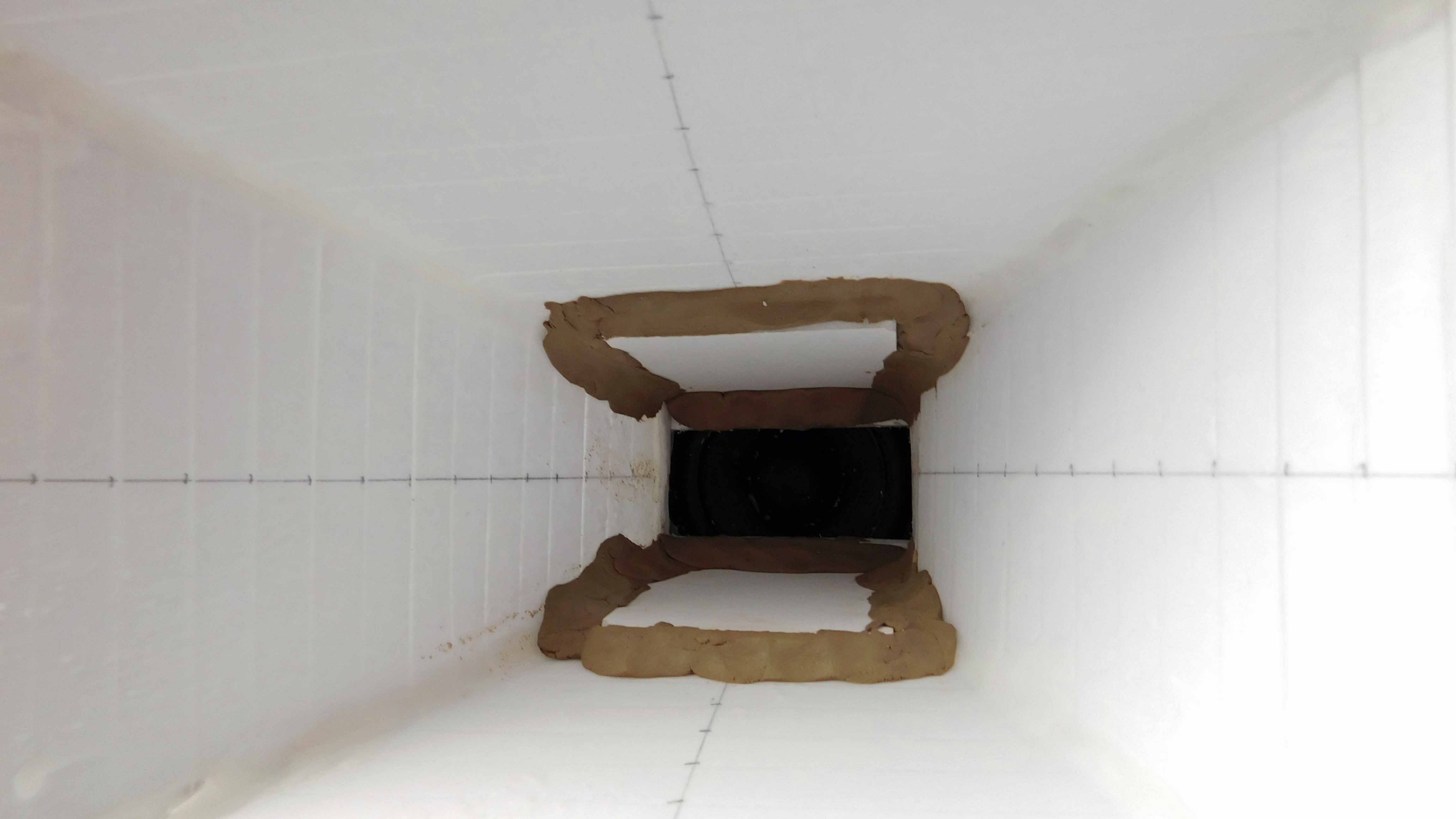

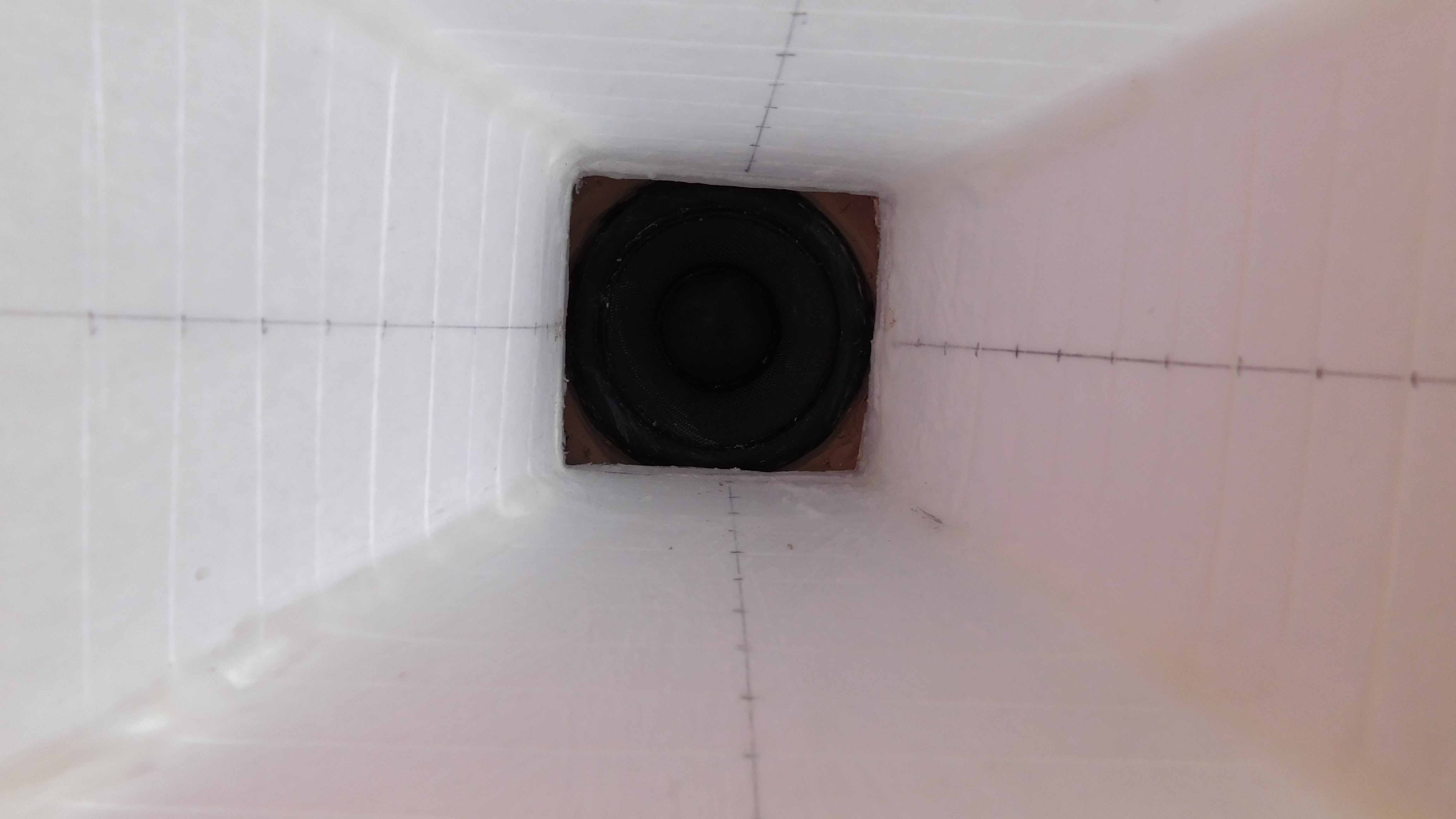

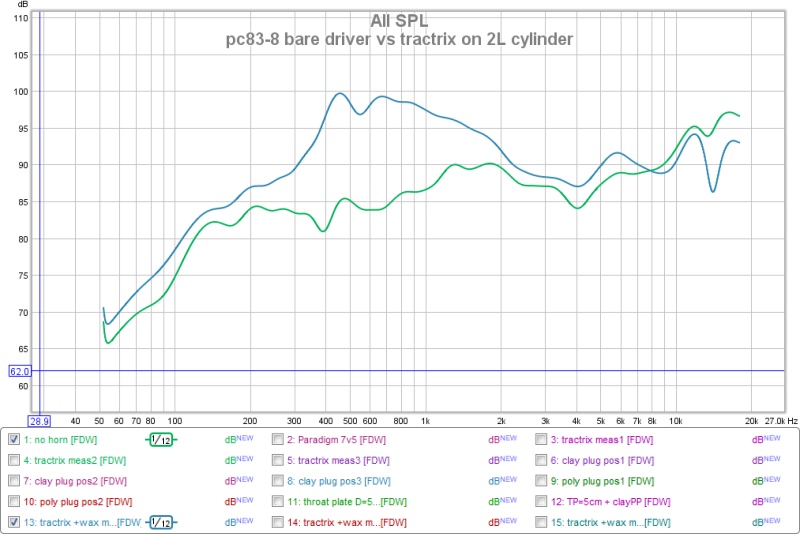

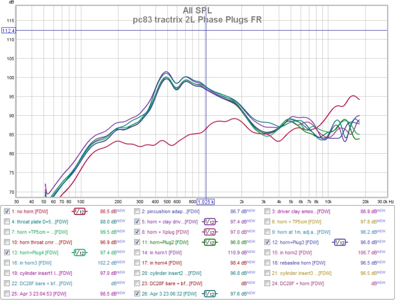

Tractrix with phase plugs and other corrections attempts

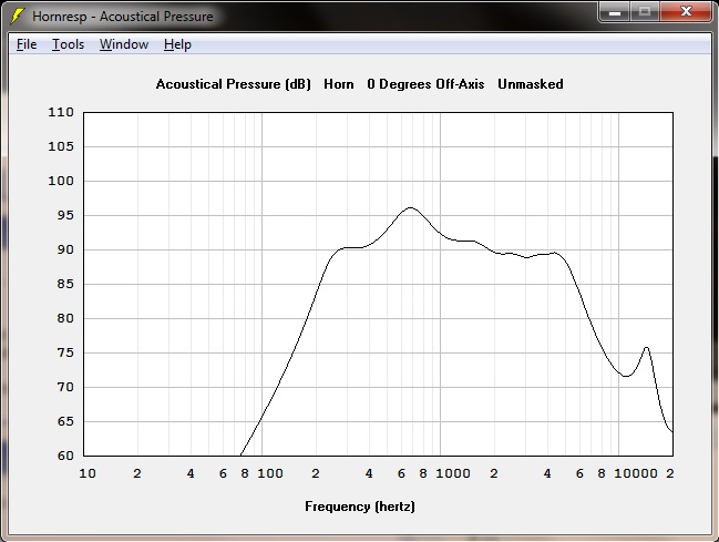

After some reading and many attempts I still can't extend the horn gain in the 2Khz to 4Khz region using throat adapters or phase plugs or other tricks. Graph #1 shows the effects of the trials, all impacts are in the higher freq range above 4Khz.
I even suspected the horn itself and replaced the pc83 full range with a dc28f tweeter to see if the horn even worked at higher freq, and it does. Graph#2 shows the gain at higher frequency, with a nasty hole @12K that I created with my adapter.
The rest are some pics of what I tried with the pc83. Still not sure why the response falls off in the 2-4Khz range. It was the same behaviour in the previous horns.

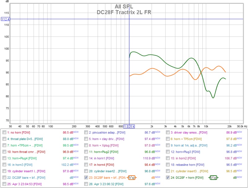

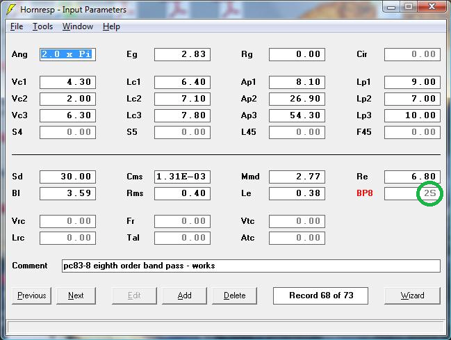

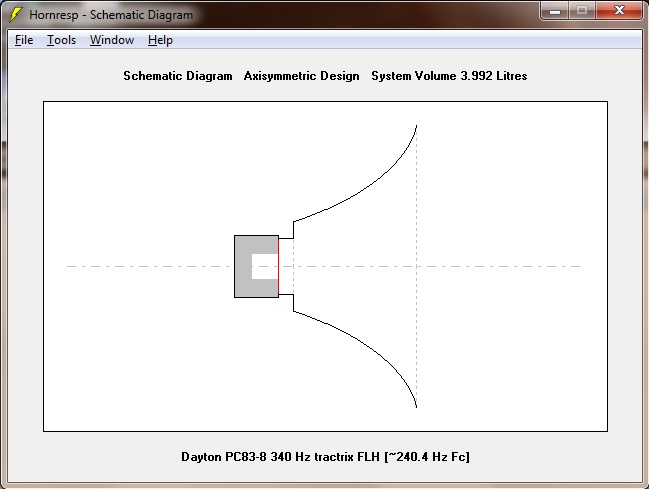

The last time I simulated multiple drivers in hornresp, you had to change the parameters yourself, there was no way to just increase the number of drivers.
The Multiple Drivers tool was added in Version 5.40 almost fifteen years ago. Hornresp is currently at Version 42.60.
Since you've obviously much more proficient with hornresp
I should hope so, given that I am the author of the program.
would you please kindly enlighten the readers by which of the parameters in the screenshots you've read the use of two drivers and especally, in which configuration?
See the green-circled entry in the attached screenprint of the original design in question. "2S" means two drivers connected in series.

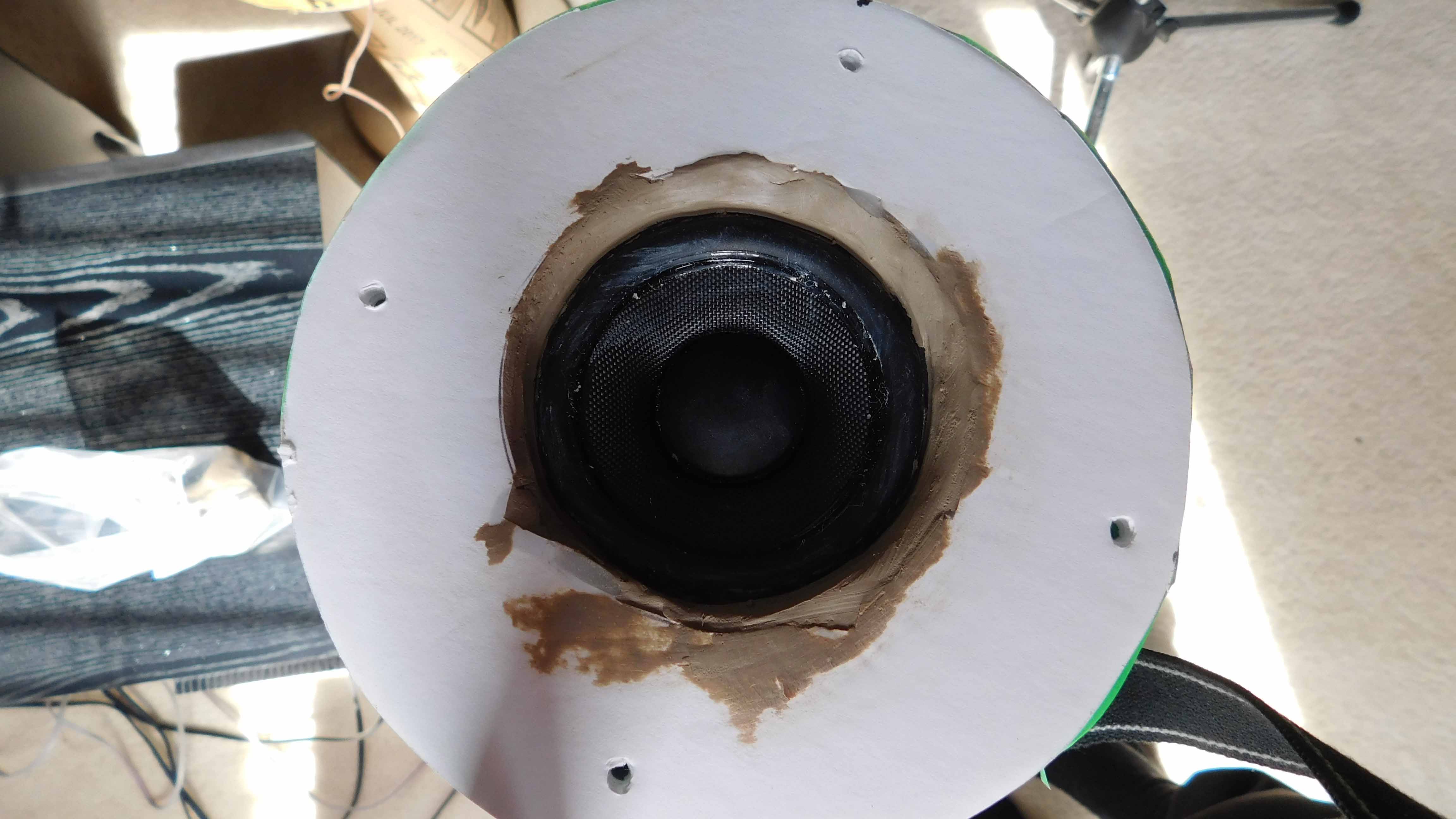

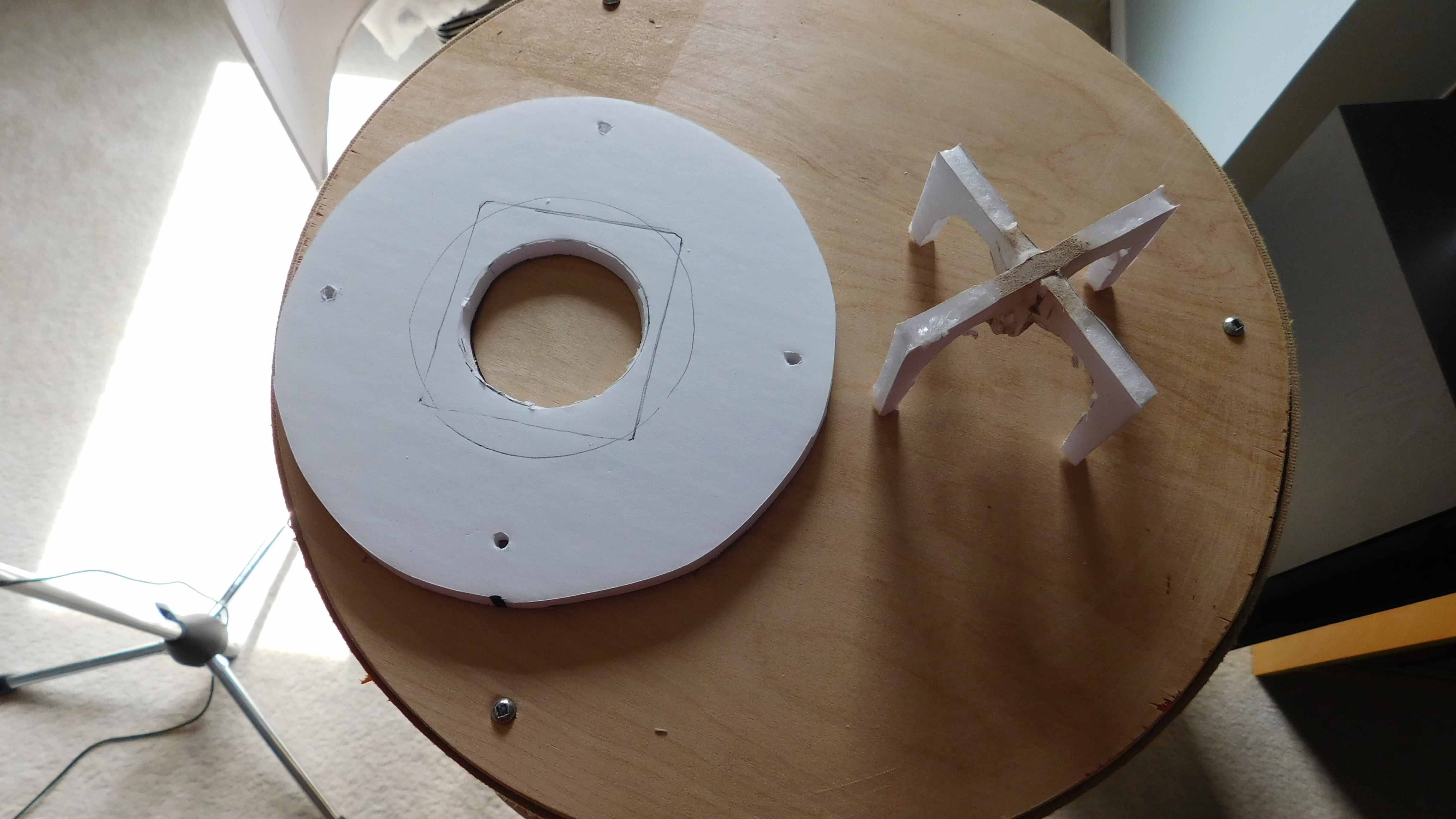

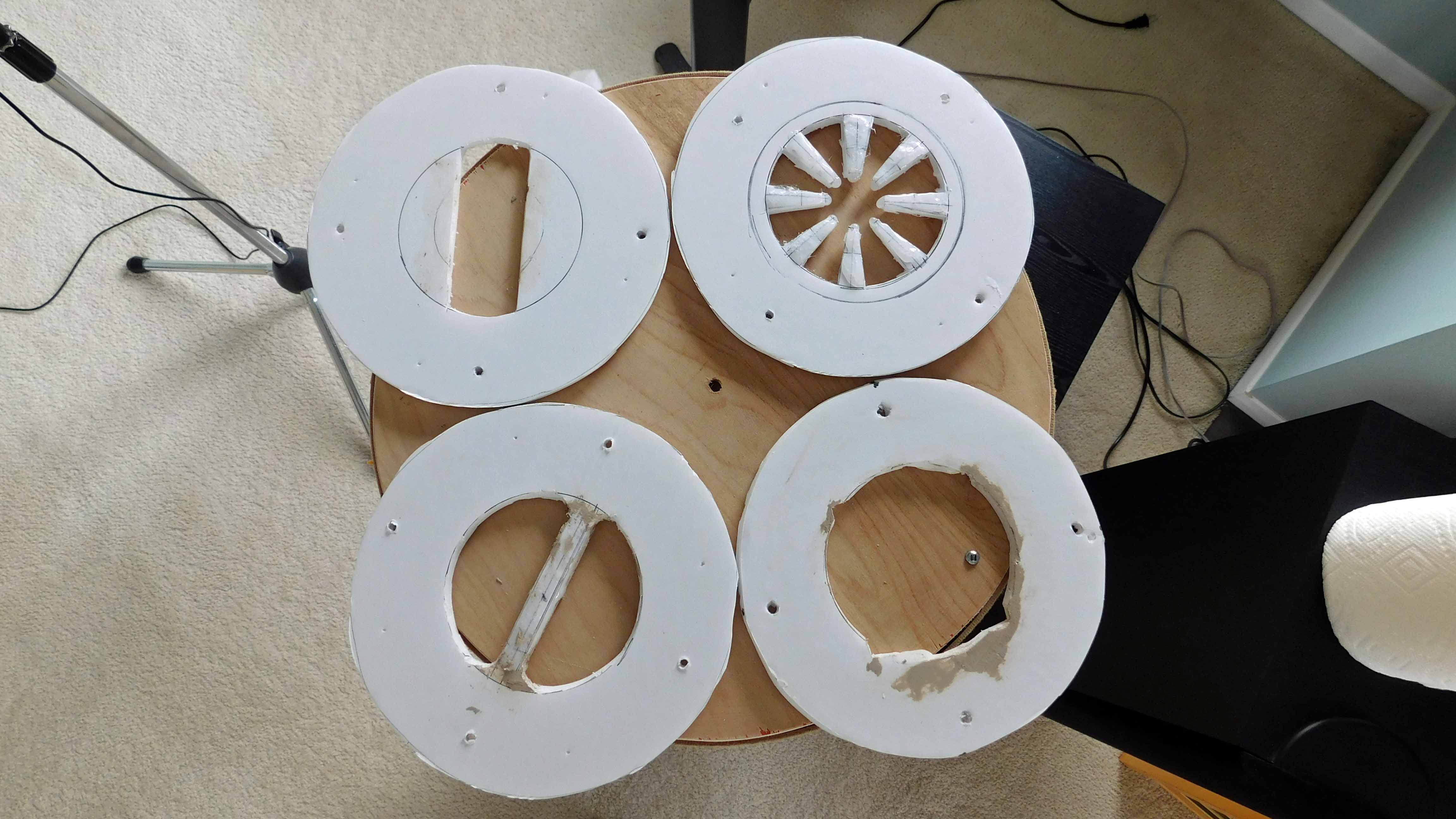

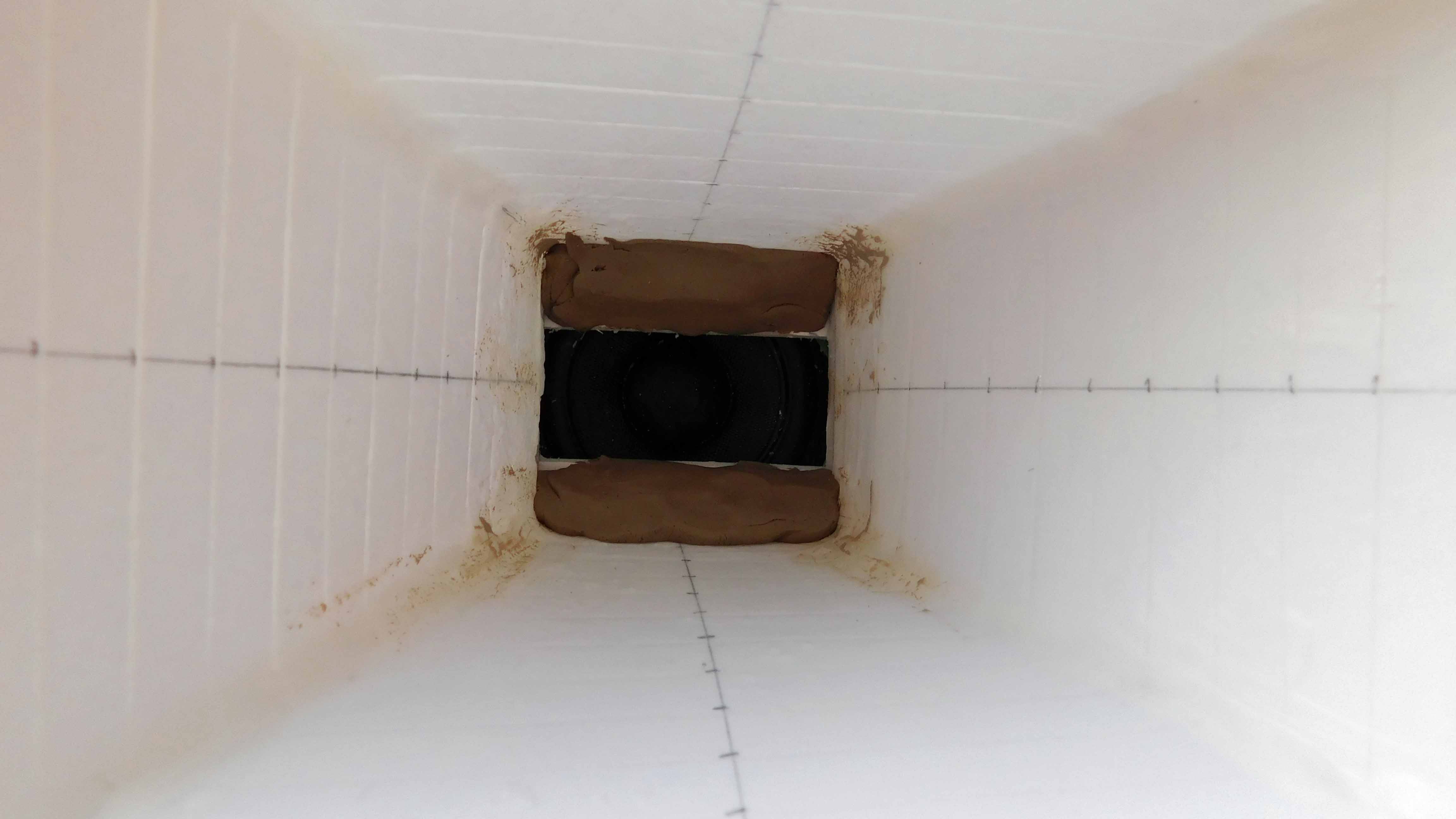

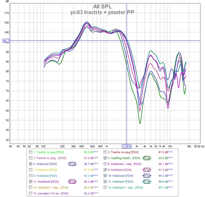

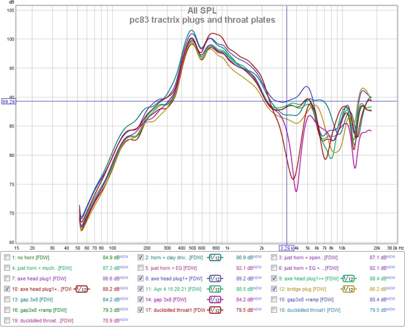

more tractrix phase plugs and throat plates
So I tried some more tricks to see if I could elevate the 2Khz-4Khz horn gain. Various throat plate adapters, and axe shaped phase plugs, and narrowing the throat. Nothing worked.
Its almost like the driver is loosing power. I did notice on the impedance curve that the inductance does not increase as expected. In fact it rises so slowly the REW cannot extract T/S parameters. It might be from the driver shorting ring (cap) to help at higher frequencies. Still not sure because I haven't fixed it yet.

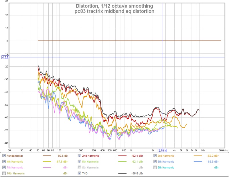

Pics show some things I tried. Graph #1 shows the LF is unchanged, but in the 2-4Khz there is never an improvement.
So I threw in the towel and took what I had and EQ'd flat then LP'd the midband as best I could could as seen in Graph#2 (purple line). As a side benefit the midband distortion is lower (-60db from 400-2Khz) with a horn.
Interesting - it seems that the attachment was removed some time after my message was posted.
I will try again:

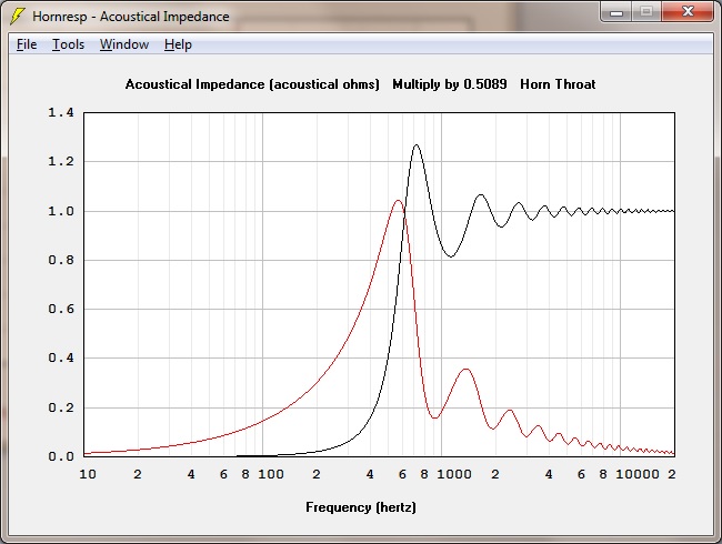

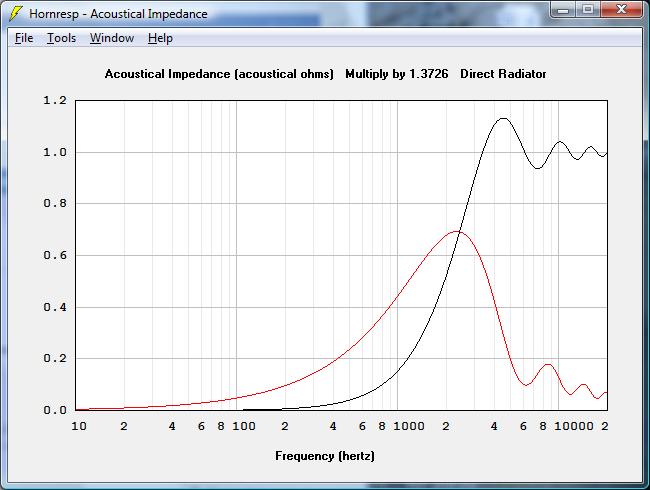

I think your horn provides the expected ~3 octaves of gain, but the driver simply does not have the motor strength to "power through" at higher frequencies, so you're left with EQ'ing as you've found out.
The image shows standard elliptical waveguide - it looks a bit squashed by design 🙂.
The actual tuning was performed using a "G" clamp. The tricky part is determining where to position the clamp, and by how much to permanently "dent" the waveguide by tightening the clamp (the clamp is then removed). Return loss / VSWR is closely monitored while the localised dent is applied. The technique is more an art than a science, but very effective when done correctly 🙂.
Thanks for the hint via the impedance matching analogy. I'm just happy it didn't involve a Smith chart or stubs. 🙂

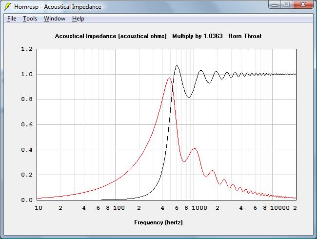

It's why I'm seeing the behaviour in this midhorn. The tractrix horn is operating above cutoff so its acoustic impedance is constant. Compression drivers are meant to drive constant impedance and would work, except they usually don't go very low. The cone driver is meant to drive open air and its acoustic impedance changes with freq (squared?) and cone size. So the cone driver compensates for this by design. So my 3inch driver has a serious impedance change in the 1Khz-4Khz range which is where the problem is. Its why it occurs in all my horns.
I come across a paper by Dr Bruce Edgar [SB 1986, Midrange Horn] where this problem is described. He used 5-6 inch cones which push the impedance transition lower but it was still a problem. He found very few of the drivers tested were suitable and the best had a naturally rising response (less compensation?).

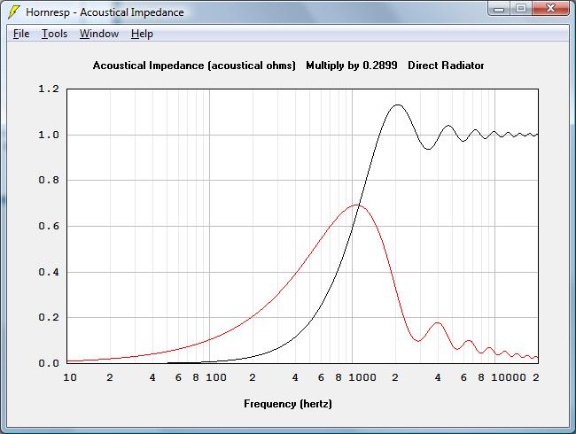

I added a few pics of the acoustic impedances of the horn, the pc83 and a larger 6inch driver.
Maybe, I'm trying to think of a test for that.
I was only after 3-ish octaves [800-4000Hz] and the horn cutoff is below 800Hz. The SPL drop is in the same region as the acoustic impedance change for this 3inch cone driver. If the motor was power limited I don't think EQ would save it.

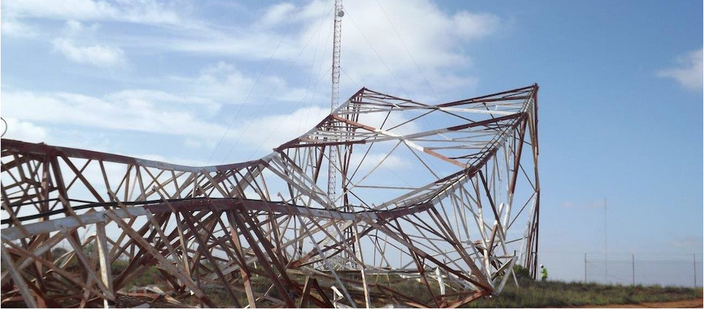

Another interesting project I worked on back in the late 1970's did in fact involve a Smith chart and stubs - to better match a 250KW shortwave transmitter via an open-wire transmission line to a large curtain array antenna. The towers at each end of the reflector curtain were 100 metres high 🙂.
That is a very big antenna. I'm assuming it was long range and intended to bounce off the stratosphere. You don't hear much of shortwave radio being used anymore.
Your assumption is correct 🙂.
The curtain antenna was used to radiate Australia's international radio broadcast service 'Radio Australia' into Asia (similar to the BBC World Service and Voice of America - VOA). The station closed on 31 July 1996 and the towers were demolished in March 2017. A photo of one of the demolished towers is attached - there were actually five towers in total, supporting four curtain arrays. Satellites and the Internet have made long-range HF overseas broadcasting pretty much obsolete.

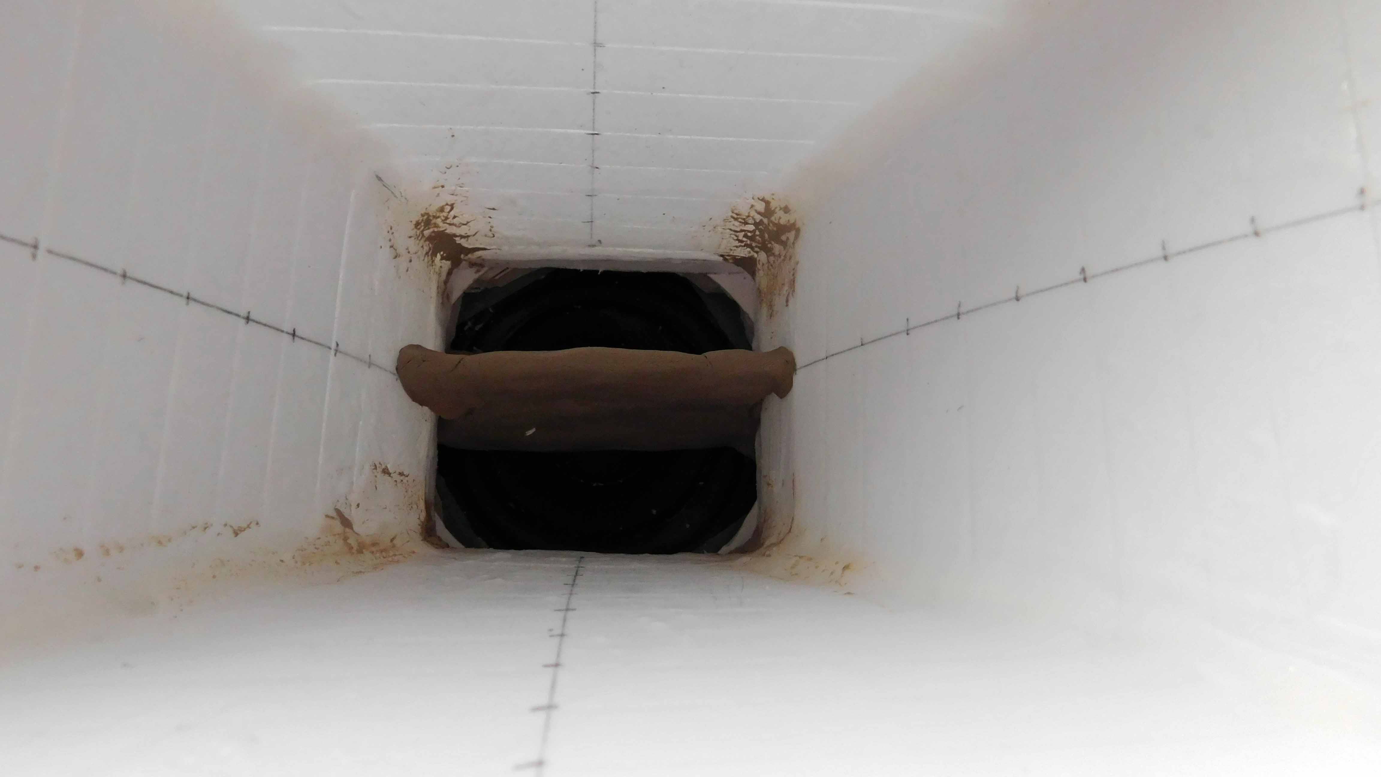

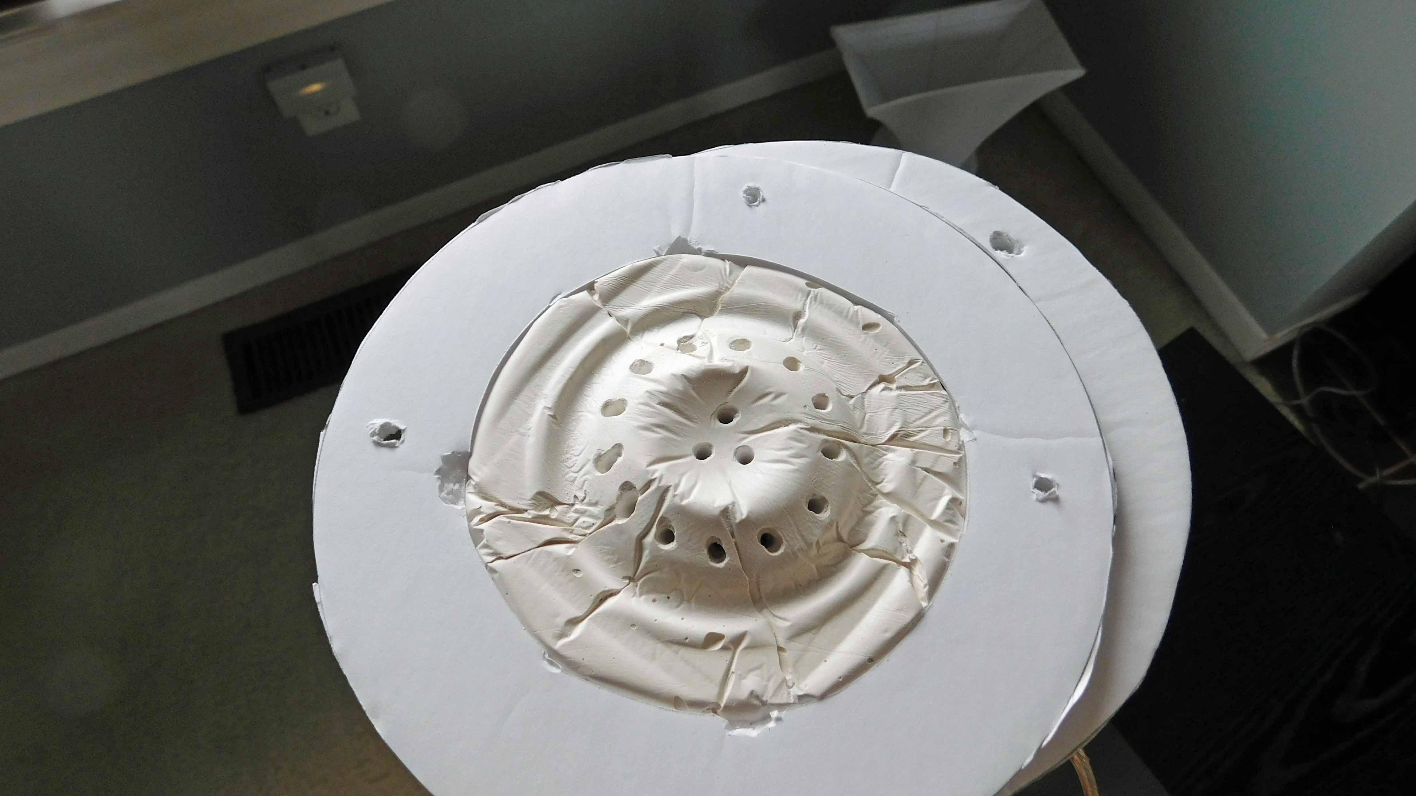

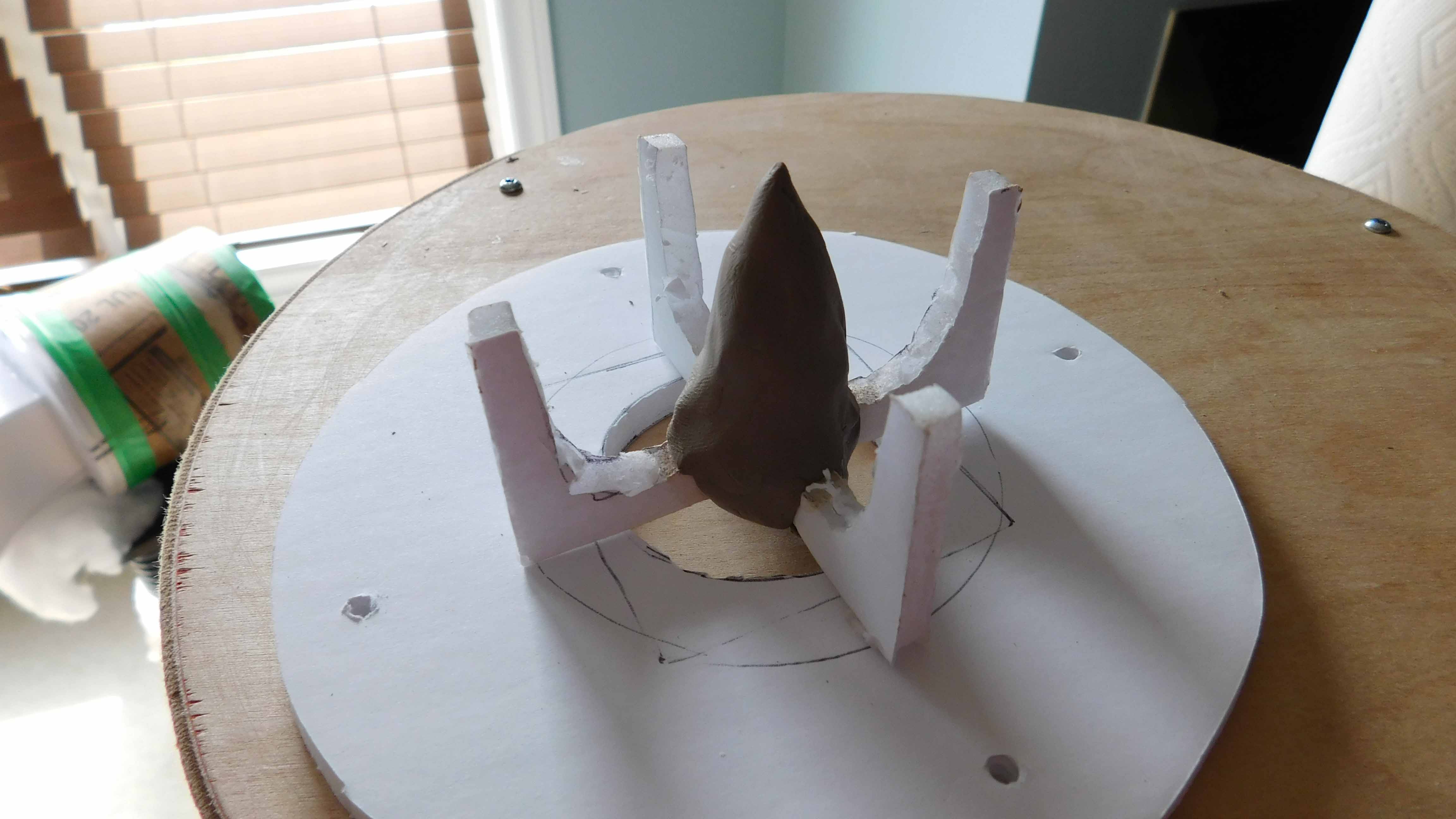

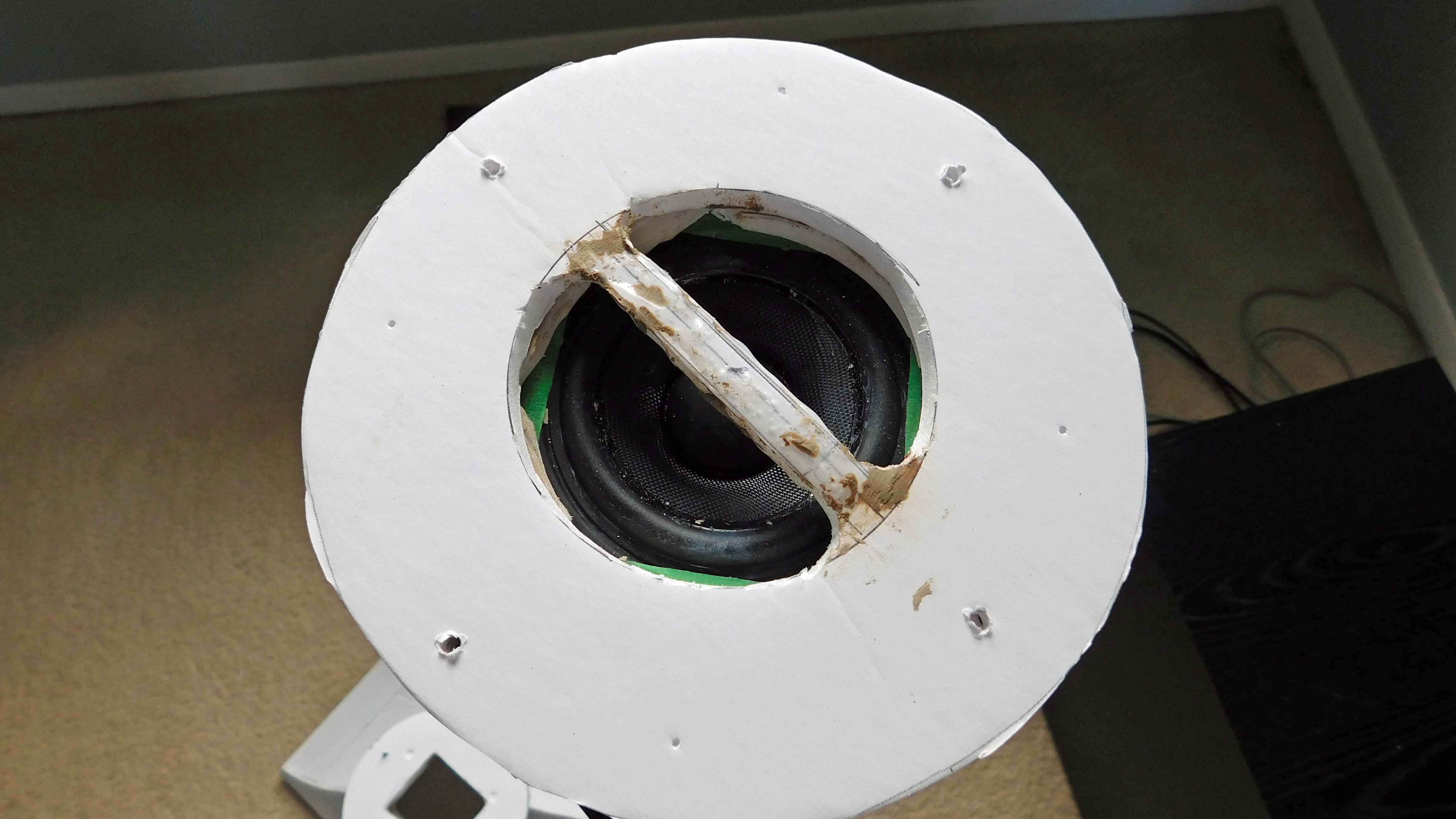

tractrix, new phase plug / front chamber
Still trying to get a usable tractrix midhorn out of this PC83. The previous ones had the typical 6db/octave drop off starting at the 500Hz peak and require EQ.
This time the front chamber volume is reduced and the throat is restricted to increase compression and velocity. The rear chamber is reduced to <0.5L by filling the cylinder with 2" polystyrene disks.
The driver cone has been replicated using a plaster of paris mold and its sitting 5mm above the driver cone. Several trial runs were made gradually increasing the hole size in the mold (restricted throat area) acting like a phase plug. I can get a reasonably flat midrange bandpass 350Hz-2KHz, or about 2.5 octaves. It's still less than the 4Khz that I was trying for, but its the best so far. FR graph is on axis, and no EQ was used.
It still has that "saddle" shape in the FR like the other horns.
I wish I could increase the horn gain in 2Khz-4Khz region. Suggestions, anyone ???

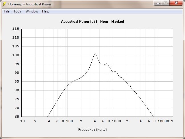

Hmm, it's upper mass corner [Fhm = 2*82.14/0.78 = ~210.6 Hz] is well below the horn's intended gain BW and will be even lower after accounting for some series resistance, so wishful thinking IME. 🙁
In such cases all I can reasonably do is blend it into its HF BW and the farther away from Fs I go the less gain BW available, so to get 2-4 k would require shifting tuning an octave higher, but apparently either my simple R-O-T design routine falls apart and/or the math does because it sims basically a sharp 'one note' spike.
In short, for high gain use over a wide BW a driver with an Fs around Fc and enough motor [Qes] to push its Fhm up to where you want the horn to roll off is the goal.
Anyway, for 340 Hz I get a ~ 3 dB BSC 'step' that fills in the driver's sagging mid-range with little/no need for EQ, though with the downside of course being pitifully inefficient, but for a small room HIFI/HT app it's sufficent when one has to deal with nearby neighbors.

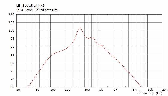

I don't understand the 'bump' as I designed it to sum flat enough based on this measurement: https://www.diyaudio.com/forums/att...c83-8-bare-driver-vs-tractrix-2l-cylinder-jpg

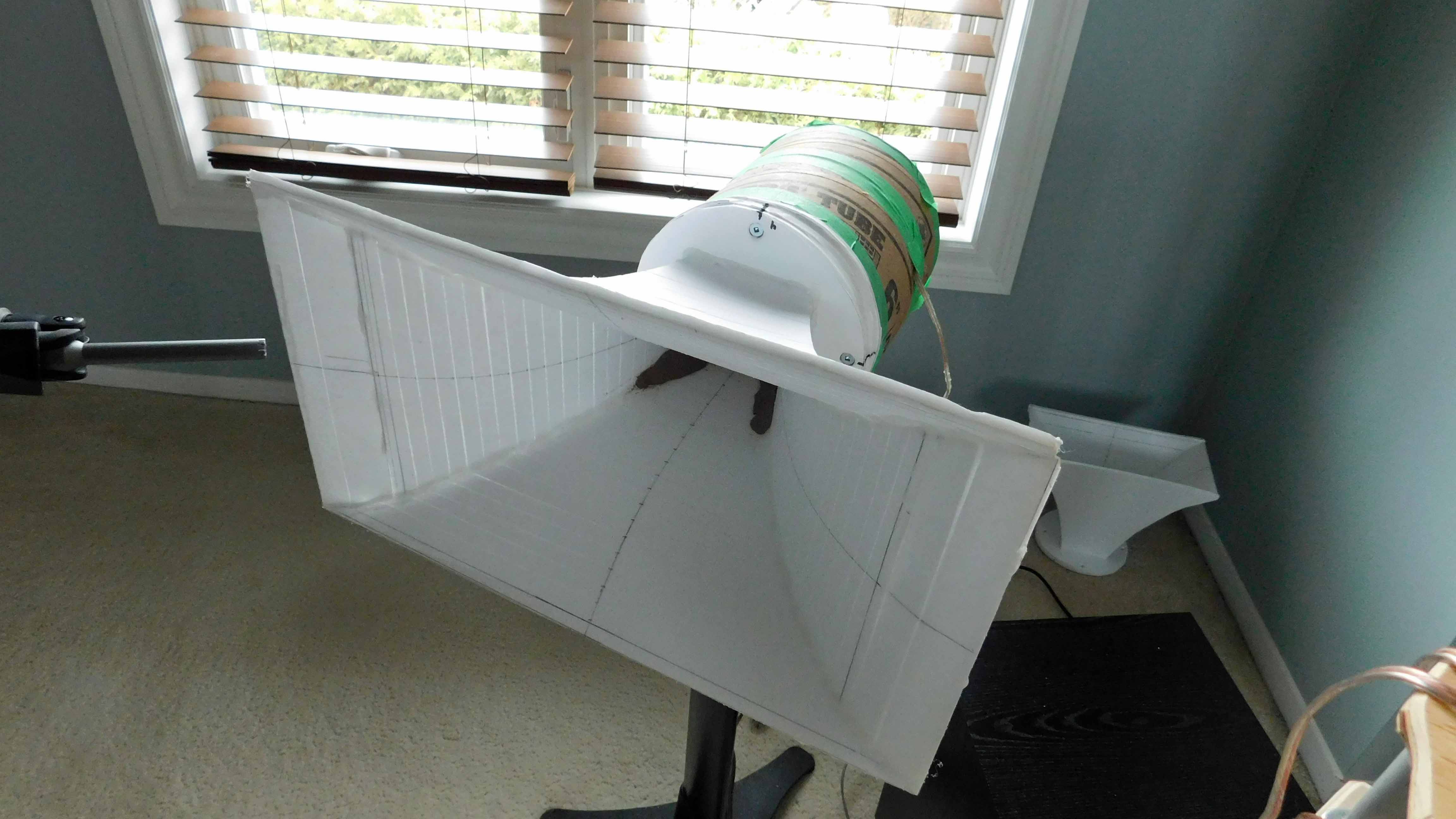

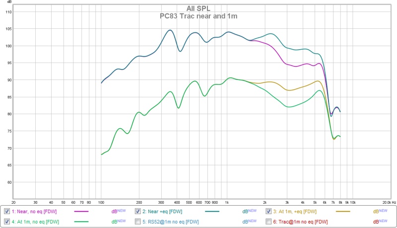

another Tractrix attempt
Based on the previous few posts with @GM, I made another Tractrix. Can a $10 driver (PC83) be convinced to drive a midrange horn?

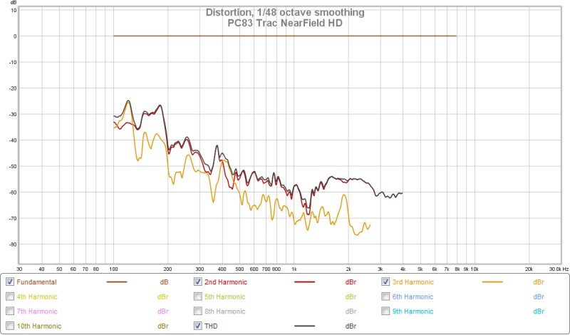

The LF roll off is around 300Hz as per the model prediction due to the small rear chamber (0.4L) plus lots of FG stuffing. The BW is extended but it still has a dip between 2Khz-4Khz. It's still the best PC83 tractrix so far, so that's progress. I'm suspecting the dip is because the T/S Mmd/Mms is correct for open air but not true if we include horn loading.
I've shown both the near field and 1m measurements with/without EQ (+6dB) for the dip. The sensitivity (1KHz) is approx. 90dB/1w@1m and in line with the model prediction. There is some ripple probably from the throat adapter cavity and foam board flex. Still it's encouraging enough to run some BEM sims to see if I can find a reason/solution to the dip.
