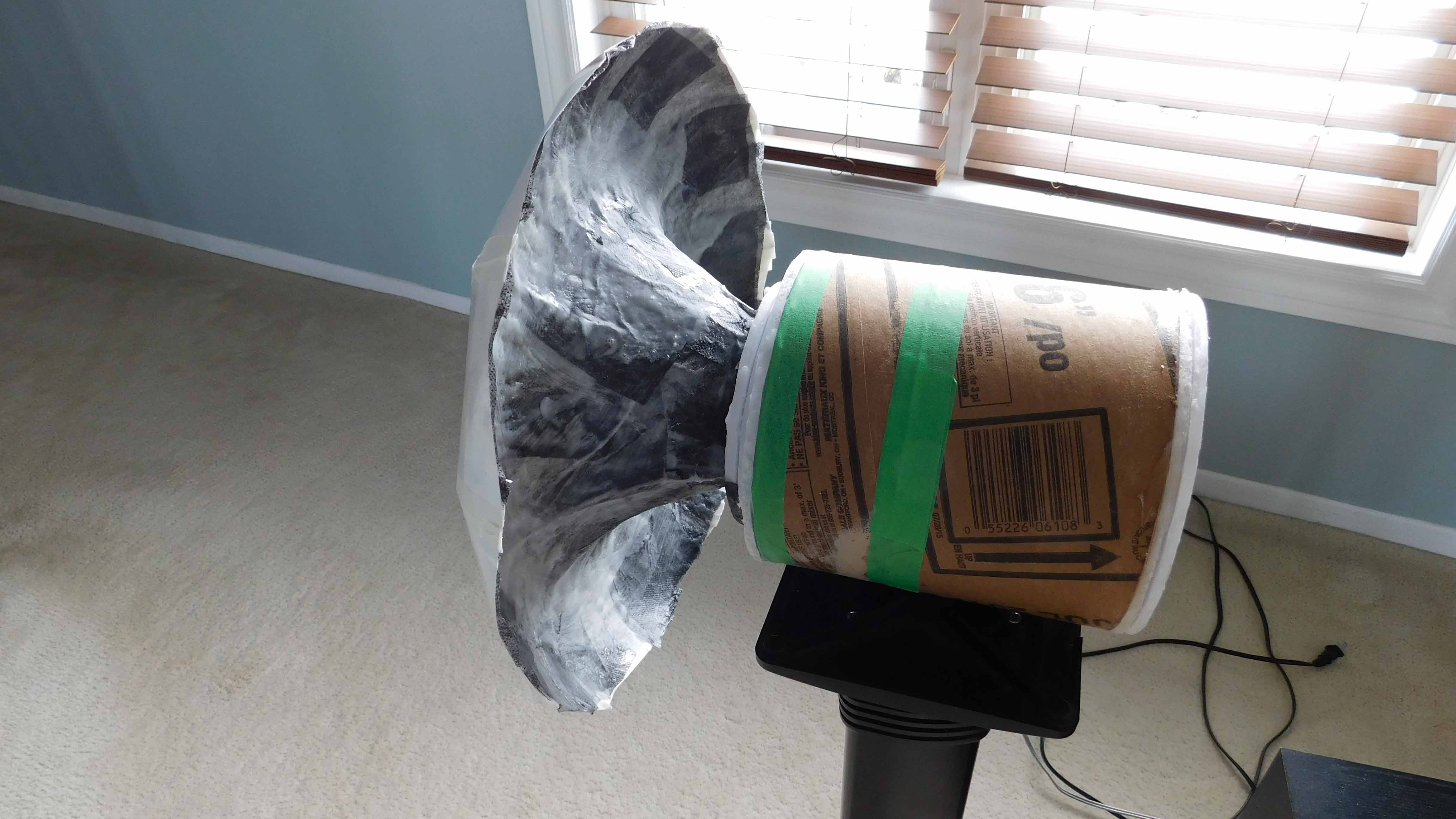

Le Cléac'h Petal Horn

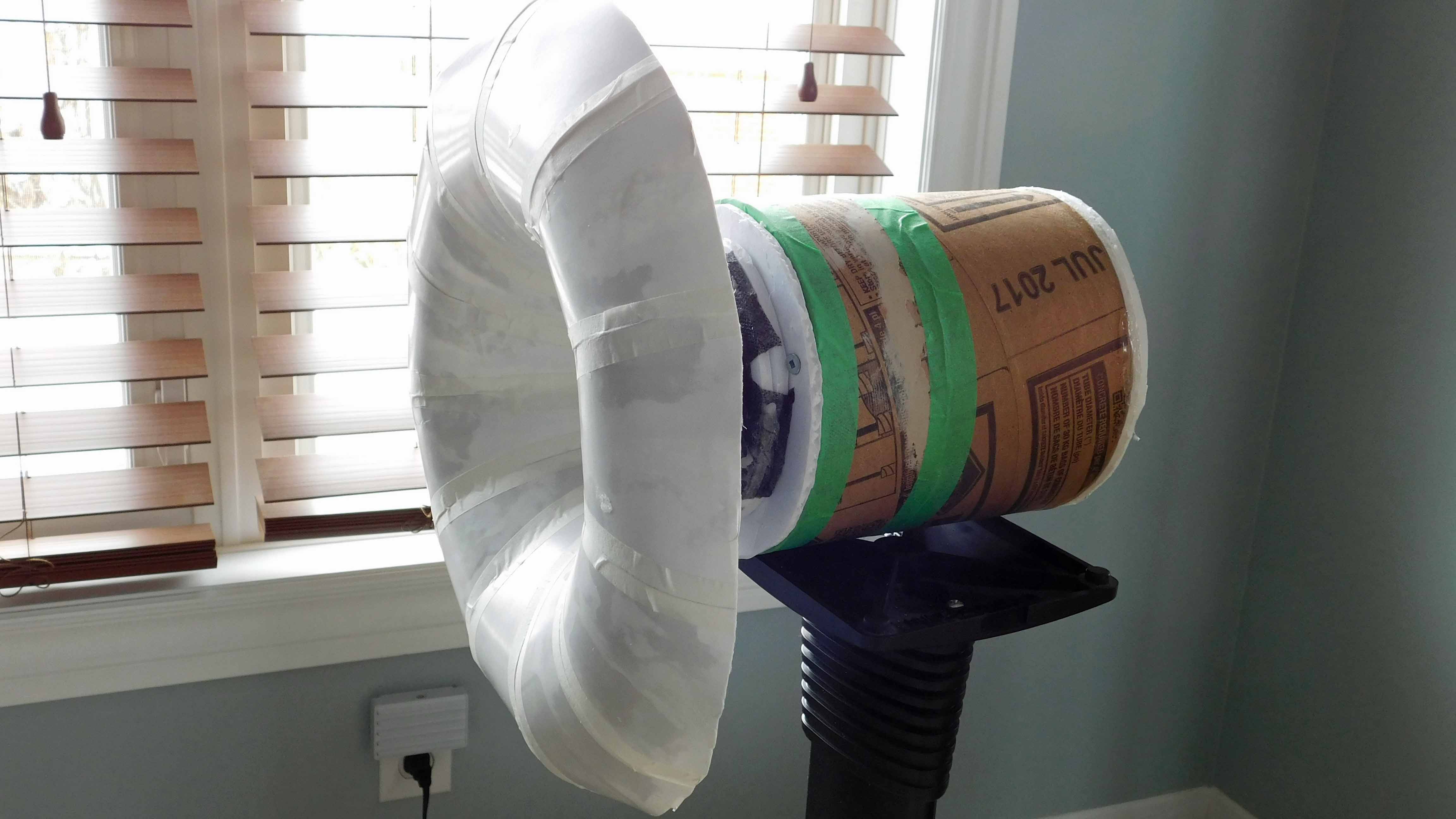

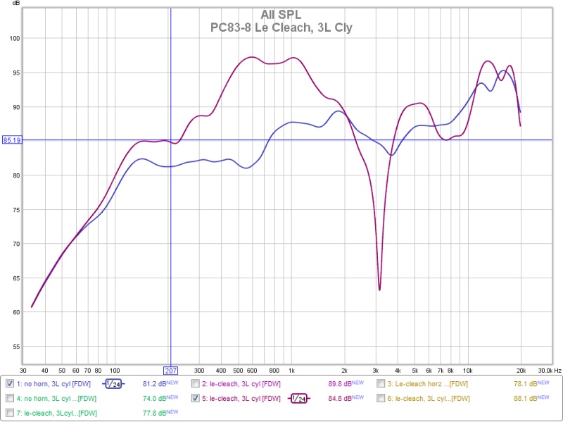

I was inspired by another thread Paper Horn constuction on making a horn from paper. I also discovered that HornResp Paper Horn constuction can generate coordinates for a pedal horn from a design.
This one is made from recycled cardstock and hot glued foamboard flange, but I could also make this from sheet plastic or sheet metal 🙂.
The horn gain (red curve) is in the 150Hz-1.5Khz range but unfortunately I also get a nasty null at 3.14Khz. The blue curve is for just a 3L cylinder without a horn, for comparison.

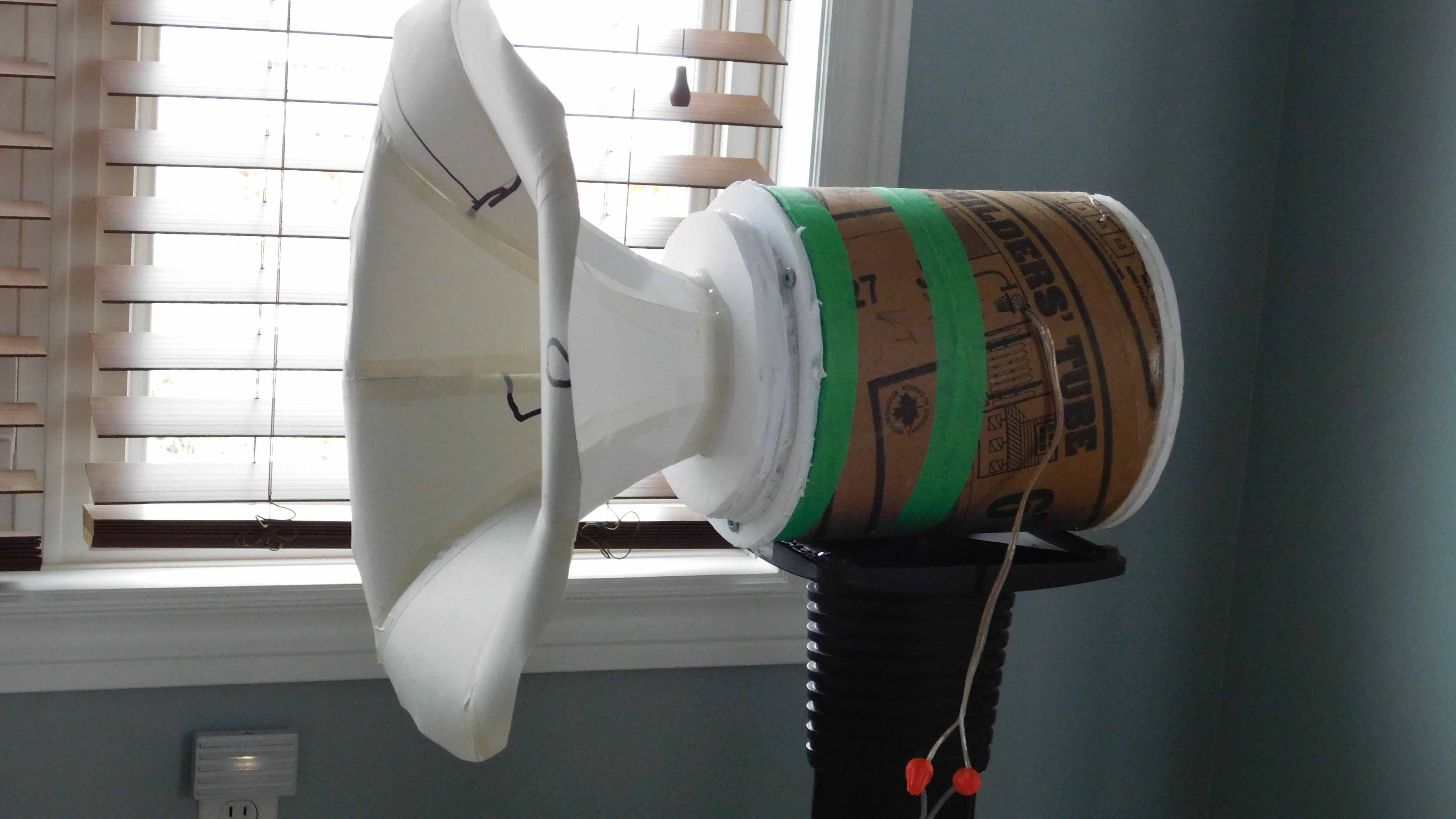

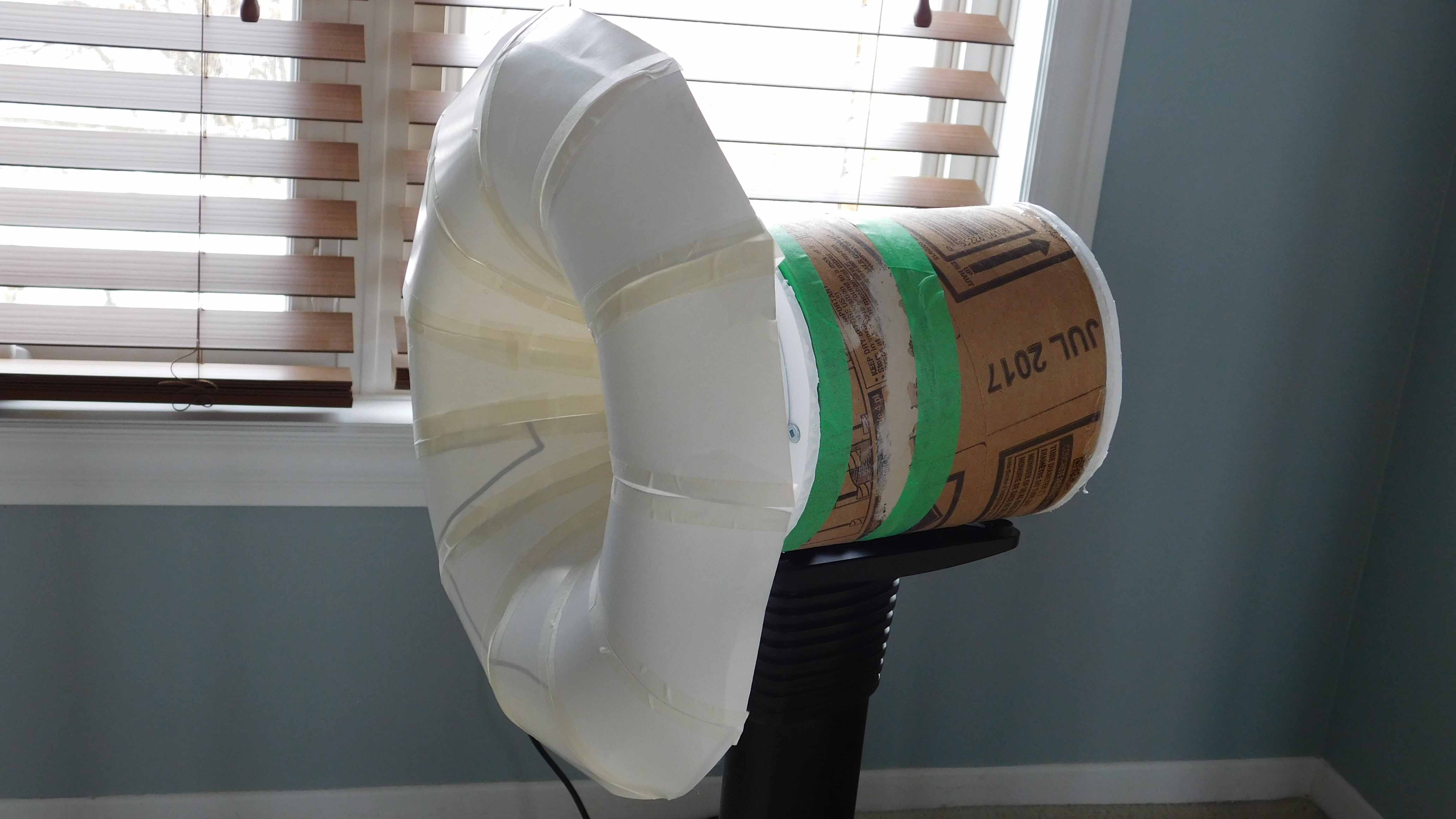

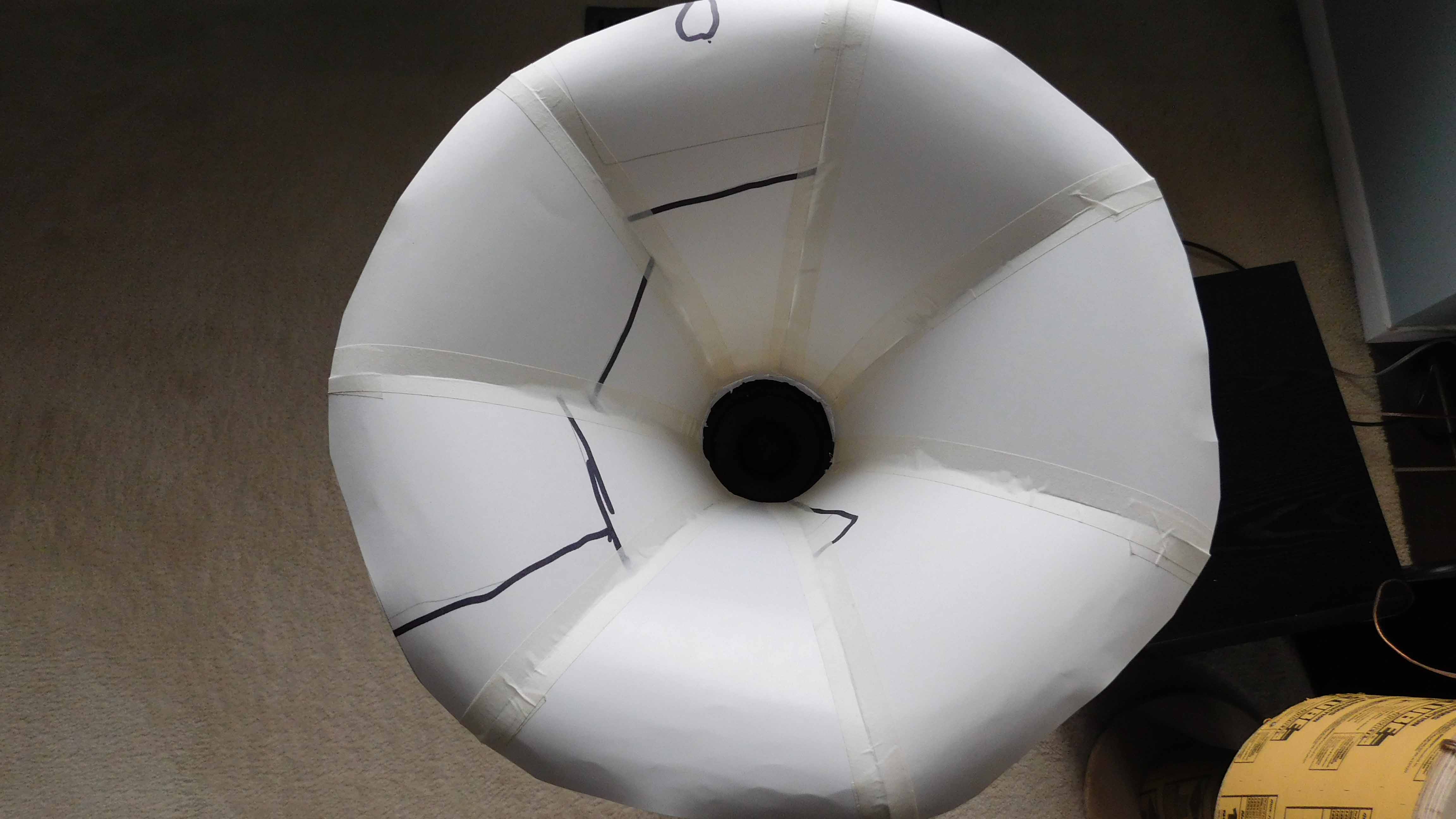

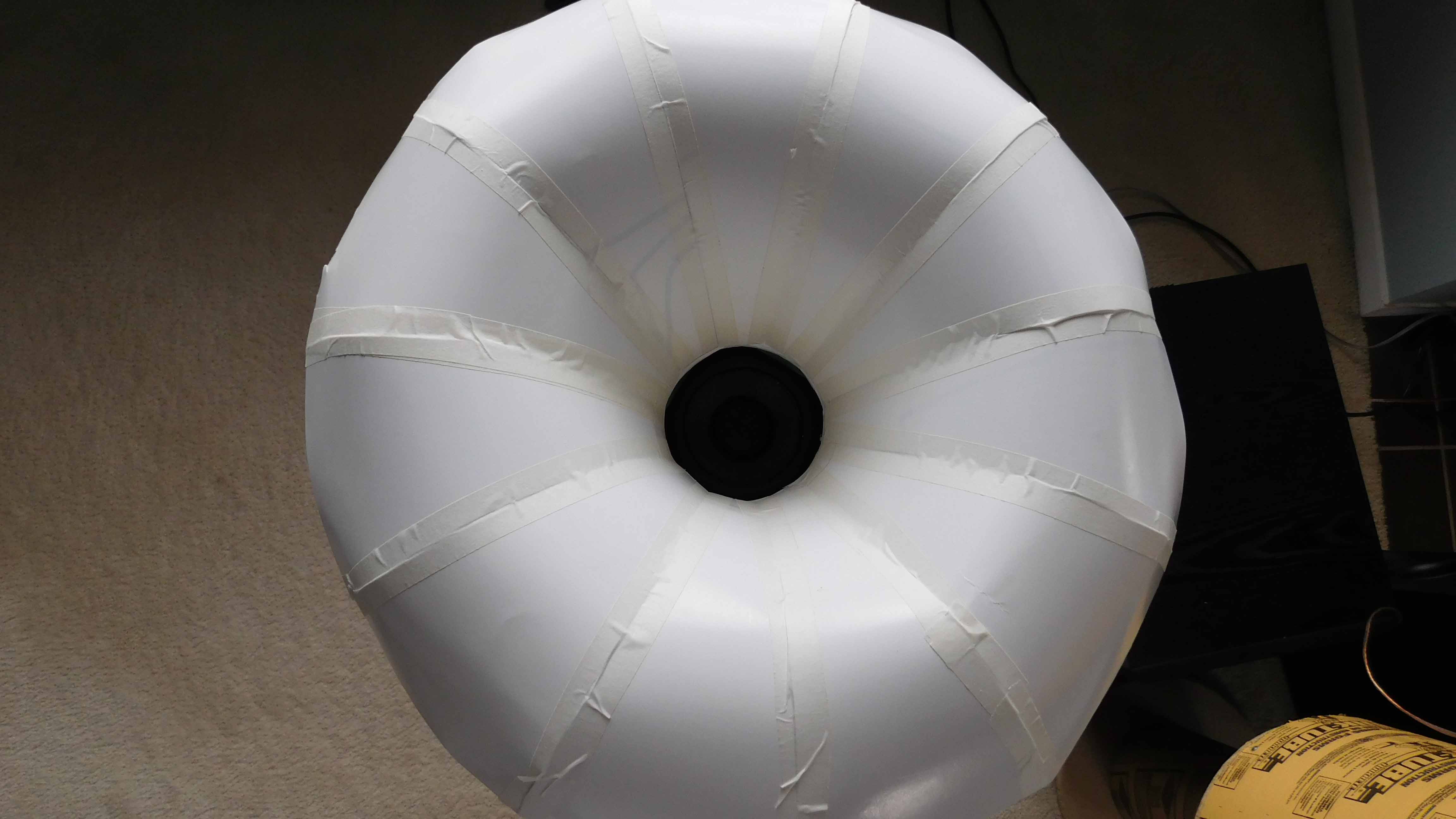

Le Cléac'h Petal Horn - 11 petals + rollover

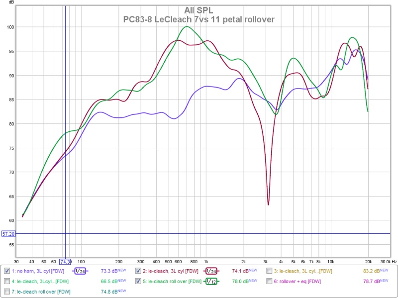

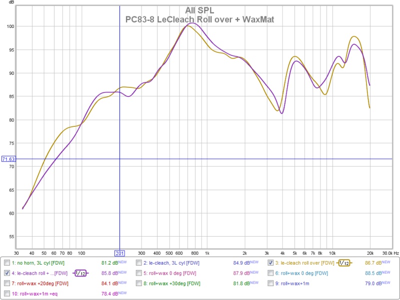

A more elaborate petal horn with the horn rollover. The performance is better, there is still significant horn gain plus some notches but not as bad as the 7-petal design. Not sure if it was more petals or the round over that helped

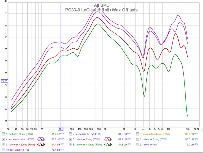

The first graph has no horn, 7 petal horn, and 11 petal horn. The second graph has by EQ attempt compared to the no horn setup.
The notch appears under all angles but a tad shifted in frequency. And there's a dip at the double and triple frequency too but both at different frequencies. That's a sign your paper-horn resonates. Try to stiffen it up with wallpaper-glue and newspaper parts, you can also use wood glue mixed with a bit water.
Thanks @ICG, sharp eye!, that makes sense. I'll try a few experiments to test that idea.
I was thinking of adding quick outer hot glue "ribs" to stiffen the wall structure. I should see the resonance points shift if its a wall resonance.
Are these all on-axis recordings?
It could be none of the above - maybe just be a wee difference in mic placement. I think most axisymmetric horns give a notch when you measure exactly on axis, but not elsewhere. Small differences in placement matter.
When I experimented, if I moved the mic a little off axis, the notch got smaller. If I intentionally introduced some asymmetry in the throat, the notch got smaller.
...so try measuring 30 degrees off, and see if it goes away completely.

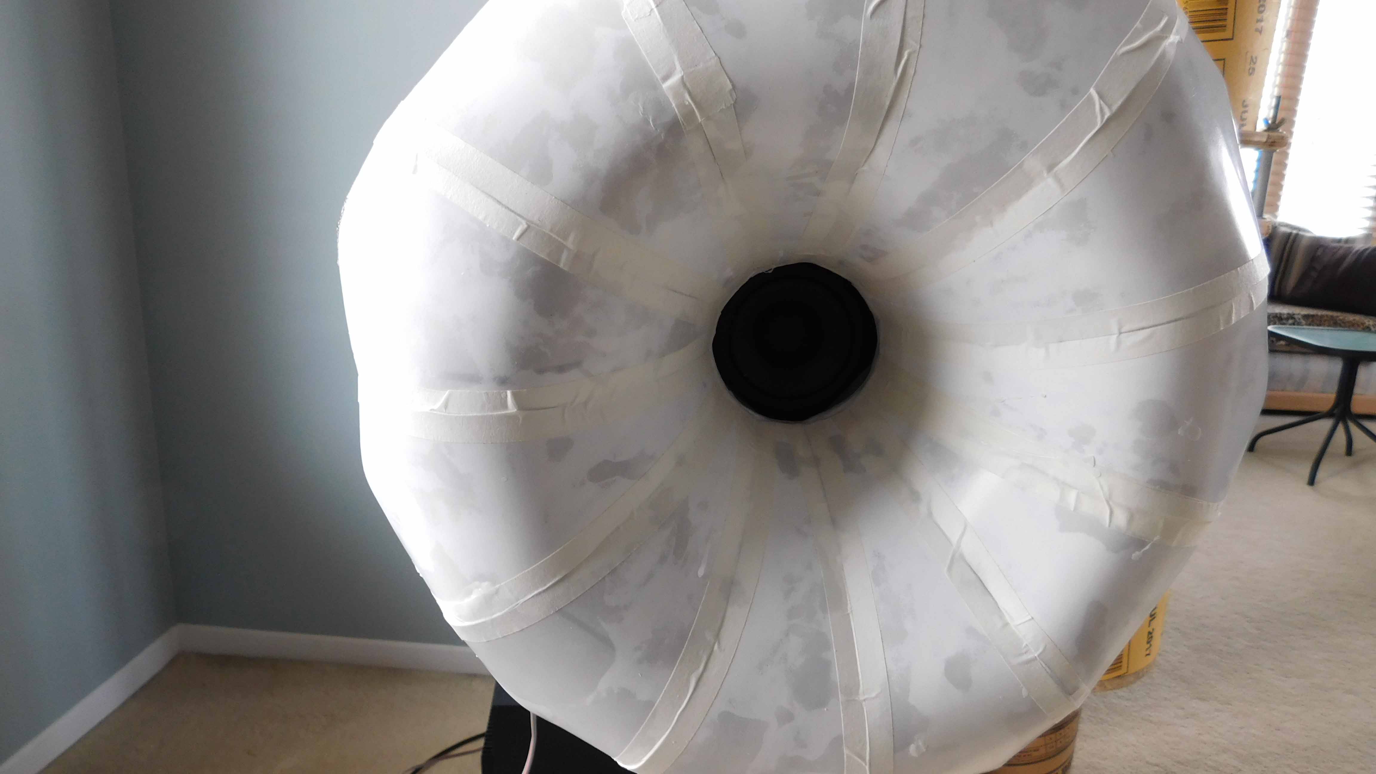

Le Cléac'h petal horn - reinforced this time
So I was thinking about how to reinforce the walls of the horn to determine if they were resonating and causing nulls.
Horn#1 was ruined with previous attempts, so avoid anything with water. Horn#2 was reinforced using paint brushed on hot paraffin wax, with cheap (dollar store) gardening fabric mat. The fabric (plastic?, recylced nylon??) has 1mm grid holes and allows the paraffin to grab and pass through. I get a significantly stiffer walled horn. I just can't go to close to the sun 🙂 Pics below, note the black mat on the back of the horn.
Sadly, there was barely any change in performance, but still worth trying. It's just a bad design combination. It also makes little difference if I go off axis, I get the same dips, for the same reasons.

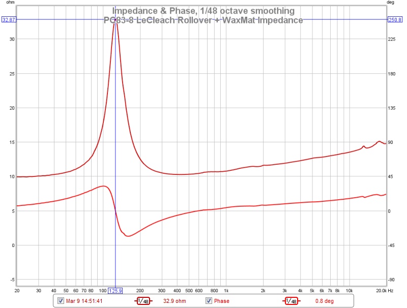

The rear chamber is 75% filled with fiberglass, the measurement is at Dayton PC83-8 (3") test results so they can be compared. I added a new impedance measurement for this system below.

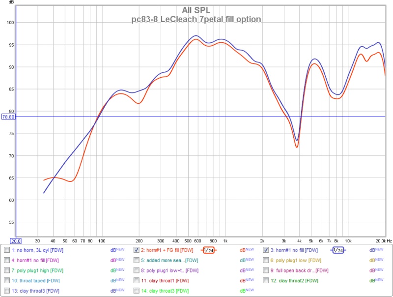

investigation of Le Cléac'h 7-petal nulls
My 7-petal horn#1 seems to have recovered overnight, most of the wrinkles are gone (pre wrinkle pic shown) but the nasty nulls are still there. Time to find out why.

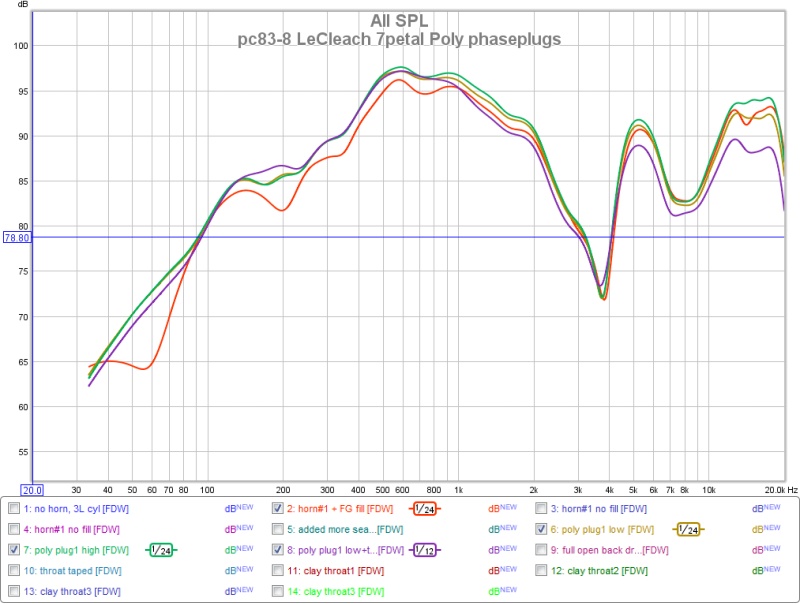

First I tried to see if more or less fibreglass fill was the issue (graph#1). It made very little difference.

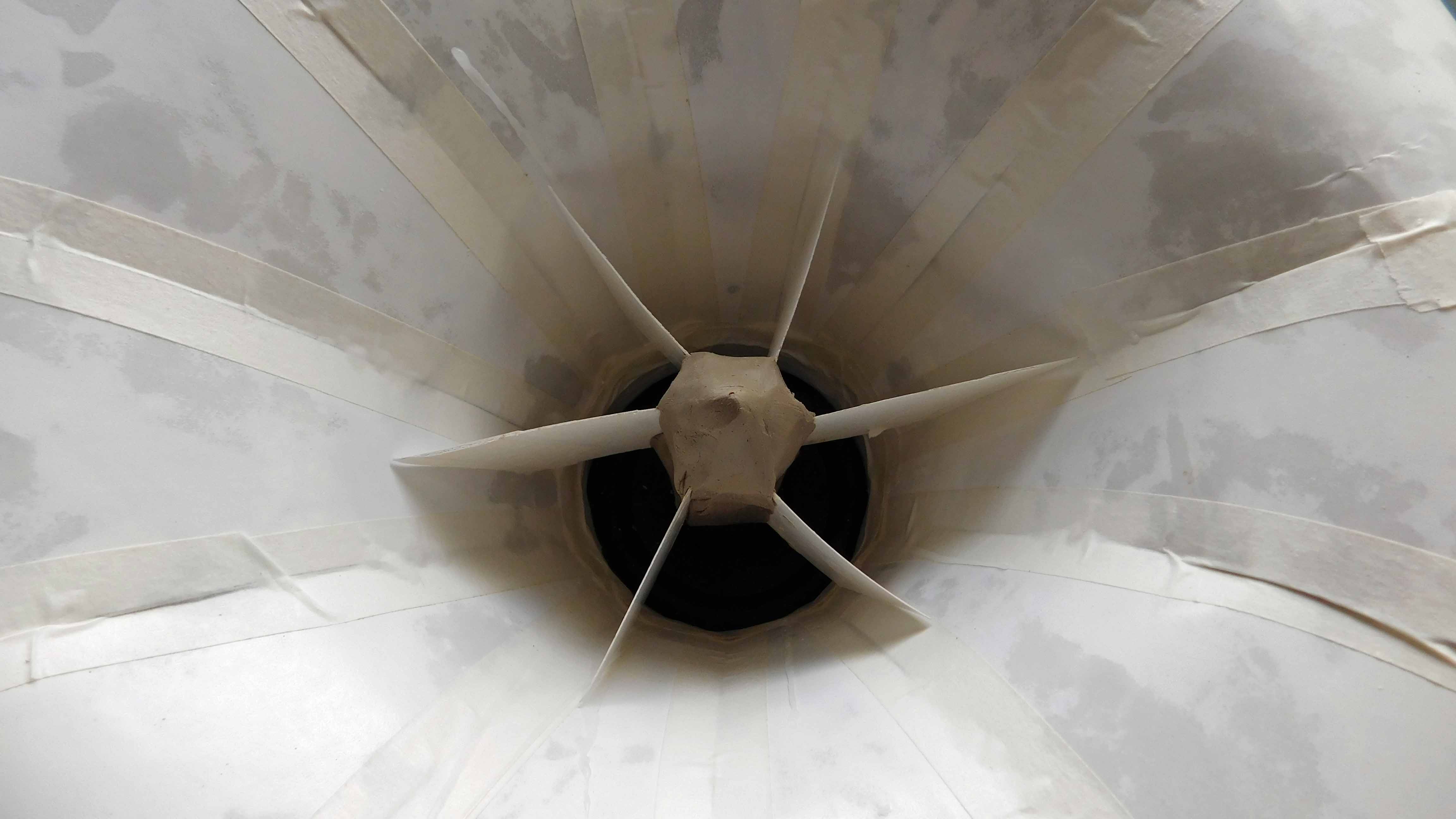

Next, I tried to add a polyester fill "phase plug" to the horn to see if the problem was within the horn itself and it made very little difference (graph#2).

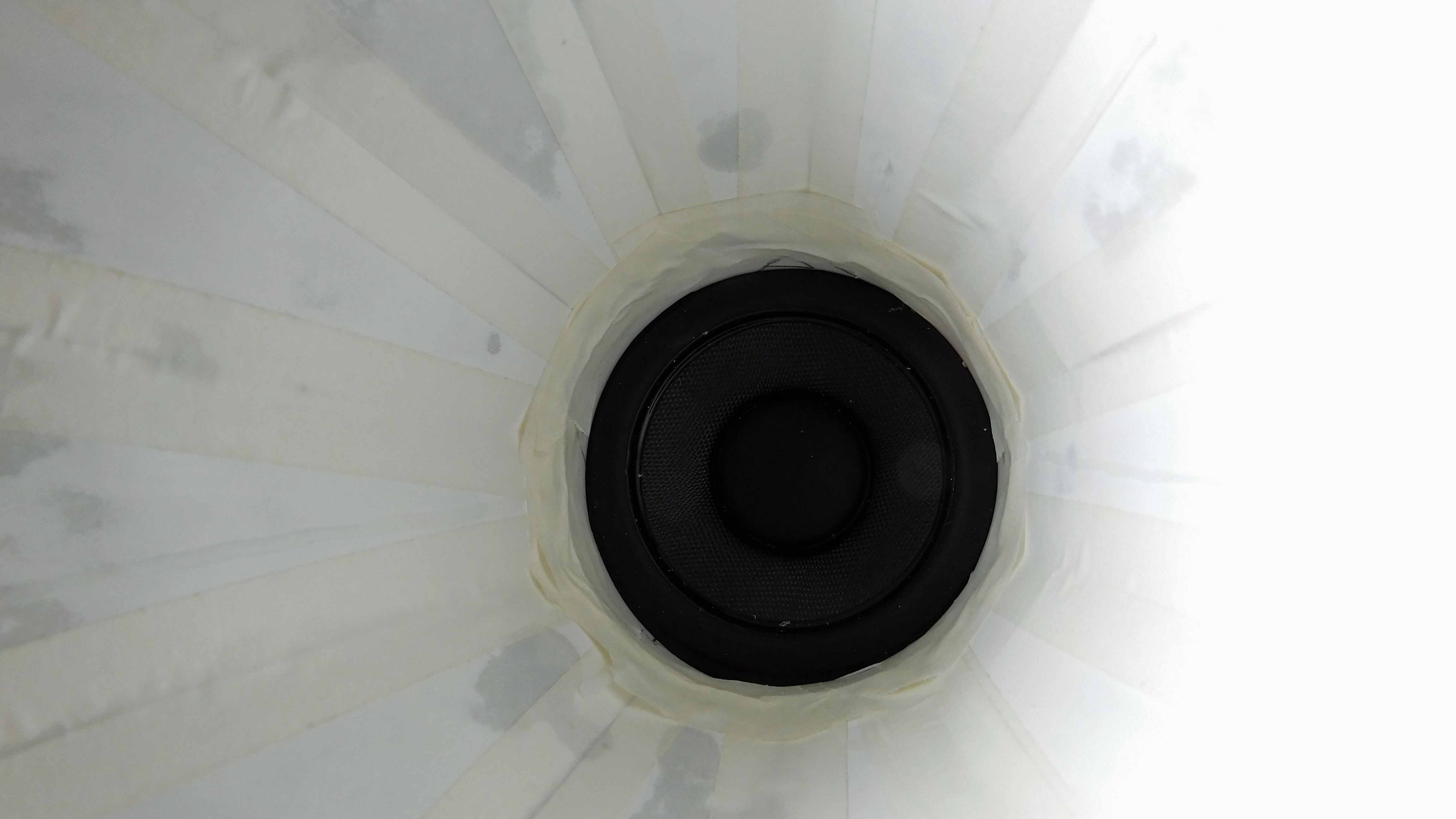

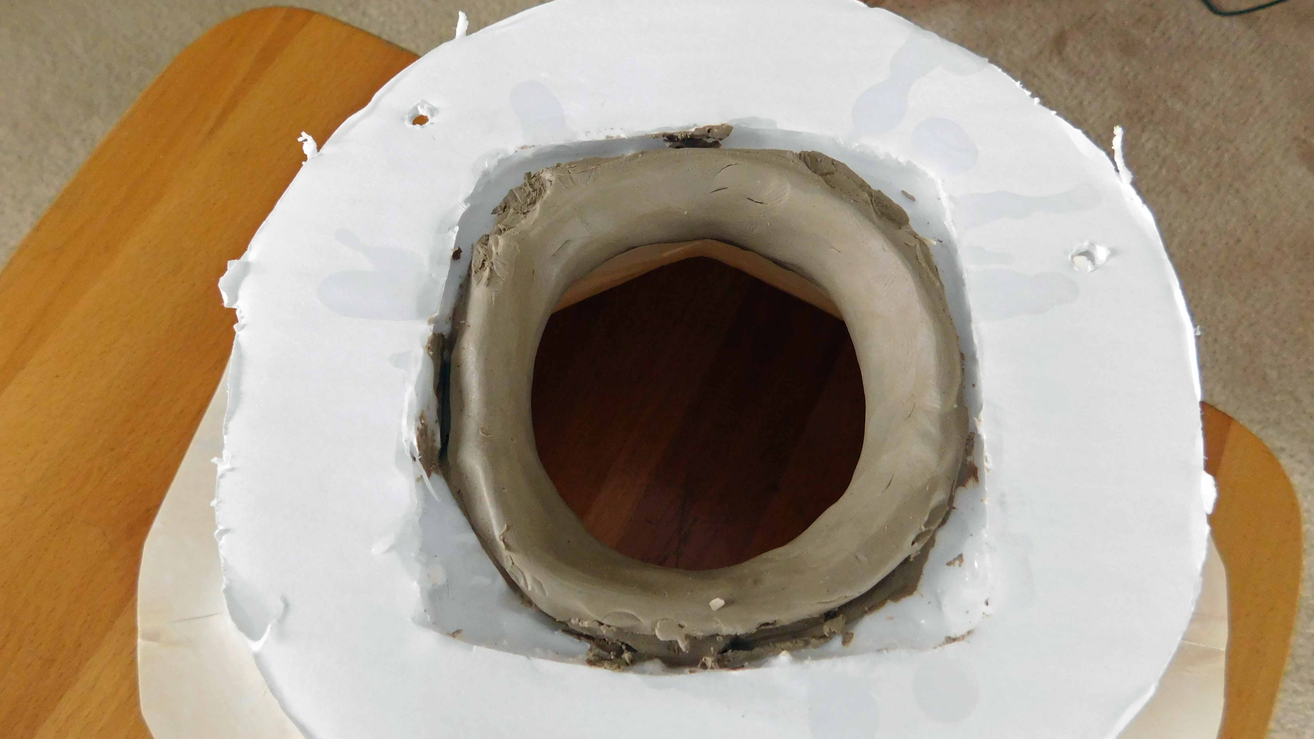

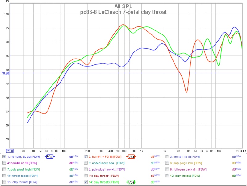

Next, I tried to modify the throat adapter (pics #2, #3). Original adapter is a short cylinder area=31cm^2 and volume=45cm^3. Adapters are difficult for this as the driver frame is a pincushion and the driver can move xmax=2mm. A few trials with modelling clay (pic#3) and we have a solution (graph#3 green curve). The null at 3Khz is gone. There some more work to do, but it looks like the problem is at the adapter.

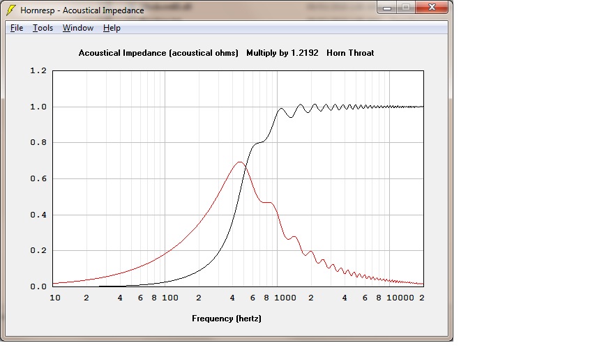

I was thinking some more about the 2 nulls and the LF dropoff in the response curve, and what's causing them.
The LF dropoff starting at ~700Hz is from the basic horn design which has a LF cutoff point. The horn's acoustic impedance (Graph #1) drops as shown in the hornresp graph and it becomes less efficient, and output drops <700Hz. The FR returns to the bare driver response, with no horn gain. Graph #2 blue line.

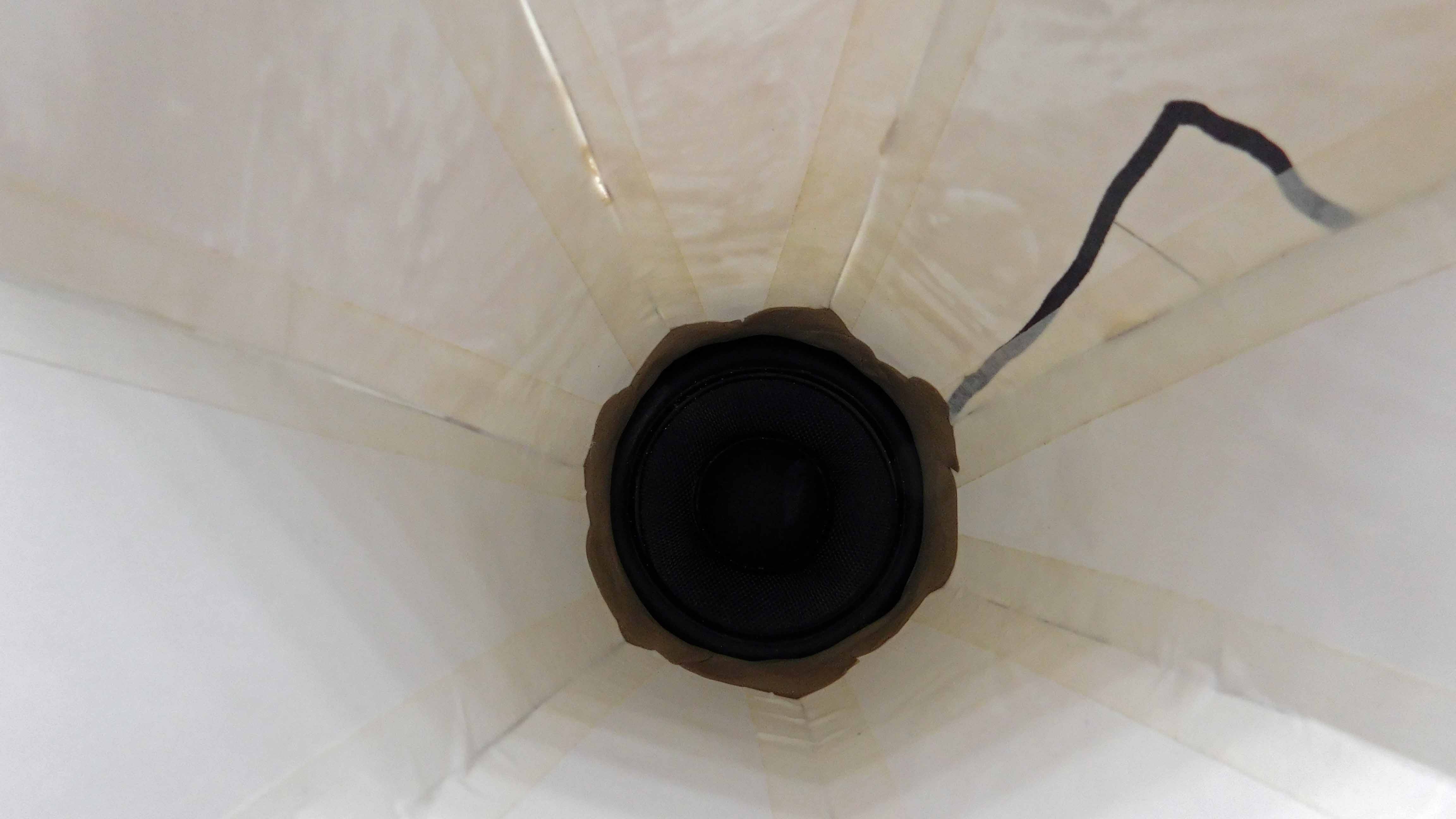

The first FR dip @3.6KHz was found to be the throat chamber (pic#2) which was removed and replaced with a coupling cylinder barely larger that the speaker surround. Graph #2 green line.
The second FR dip@8.8Khz was found to be a phase problem in the horn. This may be an issue with using a cone driver I'm not entirely sure, as I don't have a spare compression driver to compare it to. Adding a makeshift phase plug (pic#3) to the horn eliminated it. I used modelling clay and tried a few shapes until the null was gone. Graph #2 red line. It now has a "saddle" FR shape (>700Hz) that I've seen before in a circular horn.

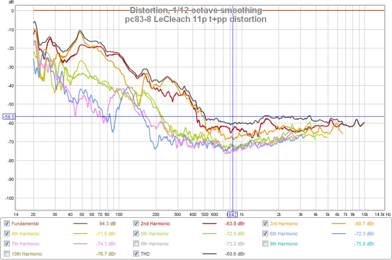

An interesting side effect is the distortion was lower for freq >500Hz. It looks like it improved, from -50db to -56db THD. The sensitivity went up and the distortion went down. Graph #3.
Well, you never said anything about having a front chamber. The front chamber basically acts as a band pass and like all filters and almost all cavities it ofcourse also got a resonance.

The front chamber was a construction "accident" when I realized the "hat" I put over the pin cushion driver frame was acting like a chamber.
