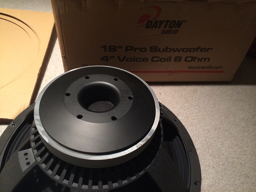

Fixed it for you. 😉The Dayton looks more like the RCF basket and motor. They actually model a little better than the TBWs as a good fit for a large horn stack. But what we all are dying to find out is what the power compression is like. If you lose 3dB of output you might as well double the price of the driver - putting the B&C back on top. An inside/outside wound coil seriously increases the heat radiating area.
It says Klippel verified to 11 mm. It my very well do that with a vc overhang of 10.
An inside outside vc will build up heat more than the split wound vc that bc uses. It does increase bl.
The B&C split coil design is both inside out and the outer coil is also split at the top plate to smooth the BL curve.

These are PA drivers, not sub drivers.Shorting rings don't do much in the bottom octave, and it saves money not to use them.
Cheaper to not have them, but then where's the value compared to B&C?

Anyone snag one yet? would be mighttttty interested to see how it compares to even last gens BC (18tbx100).
I can tell you they sim really well. -- going in a flat to 30hz TH 1.5 sheets. (the 1.5 sheets gets TH and place to hold a 12+1 top, so I only have to bolt a single cabinet to the wall to hold bass plus mid/high)
A pair of them will be installed this coming week in a high school commons area, that gets used for dances. Will try to get some measurements in room. Don't have time for a full outdoor measurement on this go round.
