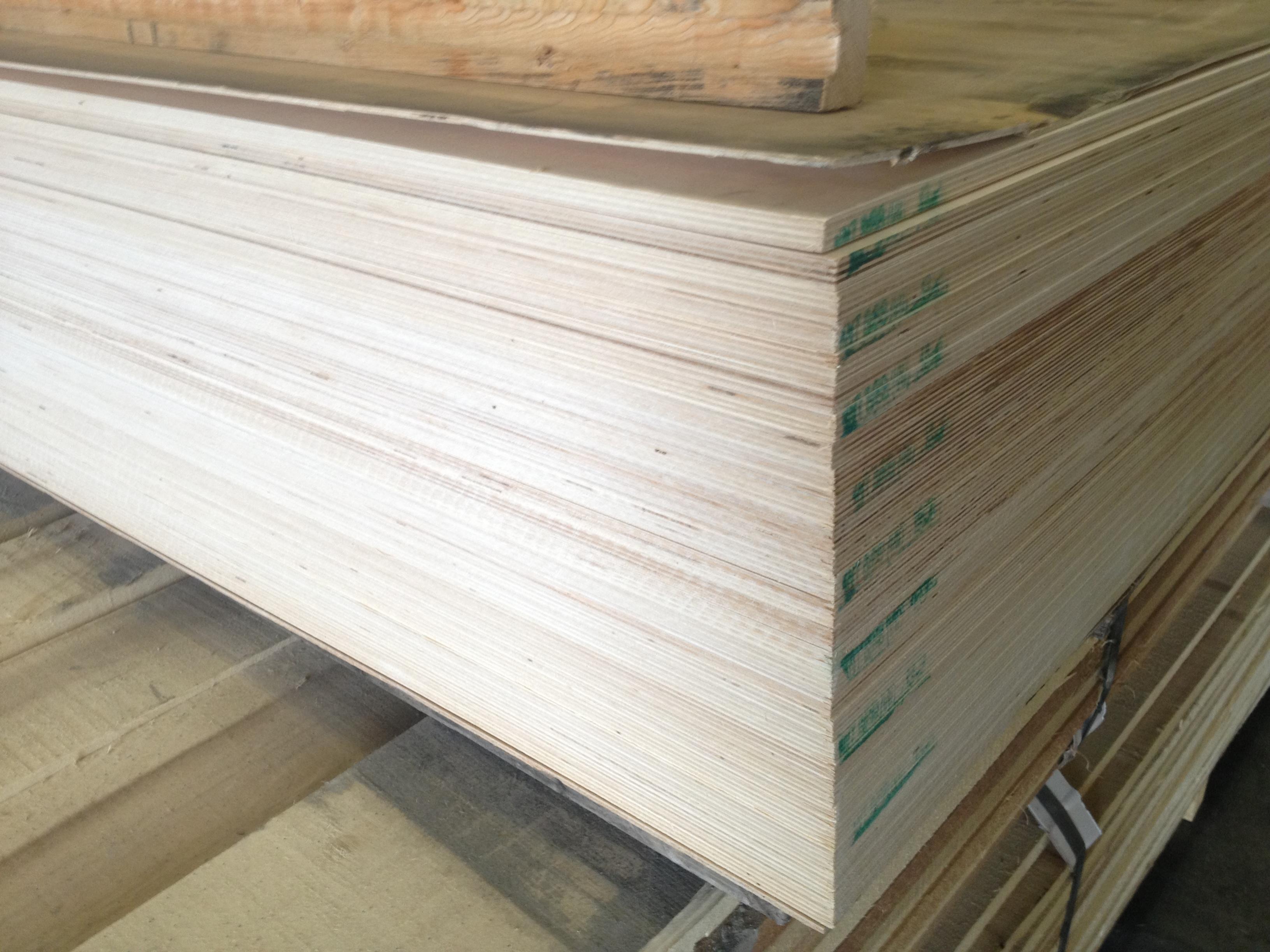

I got 10 sheets (some extras) because there was a little wiggle room in my budget and i expected to pay 40. Im really only buildig 2 subs and 2 tops. But for comparisons sake i'll likely build an "ideal" (vol = vas, tuning = fa) vented enclosure for one of te faitals to see if i actually succeeded in increasing sensitivity. The "mini othorn" should really only use like 1.5 sheets of 5x5 post bracing.
Well i designed it and folded it myself (inspired by jwmbros attempt before te new daytons specs were revised). Initially i was going to try and get jwmbros design from him but dhaa pointed out he used the wrong specs forthe dayton, so i redesigned it for the dayton, the refolded it (made 2 inches wider and adjusted the flare/compression ratio). A forum member here then checked my folded design with an 18 segment akabak script.
