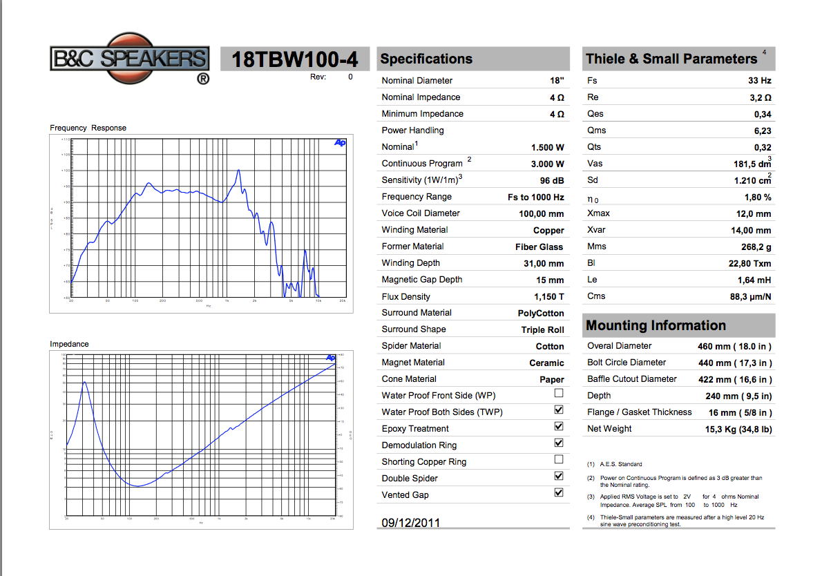

This is a bit OT but does anyone have specs (or any into at all) for the 4 ohm version of the 18tbw100? A few places have it for sale but they list the same specs as the 8 ohm version. I can't even find any mention of the 4 ohm version on B&C's website.

fyiThis is a bit OT but does anyone have specs (or any into at all) for the 4 ohm version of the 18tbw100? A few places have it for sale but they list the same specs as the 8 ohm version. I can't even find any mention of the 4 ohm version on B&C's website.
I'd prefer a 4 ohm driver and of the 4 drivers listed here the tbw is the only one available in 4 ohm. Trying to find an affordable amp that can do 2500 watts might be tricky but a Behringer EP4000 can do it into 4 ohms and it seems to be getting cheaper every year. (And I already have one so the precedent is set.)
fs 33
qes .34

BTW, where did you get this info? I couldn't find it anywhere.
not shure,but i think i found it when weltersys introduced this driver to the forum.Thanks.
in that link i found the 4 ohm specs somewhere.
or maybe i send an email to b&c
Here it is again, there are some minor differences to the specs you posted.not shure,but i think i found it when weltersys introduced this driver to the forum.
Art
