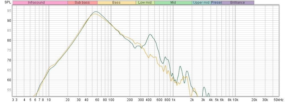

Beginner speaker builder here looking for some help.
My current goals is to build a decent 2-way speaker for my workshop, one that fits the limited space available. The speaker will be almost against the back wall.
The woofer is a new Dayton Audio RS180P-8.
Enclosure: already built so I could have some woodworking exercise. Ported. Internal net volume is 11,2l. Box is tuned to 49Hz. I did an impedance sweep (DATS v3) and the enclosure is pretty much tuned to this frequency. Leaks should be limited, it all fits nicely and is glued together.
Ports: two 1’’ vents, each 7,5’’ long, on the front.
My first problem now is that low frequency response is terrible. Very little low-end bass sound. Even when hooking up the woofer directly and playing frequencies like 60hz, there is definitely missing something.
I recently also built a much smaller cabinet with a DSA135-8 with a rear bass reflex port, and it has a much better low end sound. So it’s not that I’m unrealistically expecting subwoofer-like bass.
One difference I can think of is that in this build I have two plastic bass-reflex tubes, and the DSA135-8 build has a rectangular MDF port, which is more stiff. The plastic tubes in this build aren’t that rigid, I don’t know if that’s important.
So my hope now is that there is a major design flaw with what I built. Thanks for any hints that put me on the right path again. I'm a bit stuck here.

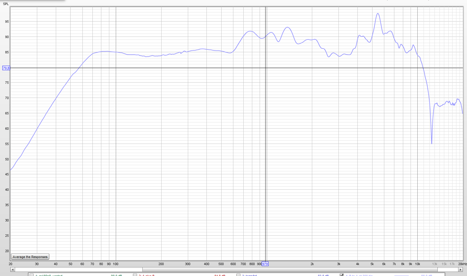

I have included the original measurements, without changing the dB of any measurement nor compensating for baffle step in the nearfield measurements.Can you post the individual measurements for near field port, near field driver and far field driver in .FRD, please? What are the baffle dimensions and mic distance in these instances?
It would be interesting to sim the baffle and make a simulation of output and see where they differ.
Is there any stuffing in the cabs, by the way?
PS. I agree with Mike, the blue far field measurement does show some consistencies with other measurements.
Nearfield woofer is measured as close to the phase plug as possible without the driver touching the microphone. Port is measured just a tiny bit inside the port until where the flaring ends. I used an IR window on the woofer farfield.
Baffle dimensions: 32cm high, 22cm wide. Mic distance is 100cm.
Padding: there is "Sonic Barrier 1/2" Acoustic Damping Foam" on the bottom and on the back panel.

So, I had a look and merged all the files and got pretty muc the same reponse as you. I used VituixCAD to simulate the effect of the baffle on the near field combined measurements then merged it with the far field.
Anyway, now I look at it in the way I would my suggestion is that the effect of severe peaks in the port resonance combined with possible internal reflections is effecting the driver far field output. I went nuts trying to make the perfect cabinet earlier this year (which owing to me forgetting a golden rule I started out with a flawed geometry and had to put fires out as I went) and went through this.

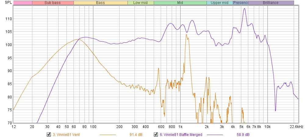

Below is the vent/port and merged far, near and baffle measurements. Clearly there is great tumultuousness in the vent measurement between 500-1500hz. You need to damp these, one way or another. Vents don't just show what they are doing but can be a good window in to what else may be going on inside a cab. ~600hz and ~1200hz peaks/troughs are specifically a problem.
In my project I had the same issue: https://www.diyaudio.com/community/threads/10-cd-horn-2-way.375829/post-6930305
Here are the two measurements of the vent before and after dealing with the port resonance and poor cabinet geometry:
Here are two measurements of the driver and vents merged. I'll let you guess which of the above correlates to which of the below but here's a hint, they're the same colour 🙂
Obviously, your box is too small to get the full extension from this driver but you know that so it hasn't been the focus for me. My advice is to stuff and measure.
Hope this helps and I'm happy to be told I'm wrong 🙂

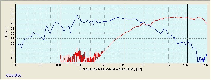

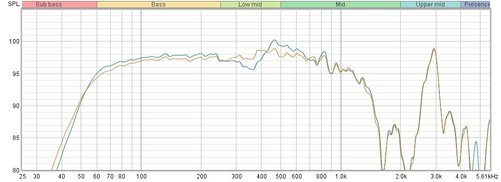

I didn't do a nearfield or a port measurement. However, here's a RS180s-8 with nearfield spliced in.Can you post the individual measurements for near field port, near field driver and far field driver in .FRD, please? What are the baffle dimensions and mic distance in these instances?
The RS180p-8 nearfield will look similar.
Baffle width for RS180P-8 is 8.5". Box volume is 13L. Mic at 1 meter.
Stuffing is 2" construction wool.
Here is the FRD.
I didn't have to use a notch filter for this design. The tweeter is the Morel CAT378.That 5 k might be corrected with a notch filter? Bottom looks funky. Try it in a Voigt design since it's darn good to10 k. Just supplement with the same tweeter. Bass in these designs address resonance and usually have solid and more important natural sounding Michael
This is the Summed Response.
Below 500Hz is no longer "gated". It includes the room reflections.
The big chunk missing at 100-150Hz is a notch caused by a floor reflection.
You'll get this with the speaker 1 meter from the floor.
Measurements are in 4pi.
This design is just to listen to the RS180P-8. I did not apply any BSC.
Even if I did, the music will still lack bass.
I've never done any work with the Voigt design. Don't really know how the bass sounds like.
What I did with this RS180P-8 with the CAT378 is to add in a bandpass subwoofer.
So, basically, the RS180P-8 / CAT378 is a satellite.
Used that way, the mids and highs are pretty good.
If I want to really do a 2-way, I will have to tune the port lower to about 50-55Hz, add some BSC and use active Bass EQ to boost the bass.
The bass should sound tight and with great attack. Haven't done it yet though. Too many projects.

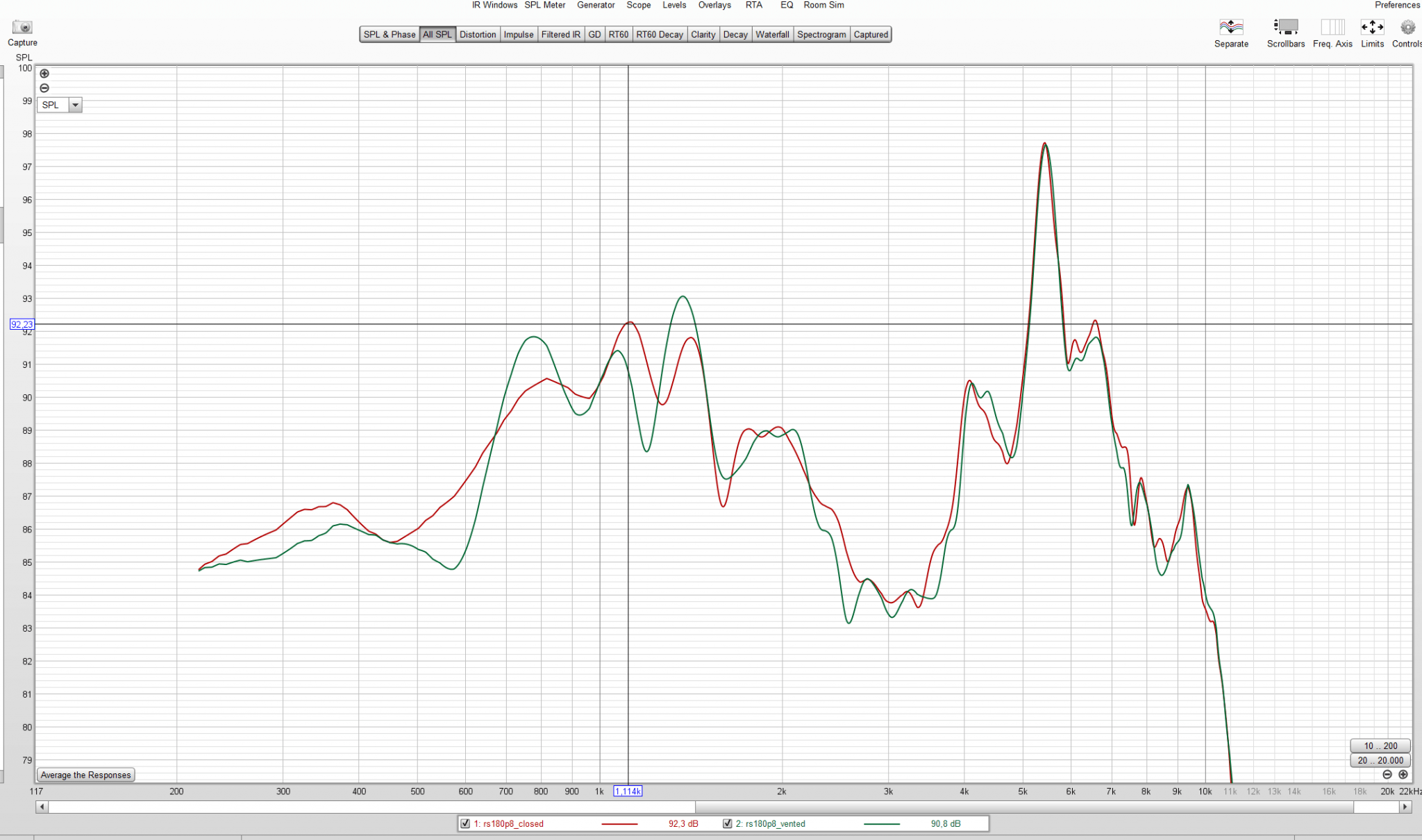

Impressive, you had a similar problem AND solved it 🙂 Very nice, also nice display of skills on your own speakers.
Farfield for my closed box isn't much better than the bass reflex.
- Bass-reflex enclosure, internal: H284 * W184 * D244. Damping on back and bottom.
- Sealed enclosure, internal: H280 * W172 * D100. No damping material.
So height and width are very similar. Would this suggest that the box dimensions are the culprit? There are no port resonances in my sealed enclosure, but still it looks bad.
I'll start with my sealed enclosure, stuff it and see what the measurements tell us.
Stuffing could be the critical factor here. As Mike and I have done, a 2"/50mm lining of insulation material on the back and all sides (excluding back of baffle) will definitely have an impact on response.
Otherwise a heavy stuffing of polyfill will also do something but it can be harder to keep it from interfering with your bass reflex system as it can end up limiting port output.
Stuff-measure-stuff-measure!
