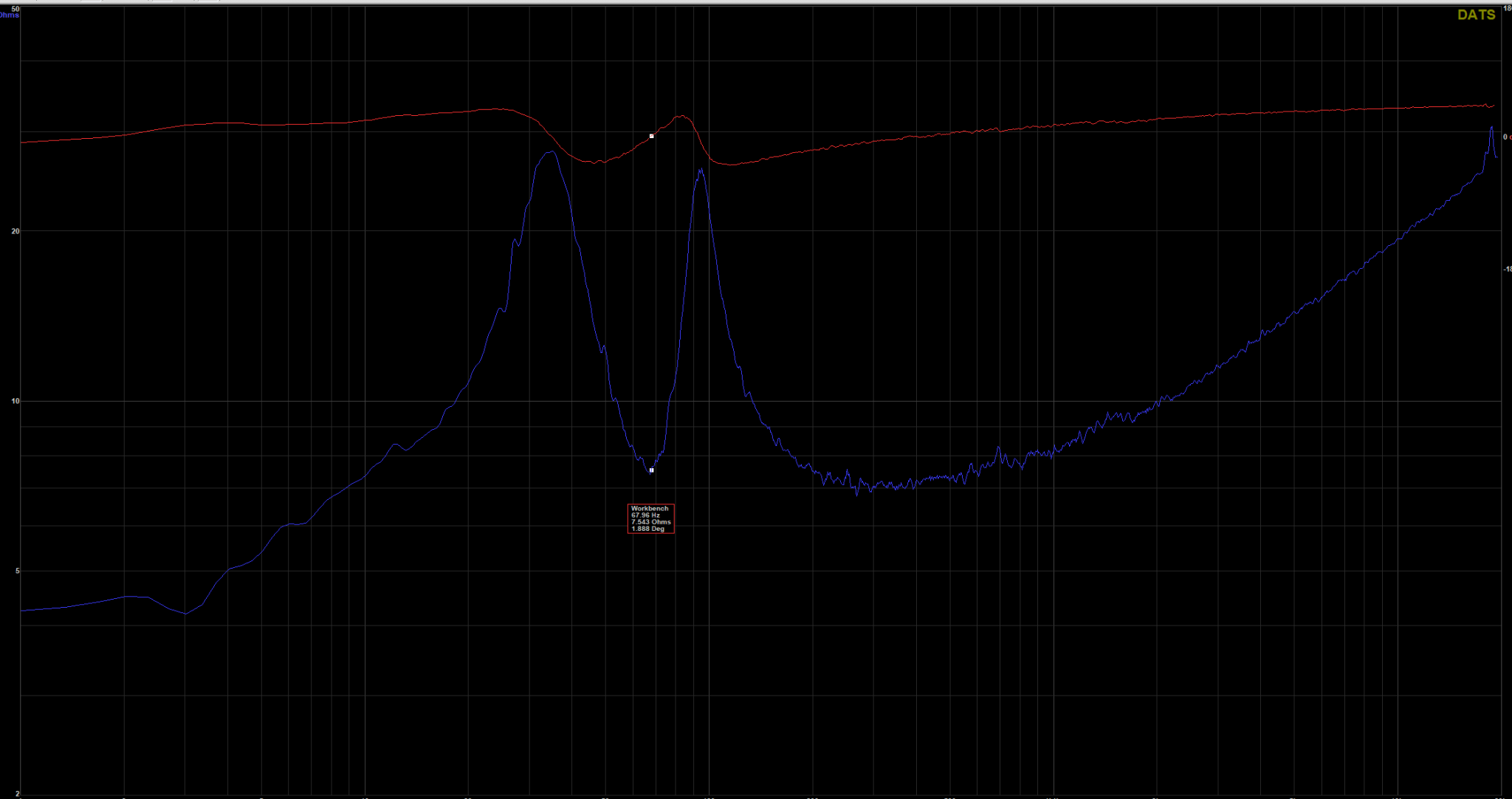

So I put 0.5inch of acoustic foam on all sides but the front of the sealed enclosure. Its a bit better in that the response doesn't look like mountain tops.
Sealed enclosure without damping. 450Hz= 85,5dB. Highest peaks are around 92dB.
Sealed enclosure with damping foam. 450Hz= 85dB. Highest peaks are around 91dB.
I'll try later with the bass-reflex, I'm out of damping material 🙂
