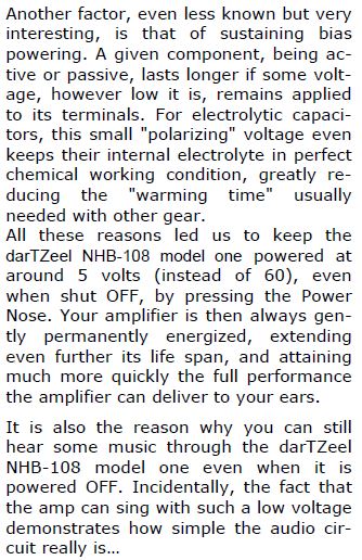

The 5V bias (not 2V sorry) was mentionned in the Dartzeel_nhb-108_model_1_technical_en manual, section 9.1, page 24 of 28. Here an extract of the manual...

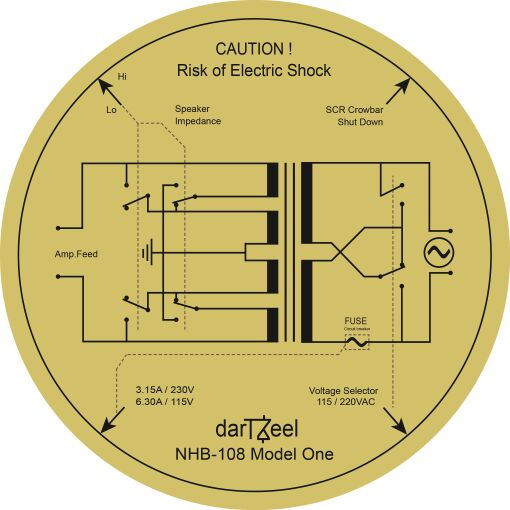

AFAIK crowbar in 108 does the same. The reason for it:
You seem to be in an argumentative mood today 🙂
Despite your reasoning the 108 does not behave the way you want it 😎 Below is a quote from the manual explaining this.
It is a result of both the desire to avoid fuses where they would very audible and also of practicality: whenever there is an overload condition the user has to replace the one and only fuse. The absence of DC rail fuses is also clear from the internal pics.
What other secondaries are relevant at this point? And why it is relevant at the time when you output transistors just went in smoke? There is only one thing left to do at that moment - protect the speakers. And yes, there is enough time to blow even inexpensive fuses not too inexpensive as short current must be limited to protect caps (no more then ripple current for given caps). Also the fuses usually blown in tens to a hundred of milliseconds (decent ones rated for 10A-16A - single digits @100A), IMHO that should have no effect on any properly designed power supply connected to other secondaries on a same transformer if they exist.Shorting the output will lead to a collapse in the magnetic flux that will affect all other secondaries. Will the SCR remain triggered for long enough for the fuses to blow under such conditions?

Sure 🙂 analog_sa is right original amp blows main fuse. I just don't like that idea and dismissed at the start. Blowing rail fuses makes more sense to me and I didn't think it twice as it is more less standard solution for amps with high (>50-55 Volts) rail voltage. Also I as many others was never able to detect fuses in the supply rails. When I have time I will run some tests to if I can do that to my liking. I guess splitting the primary wiring to go to each transformer through separate fuse should help but in this case it needs to be 2 separate soft start circuits one for each transformer after the fuse. Or one common fuse before single soft start selecting that given all the circumstances a bit of pain.

My reasoning was that once the SCR is activated, the PS for the protection will also disappear and this may happen before the fuse has blown, therefore resetting the SCR and rendering the protection ineffective.
Your questions re the main caps discharging are appropriate but do not change the fact that the 108 is designed like that. If you don't like it then do it differently, i was only pointing out how the protection circuit works without speculating - it is all there in the manual.
Obviously there needs to be a resistor limiting the current to the max the caps can take without boiling or melting.

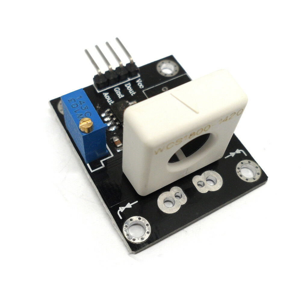

Found this current sensor with analog or digital output, 14U$. Once my amp pcb is completed, I'll order a pair to try. Seem to be the easier/cheaper solution to implement the current sensing. Thanks Paradod4 for the link.
