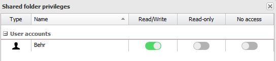

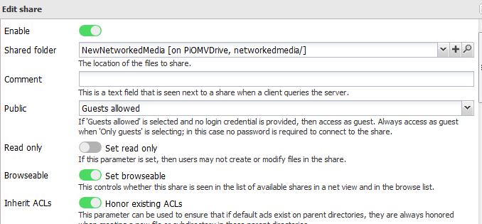

I've attached what I think are two relevant screen shots from my OMV configuration showing the smb share and the share folder privileges.
Any ideas? Thanks again for your time..

Daphile may be more demanding on the nw credentials than windows. Re the link I posted above have you made your OMV network public only?
At your suggestion, I just made a new share, "DaphileShare", that is public/guest only, that points to just my audio files. Still no dice. I didn't want to change the other share to "public only" because I maintain it (add, delete, and rearrange files) as an admin and didn't want to take the chance of messing it up since it's working fine w/ my laptop and Kodi right now. Thanks for the idea, though.. I'll keep pluggin' away.
OK.. this is REALLY embarassing. I looked at a couple screen shots throughout this thread and elsewhere of folks working on getting their NAS attached, and none of them looked like mine; they had options I didn't see. It finally dawned on me that I might be on the wrong setup page.. and that's what it was. I was trying to put in the address of my NAS smb server on Daphile's "General" setup page where you choose internal or external media server. I moved down to the "Storage" setup area, found the screens that I had seen in everyone else's screen shots, filled in the right address, and I'm in business; it's loading and indexing the library as we speak. Thanks for the help.. and I'm sorry for my stupidity.
