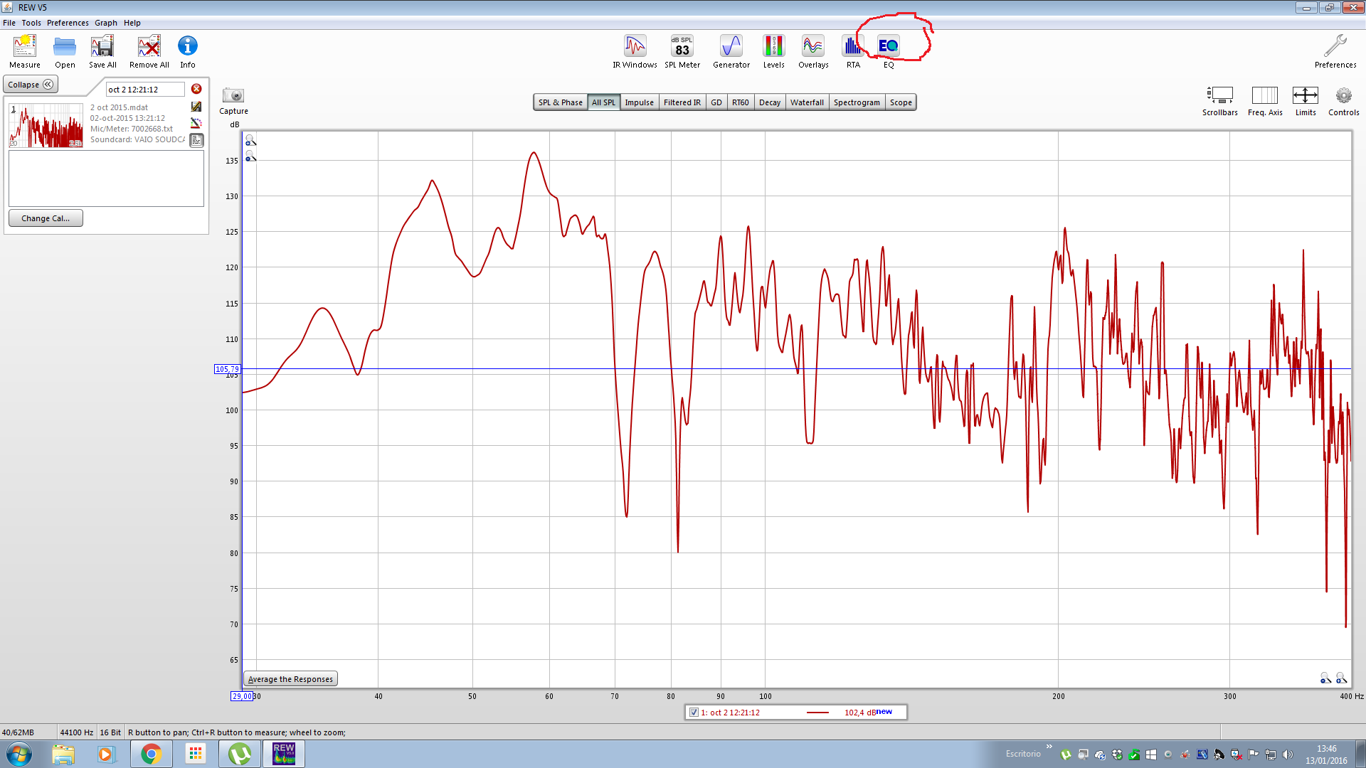

Someone using Brutefir?
Could you kindly tell me the procedure to create the files convolvers or room correction, to be loaded into Brutefir?
On the web I found only guides based on Windows-REW-DRC-JRiver.
Sorry for my bad English

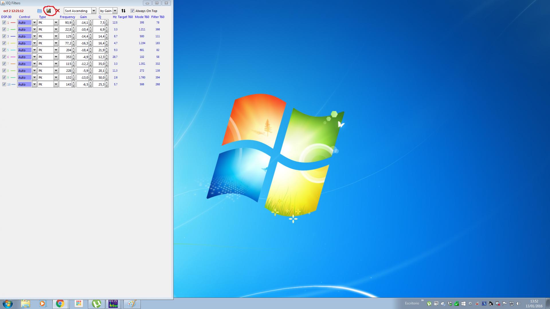

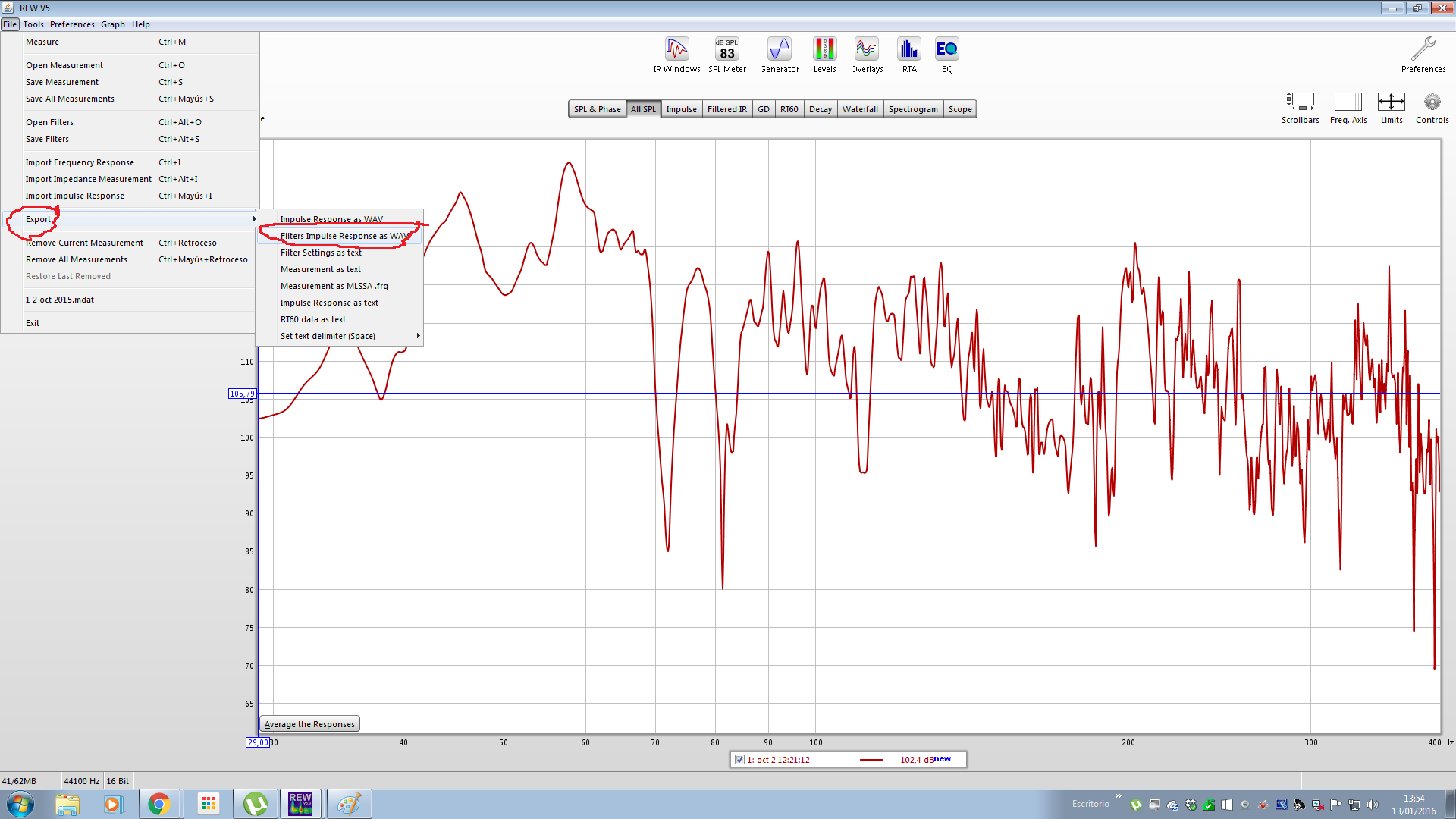

Yes only REW, once the equalization filters done save the filters and export as Filters Impulse Response as Waw see attached pictures, see where do you save the Waw files with the Impulse Response because you have to load this file to Daphile BruteFir option.

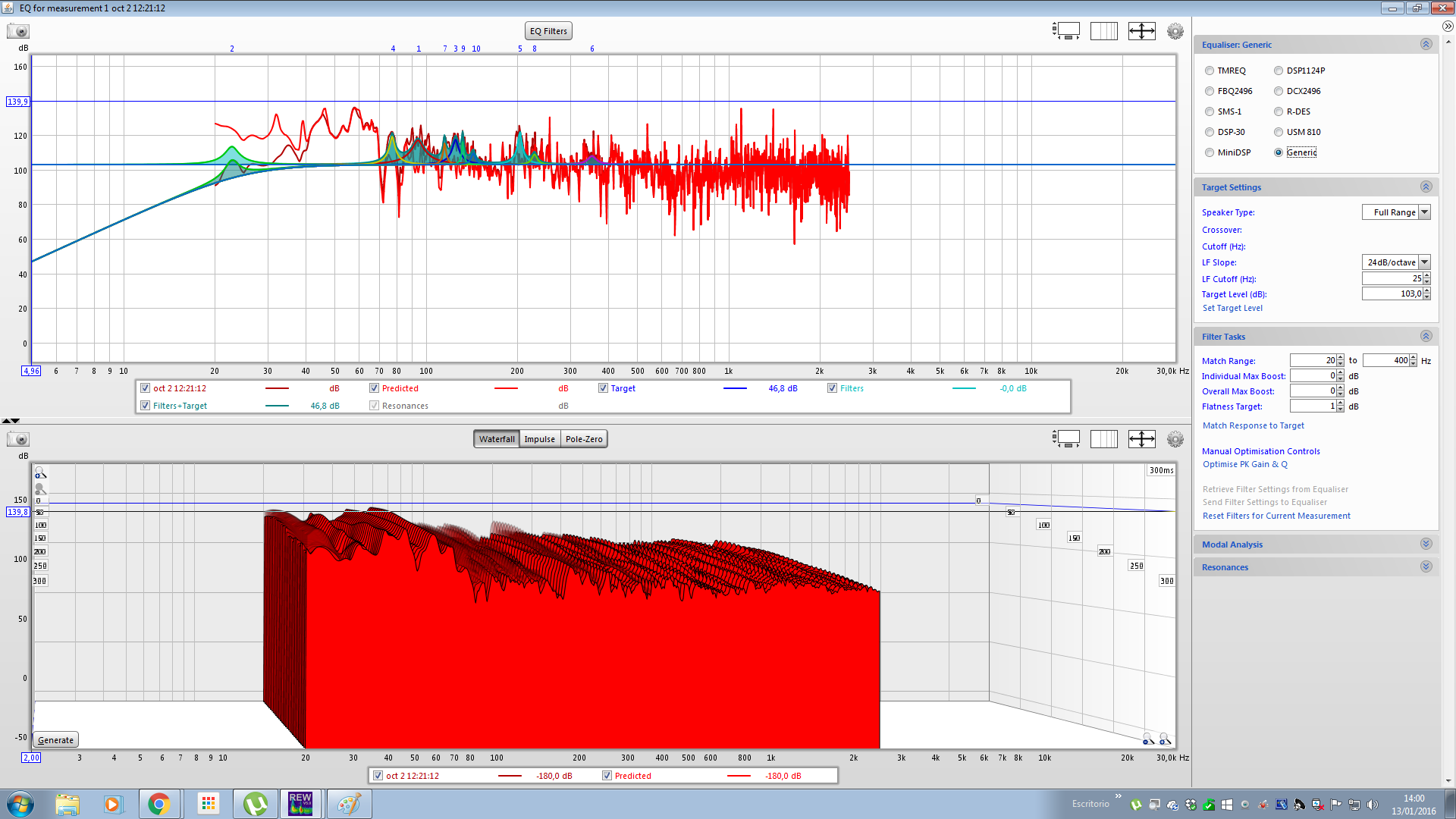

Attached pic of EQ, here you have to select your Equalizer type: for Daphile use "Generic", targets: speaker type etc & tasks: match range etc.
It's important that you do all this things before you assign the EQ filters.

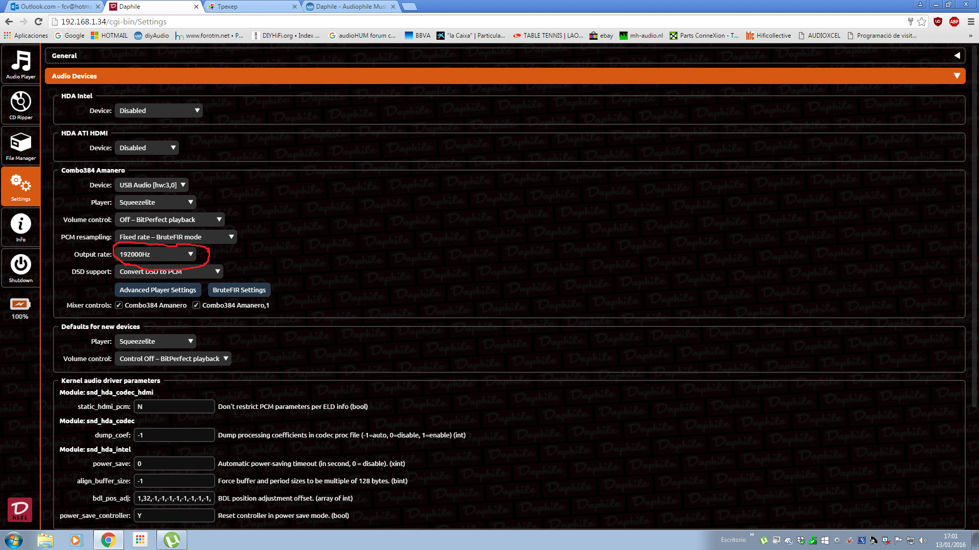

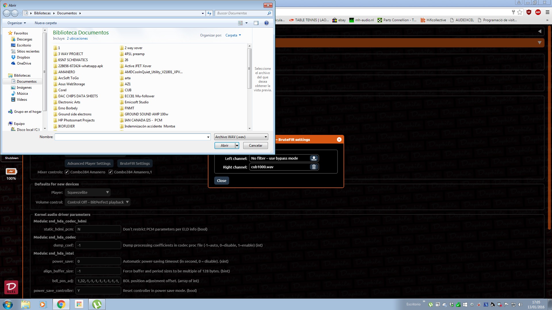

Daphile BruteFir looks for the waw files, doesn't matter the computer if are network connected. When using BruteFir an important thing is to reduce the ouput rate to 192kHz.
