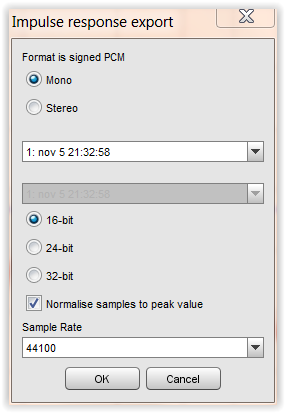

If you make the export as wav file there are some options to choose. Can you advise which choices too make?

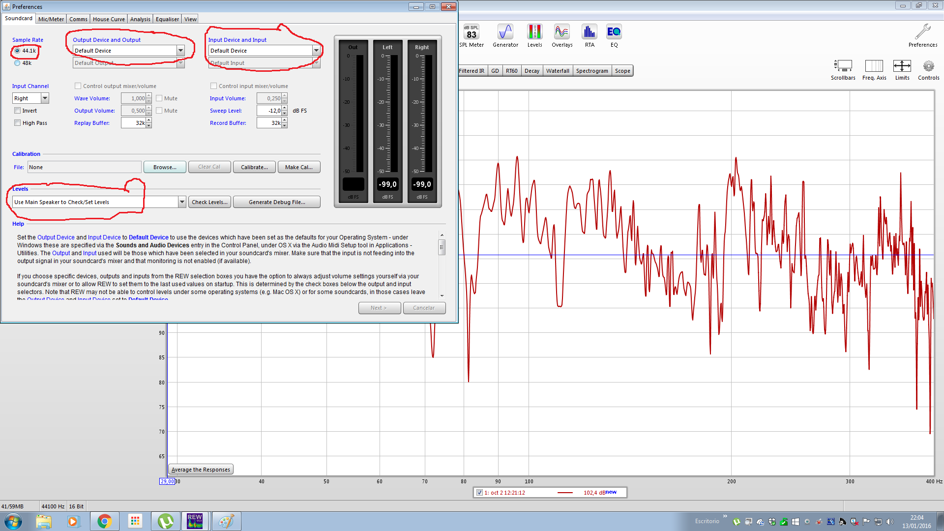

could you kindly post the picture of the settings that you use in REW "Soundcard"?
Thank you
Sample Rate: 44.1K
Levels: Use mains speakers to check/set levels (I don't have subwoofer)
Output device: Look for your soundcard model
Input device: Look for your mic model
You must calibrate your soundcard doing a loop back before making the measurements http://www.roomeqwizard.com/help/help_en-GB/html/calsoundcard.html#top

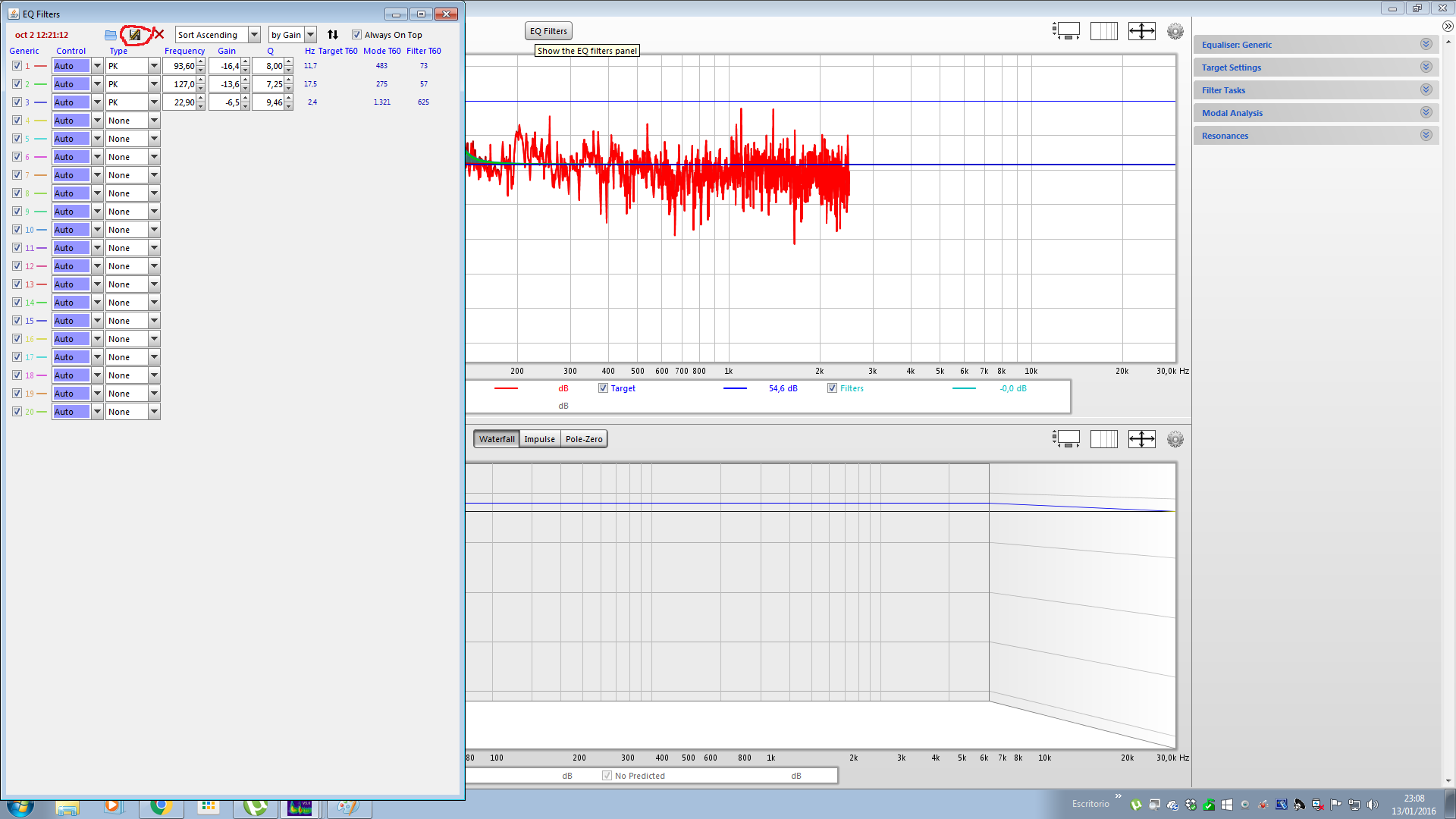

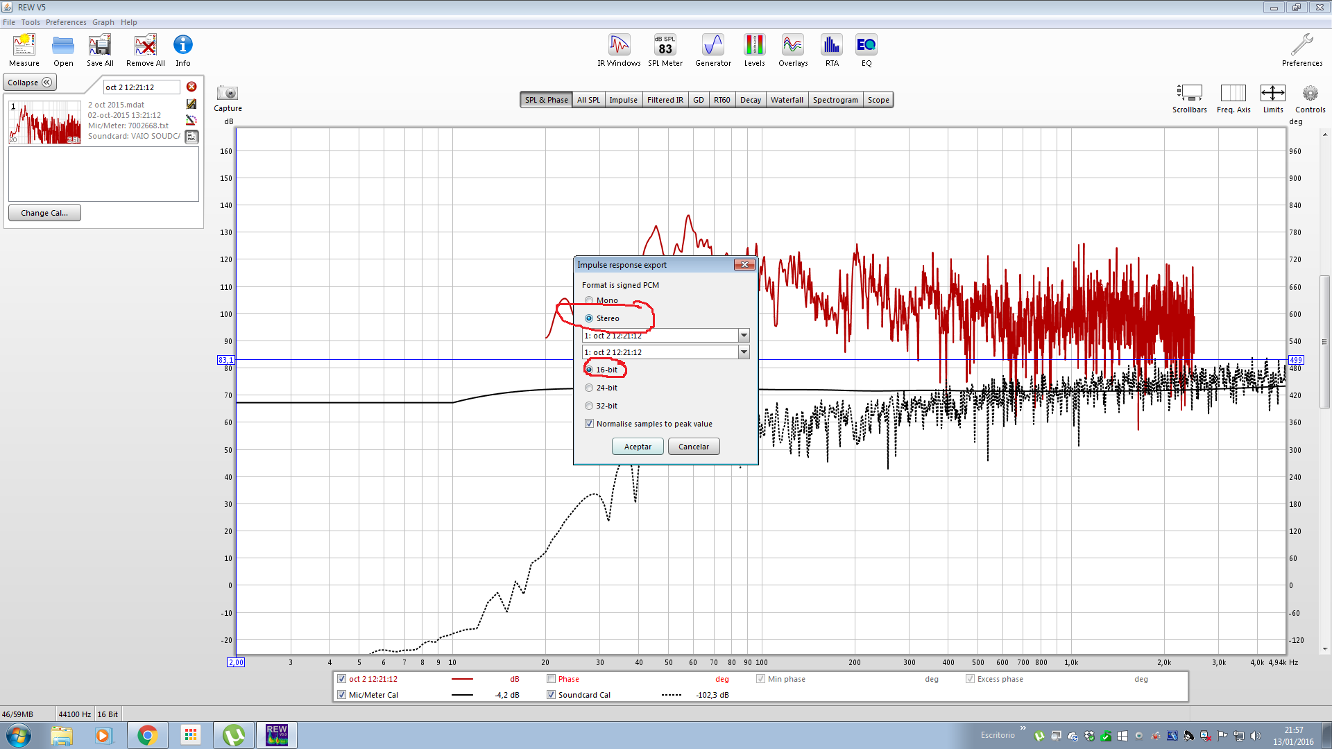

I do have doubts about the REW output i made (i use REW for the first time)
1. I load the initial measurement in REW, adjust frequency scale and so on
2. Then click the EQ button and load my earlier made EQ filter. set it to generic and save it.
3. To make the export file i have to close/minimize the EQ Filters screen and i go to the main REW screen (where my initial measured frequency is displayed) and export a wav file.
4. That i upload to the left and right channel Brutefir in Daphile.
I think i need to do something extra at step 3... (assign it?)
