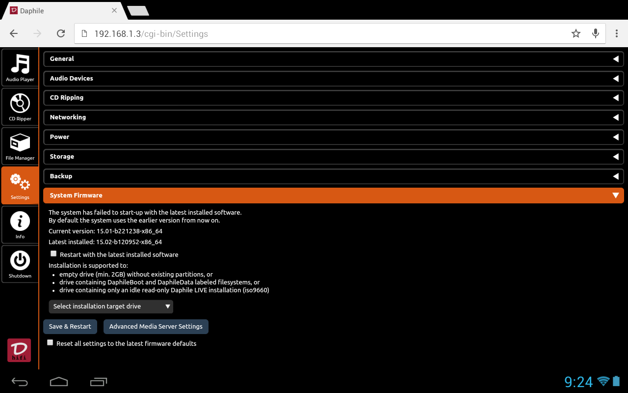

I found an error on my system tonight. Don't know if its related. See attached screenshot.
My system defaulted to a previous image. Odd.😕
Was able to restart it with the latest firmware. Odd.

What is actually "crashing"? The kernel (printing kernel oops), the gui application, or what?
On a system which is installed I get a message 'loading media server',
without possibility to access or change any settings..
When I try new installation from USB after booting message was 'media server has crashed'.. on two different computers..
That was on sunday, yesterday and today everything works perfectly, with same hardware..
Can it be some mistake in the home network, or application in background had some hiden-broken updates..
