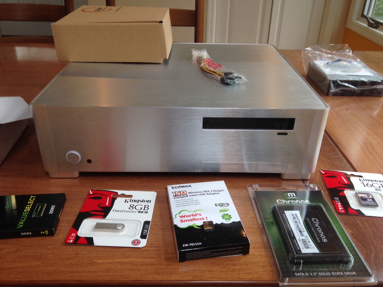

Looks like a great Audio PC case, what brand is it ?
And where did you buy it ?
Toni
Toni
Toni:
At vdi_nenna's suggestion, I went searching for an all-aluminum chassis. I found mine (Wesena model HTPC-e6-silver) at Welcome to PHT.
Scott

Toni:
Scott
Thanks Scott !
