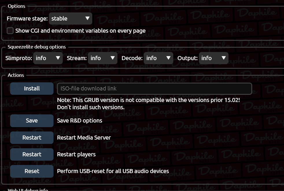

But apparently I have to install the Beta version over my existing to be able to log in to get the file? Can anyone please explain how to do that as the install instructions are not covering it I believe?
https://www.diyaudio.com/community/...le-music-server-player-os.240040/post-6487203
Probably best to do a new install using the beta version.
Available here
http://www.daphile.com/firmware/beta/
Information from the Daphile site FAQ
Available here
for the developement version to add to existing IIRC use http://192.168.0.xxx/cgi-bin/Devel replacing the ip with your Daphile ipQ13. Can I access Daphile with ssh?
A13. Only the beta versions have ssh server and root password enabled.
Root password is "zaq" without quotes. Beta versions are
available here: http://www.daphile.com/firmware/beta/
