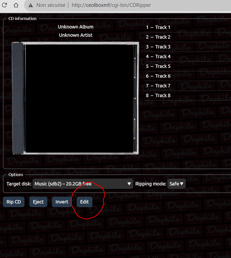

Sorry for quoting this pretty old thread. Just wanted to ask if anyone know if the latest versions of Daphile made any progress on the metadata/tagging question? I'm still on a pretty old version and thought I just ask before trying, e.g if there is any point of upgrading.
The Daphile CD ripping works most of the time, but if the online recognition failed, you could now edit directly the metadata manually,
Personally, I add the artist name and album and use Mp3Tag to complete the metadata.
