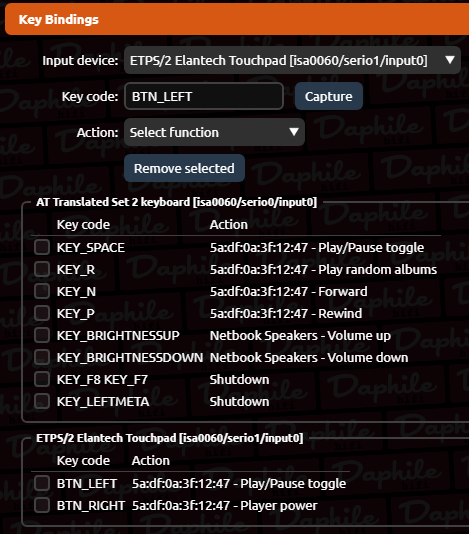

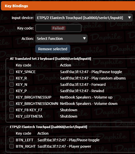

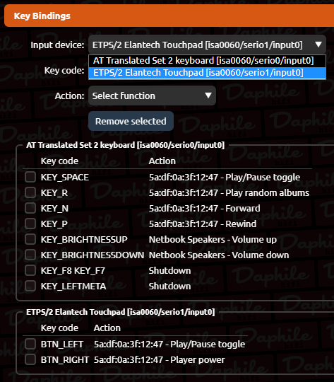

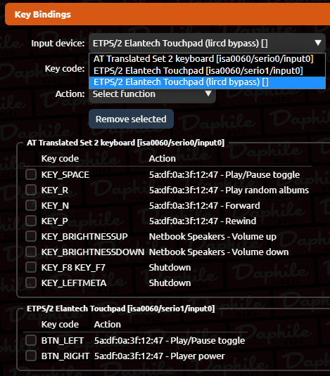

buttons in touchpad stopped being recognized
Hi, i have a problem that started in post-20.08 versions; the touchpad buttons in my netbook stopped being recognized.
i've tested 20.12 and 21.01 if i revert to previous versions the buttons work again
any clue in the subject?
thanks.
list of input devices in version 20.08x86_64:
list of input devices in version 21.01x86_64:
capturing touchpad button presses 20.08x86_64:
capturing touchpad button presses 21.01x86_64:
