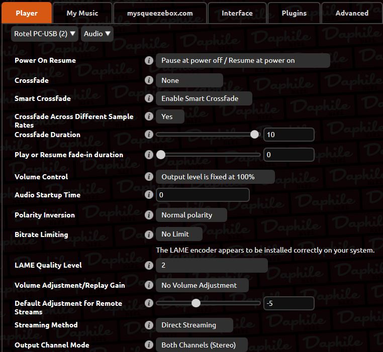

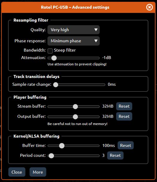

Just a few days ago I tried for the first time to make my Daphile server convert DSD files on the fly to PCM which my PreAmp can process. No success so far. None of both methods offered appear to work for me.Daphile Linux.
I can only guess this means foobar2000? Yes, with an alternate resampler component it seems to work. Haven't tried batch processing yet.F2K Windows.

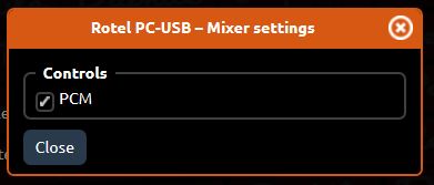

Here you are! These should show the relevant settings.Please post pic of your Daphile settings
Switching DSD support from Convert DSD to PCM to DSD over PCM does not change anything: when a DSD file is chosen for playback, only a light crackling noise appears.

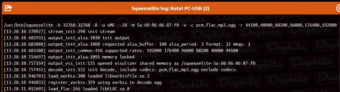

Ahh, just found some more info: Daphile seems to send the audio data to USB via Squeezelite. And here the following is stated:
No DSD mentioned here. Does this cause the problem, or should DSD2PCM conversion be done before the signal is pushed to Squeezelite?
Squeezelite supports gapless playback, a wide range of sample rates (44.1 kHz / 48 kHz / 88.2 kHz / 96 kHz / 176.4 kHz / 192 kHz / 352.8 kHz / 384 kHz) and direct streaming for Logitech Media Server plugins that require it such as Spotify.
