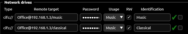

Loss of Network Connection to NAS
I upgraded to 19.02 and can no longer access my NAS (XigmaNAS) or windows PC. I can still access Spotify so Daphile is still on the network.
I had this issue when updating firmware in December 2017. Kimmo looked into it and sent me a beta version that fixed it (daphile-17.12-b171737-x86_64-rt). I have updated since then but the last version that still connected to my NAS was/is daphile-18.07-b090752-x86_64-rt which I am now running.
The problem started with daphile-18.12-b300725-x86_64-rt.
Any ideas?

I have no issues accessing my windows platforms in Daphile 19.02.
do your devices have a static address and do you access them using the ip address rather than the computer name (see the attachment)
cifs://<PC user id>@<ip address>/<music directory>
cifs://Office@192.168.1.3/music
Also, on windows, have you reset the FunctionDiscoveryResource service which was tuned off in Windows 1803. See Fix PCs no longer recognized in network after Windows 10 version 1803 upgrade - gHacks Tech News

Along with the FunctionDiscoveryResource service mentioned earlier, you may also want to check re-enabling Samba (this was my problem): How to access files on network devices using SMBv1 on Windows 10 | Windows Central
Thank you for the suggestion. I checked FunctionDiscoveryResource and Samba is enabled. Both Client and Automatic Removal checkboxes are checked.
It is not only Windows that will not connect, the NAS which is Unix based, also won't connect.
I really think it is something changed in the software. This happened once before. Again the break came with daphile-18.12-b300725-x86_64-rt. When I reload daphile-18.07-b090752-x86_64-rt everything goes back to working.
Since this is the only thing that changed - seems like the problem is with the software.
Again, this happened before and Kimmo was able to fix it in a beta version that he sent to me (or rather a download link) and subsequent releases. I am hoping he will see this post and look into it.
For now I will just stick with the version that works.

If the samba version changed, you might need to set the protocol and enable ntlm.
In /etc/samba/smb.conf, in the [global] section...
server min protocol = SMB2
ntlm auth = yes
Edit: do not set "protocol = SMB2" as this sets the MAX protocol version.
W10 requires SMB3, setting max lower breaks W10 connectivity.
