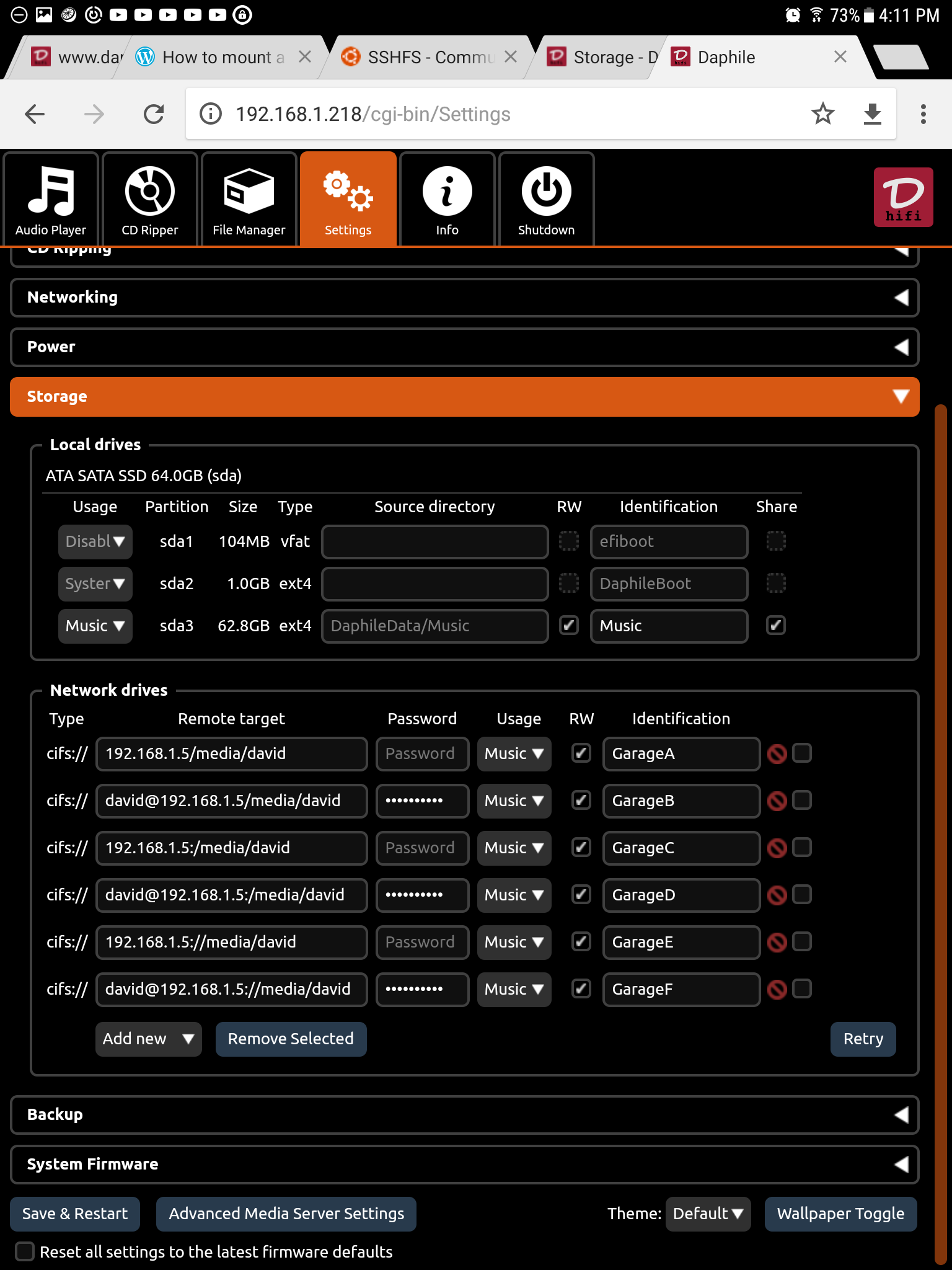

Also, I see a lot of squeeze related posts for accessing an external network. I don't know much about that. Has anyone tried to access music stored on an Ubuntu server? I can't seem to get it to work. I've tried sshfs, cifs, and the other 2 options. Also have used various combos of name@server😛ort/ with and without passwords, names, ports.

I was trying the same, I have a Debian server with a Samba share that all Windows and Android devices can see fine (even my Pis running Volumio/Moode can see it) but for some reason Daphile cannot pick it up even after using exactly the same credentials as (e.g.) Volumio.
So how are most folks accessing their music library? I'm getting hopelessly confused and my brain hurts.
I use a windows cifs connect with no issues "<user>@<ip address>/<directory>"
What are your storage settings? Have you looked at the Daphile storage wiki Storage - Daphile Wiki
I've read the wiki page and everything i can get my hands on. I'm not using windows. I'm using ubuntu (linux), which in theory should be easy to do since daphile is Linux too. As for storage settings, I think I've exhausted all permutations of user, ip address, password, folders, etc.. I just get the :forbiddn: sign at the far right.
Some examples from yesterday. Today I tried another 10 or so.
Have you raised your issue with Daphile. See the contact link at the bottom of the daphile home page. He normally responds within 24 hours.
