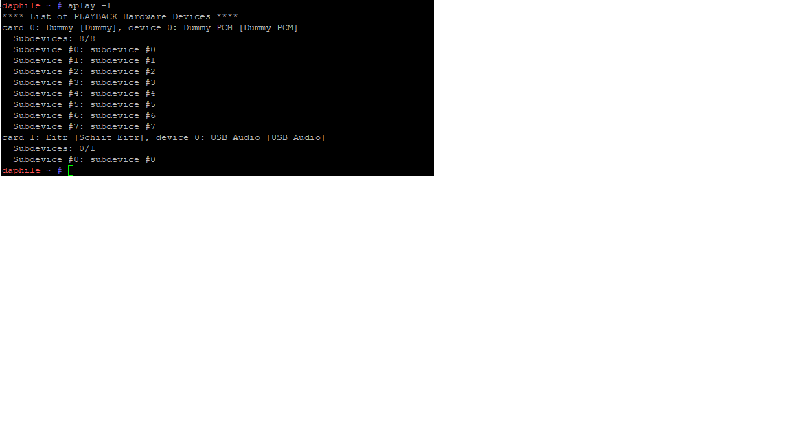

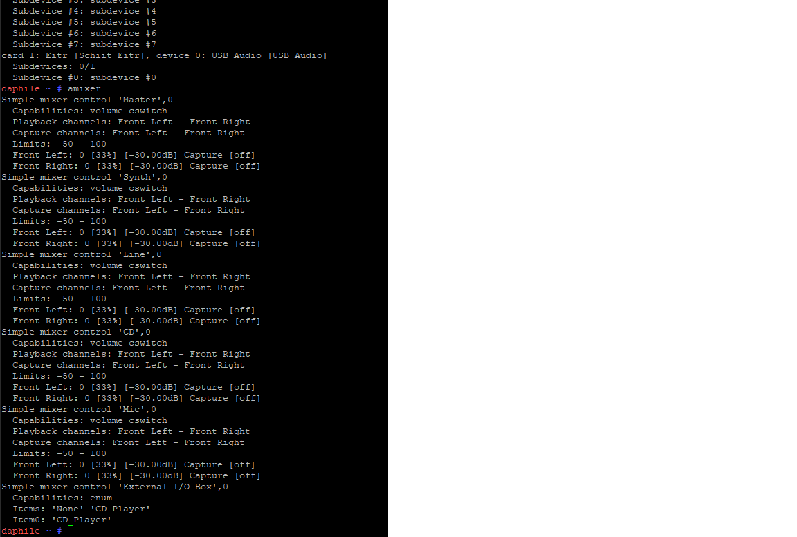

My 2 cents - either
A) the SPDIF device of that soundcard has a different alsa device number than 0 - post here output of command "aplay -l" running on any linux (incl. daphile if you can access command line somehow via ssh)
or/and
B) the 8051 firmware used in CM6631A by the manufacturer implements some SPDIF switch which needs to be enabled first - post here output of command "amixer -c X contents" where X is the card index of your usb soundcard as listed in aplay -l.

My 2 cents - either
or/and
Being a complete noob on Daphile, I managed to SSH into it since I am using beta with login info of root and zaq.
Here is a screen capture:

My 2 cents - either
or/and
One more screen capture - amixer
What is the command line to change the necessary item? Thanks in advance.
