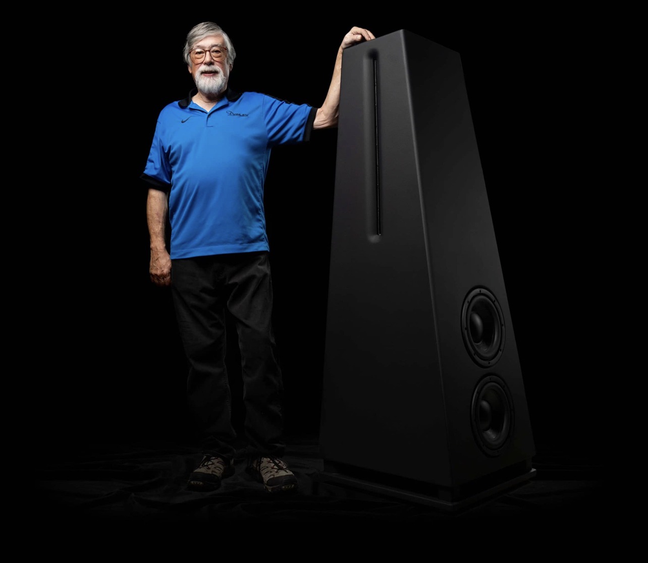

A good photo of the new Danley HiFi speaker half way down this thread:
We Out Here Festival - Speakerplans.com Forums - Page 2
Also lots of other shots of Danley boxes. A friend of mine was there and said the sound was superb.
One interesting thing for me is that despite been molded the mouth termination is still dual slope conic whereas I would have thought a curve closer to Tractix would be superior.
The ASR thread seems to think some sort of paraline.
Brett, What is....a paraline>? Or should I say how does it function...I thought I was lookin at a large ribbon style driver....nope...
Quad 15” by the looks of it. Those are then probably coaxial compression drivers with a series of layered combiners (aka paralines), otherwise they will not go this low. They’ll probably need to go down to 300 Hz or so.
