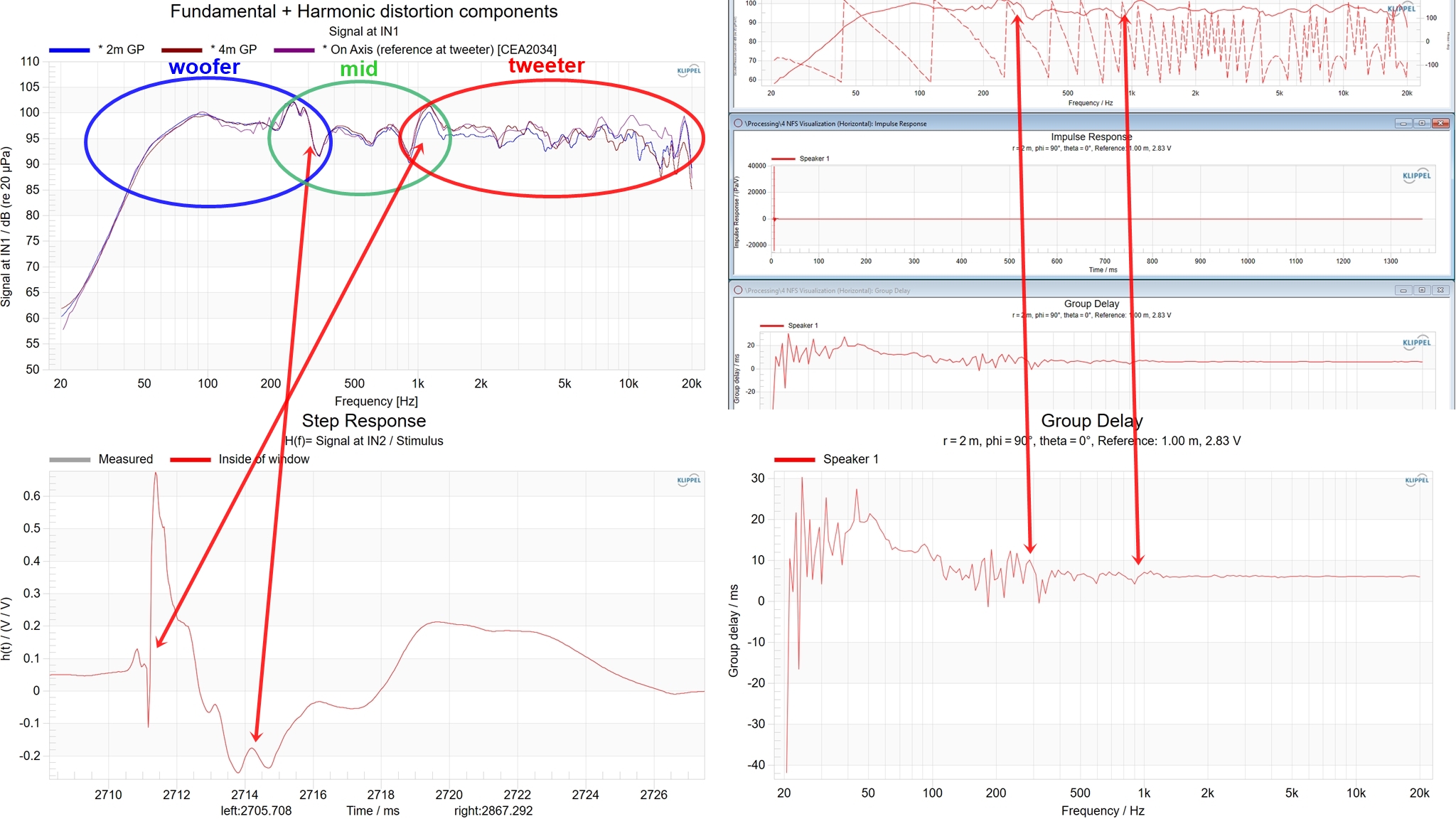

Thank you Erin for ground plane measurements! Surprisingly good match with NFS on-axis, but expected as per previous tests by you.
Regarding step response, it would be essential to know individual responses of woofer, mid and tweeter, to evaluate timing match between drivers. Impulse response in your attachment has very long time scale, so we can't compare it to the step response graph and impulse looks too good.
More info about 3-way step response analysis Measuring Loudspeakers, Part Two Page 3 | Stereophile.com
To me it looks like there is problems with midrange integration (timing) Step response peaks don't match like they sould. In group delay graph it even looks like mid pulse comes earlier than tweeter and woofer band is not smooth like it sould, and has timing mismatch with the mid.
Danley's claim for SH being time-coherent doesn't hold (at least for this version of SH-50) Multiway-dsp controlled crossover would most likely give much better results, even without FIR because of better response EQ and timing control. Fully digital Hyperion would be a killer for hifi, if one likes narrow directivity sound!
I agree with you, Juhazi, and that's why I brought up the possibility that something isn't working correctly. Those measurements look funky. I think Erin knows how to measure a speaker, and that's why I suspect that something is broken or wired incorrectly.
A few years ago, I was doing a subjective listening session with one of my friends who's spent A LOT of time listening to speakers, and he was able to pinpoint that the speakers weren't wired correctly in literally one second.
I think there's something similar going on here, but it's not clear to me if it's an issue with the midrange wiring or the compression driver wiring. At first I'd assumed one or two of the mids were blown. Now that Erin has confirmed they're working properly, I'm beginning to wonder if the compression driver is wired out of phase.
If I'm right, that may explain the peak and the dip in the midrange. A tweeter wired out of phase would cause that.

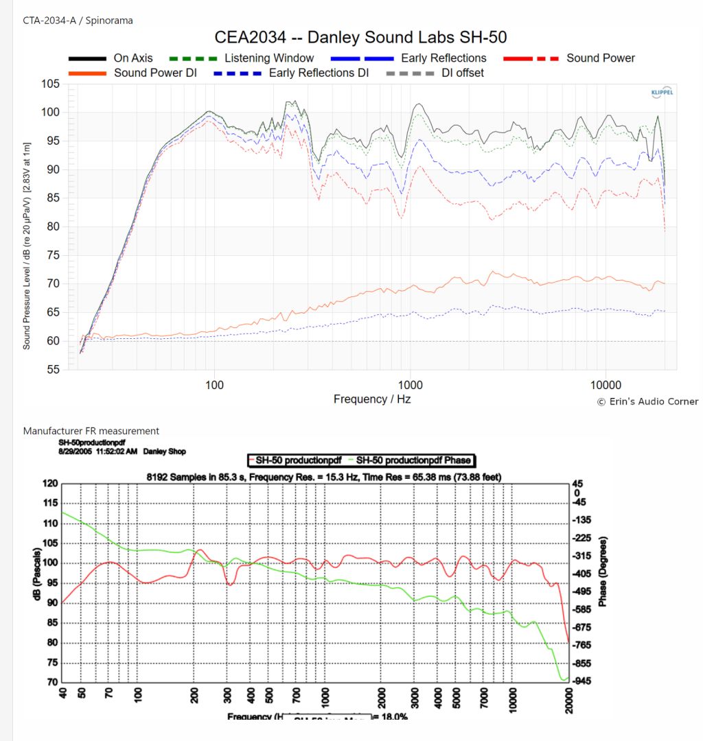

The key question here is, that as Erin et al. told, SH-50 has had several iterations of passive xo. We don't know details of each version, no less comparable measurements. We don't even know exactly, what was the reason for those iterations - lower distortion, smoother response, better impulse/step, better power handling etc.
Danley don't have to reveal that data to us, no way. But I'm left wondering... I have never heard a Danley MEH speaker and most likely never will, only some diy MEHs in small rooms, so this is a purely "academic" dilemma for me.

The NF/FF summation occurs around 1.50 meters (I mentioned this in my writeup).
You can see that from my groundplane measurement, there is practically no difference in the 2m vs 4m test and the only difference there is is directly attributed to the relative angle of the mic to the speaker (my driveway is slightly sloped; the mic is at the "higher" angle and, looking down, thus, more on-axis the further away it is placed).

The loudspeaker sums the output of the drivers internally in-phase. So, in effect, it is a point source with its acoustic center being quite steady vs. frequency (that's the phase measurement)--like one driver is playing, or in other words, effectively zero convergence distance. Only the internal delays of a single full-range driver would be applicable.
If you were measuring drivers on a flat baffle (i.e., a direct radiating loudspeaker), then there would be positive convergence distances between drivers. This thing literally measures like a single driver, however.
I think a lot of folks have missed the "acoustical summation" point that Tom made in his 1999 patent (US6411718).
You can also see this in Danley's EASE data on the SH-50.

Here is the phase of the SH-50 that I measured in my listening room vs. the Jubilee (again, cyan is the SH-50, yellow is the Jubilee). The phase of the SH-50 shows that there is a net 360 degrees of phase rotation over the range 60 Hz-14 kHz.
If what you are worried about is this movement of the acoustic center vs. frequency over its entire bandwidth (the entire loudspeaker), then the 1.5 meter number might have some meaning, but that would have to referenced from a datum behind the loudspeaker's mouth or throat by that distance, not in front of the loudspeaker--right?
