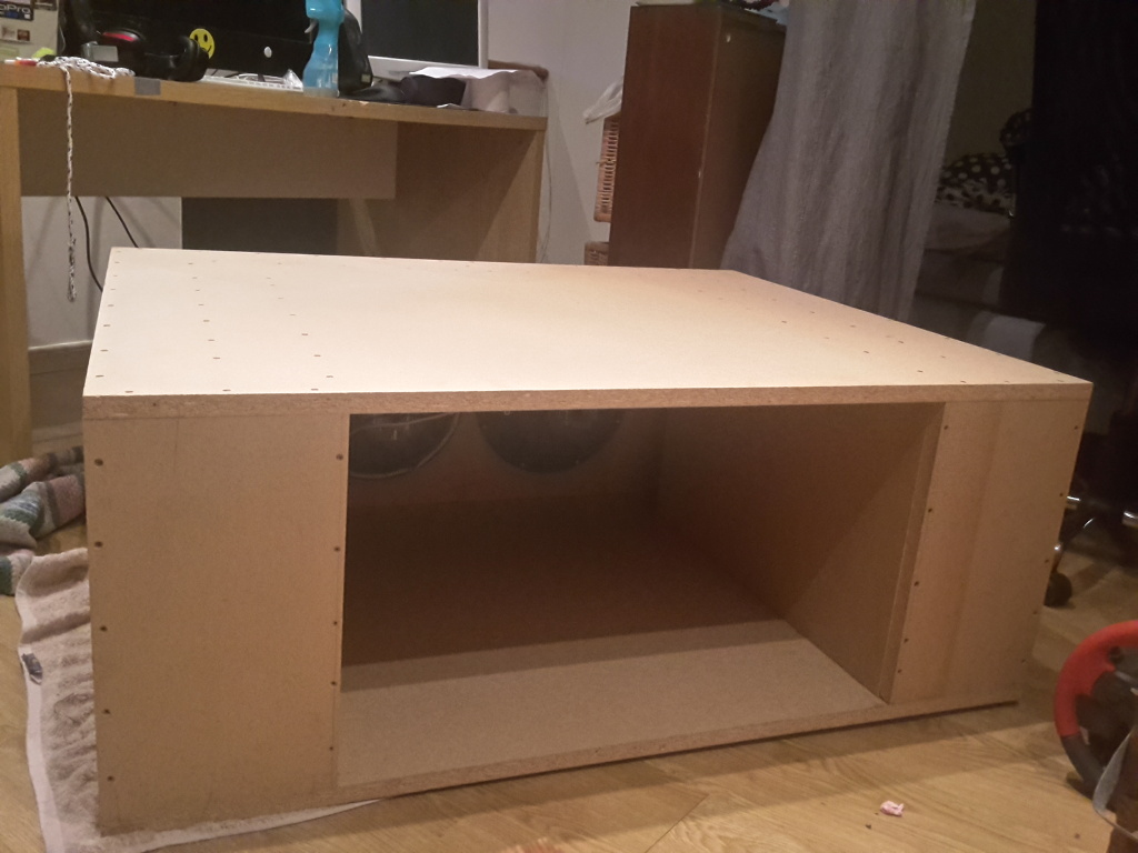

My oldest son has been nagging me for this horn for some time now...
He is going to be using this beast as a computer sound system for games and movies.

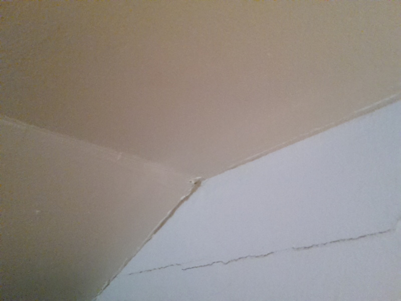

With a single channel from my old H&K surround-receiver (100 watts) everything shakes so violently that all the computer-screens in their large room starts to flicker badly.
There is already cracks between the plasterboards where the putty has crumbled to dust.
My son is happy!!!

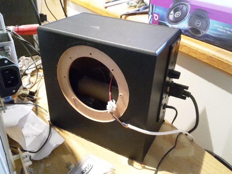

When we started to see this kind of cracks all around their walls I quickly removed my bridged QSC RMX1450. Now he uses his small "plateamp" built into his 2.1 Logitech computer speakers. Two TP-QWR loaded Beyma 12P80Nd can play incredible loud and powerful with only those ten watts.
The large TPQWR has about 22 dB higher efficiency the the small 5.25 inch speaker originally in the bass-box. There is no way to balance out the sound. The bass is totally overwhelming and very physically tactile and "large".

That's some pretty radical plasterboard damage in Post #309, looks like the whole board came loose, and moved at the edge. Good decision to cut down the available power. 🙂

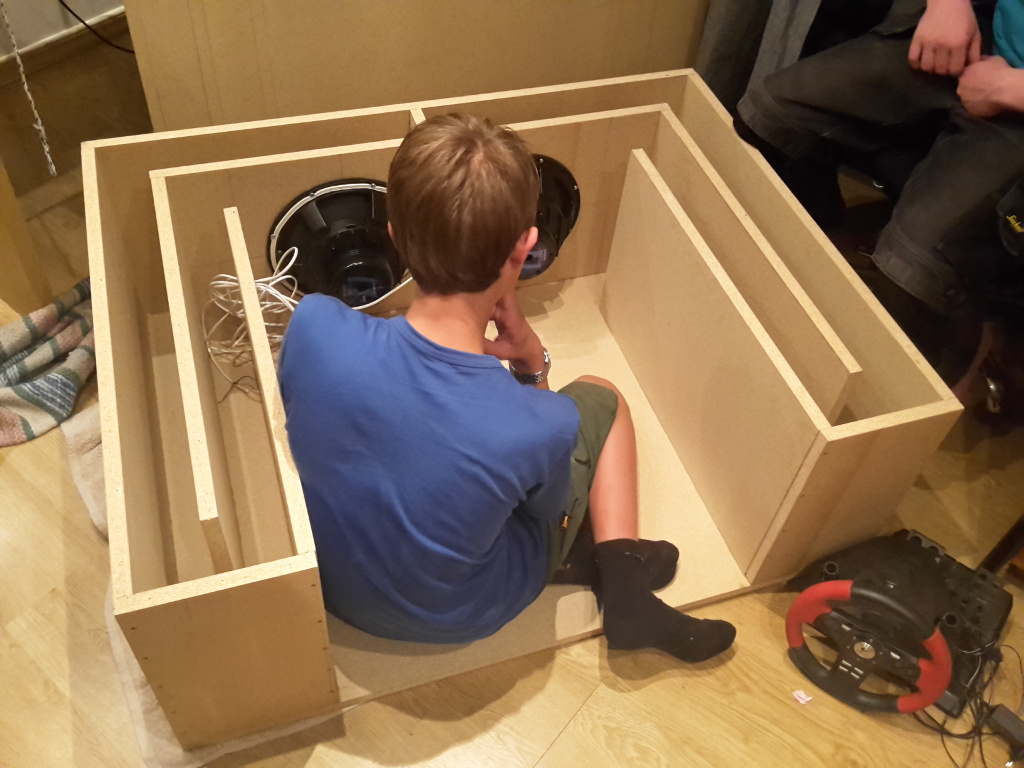

A quick question to the view from inside the box in Post #304, it looks like there is gasket material on the back of the left driver, have you tried to run the box w/ one of the drivers inverted from the other, and if so what did it sound like?
I have not tried to mount the driver the other way. There is not enough space behind the baffle for the magnet.
The gasket material is just left in place since the driver was previously mounted in a MTLT box.
