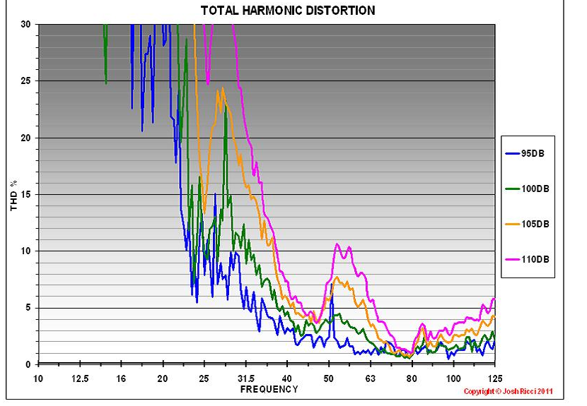

1)First of all I am not writing about domestic "wife and kids asleep - easy late night listening to Diana Krall" here. Once you start to push the power levels to a large fraction of the drivers rated power and a large portion of the xmax - then you start to see "Distortion increases roughly by the square of the diaphragm displacement".
Please see the measurements in the graph above.
2)I don´t have any measurements. It is only a logical conclusion that a deep dip in the response will not transmit distortion within that frequency range, while a peak or at least a level spl-respons will transmit harmonics that fall within that range. I have no way to measure that effect though.
Johannes,

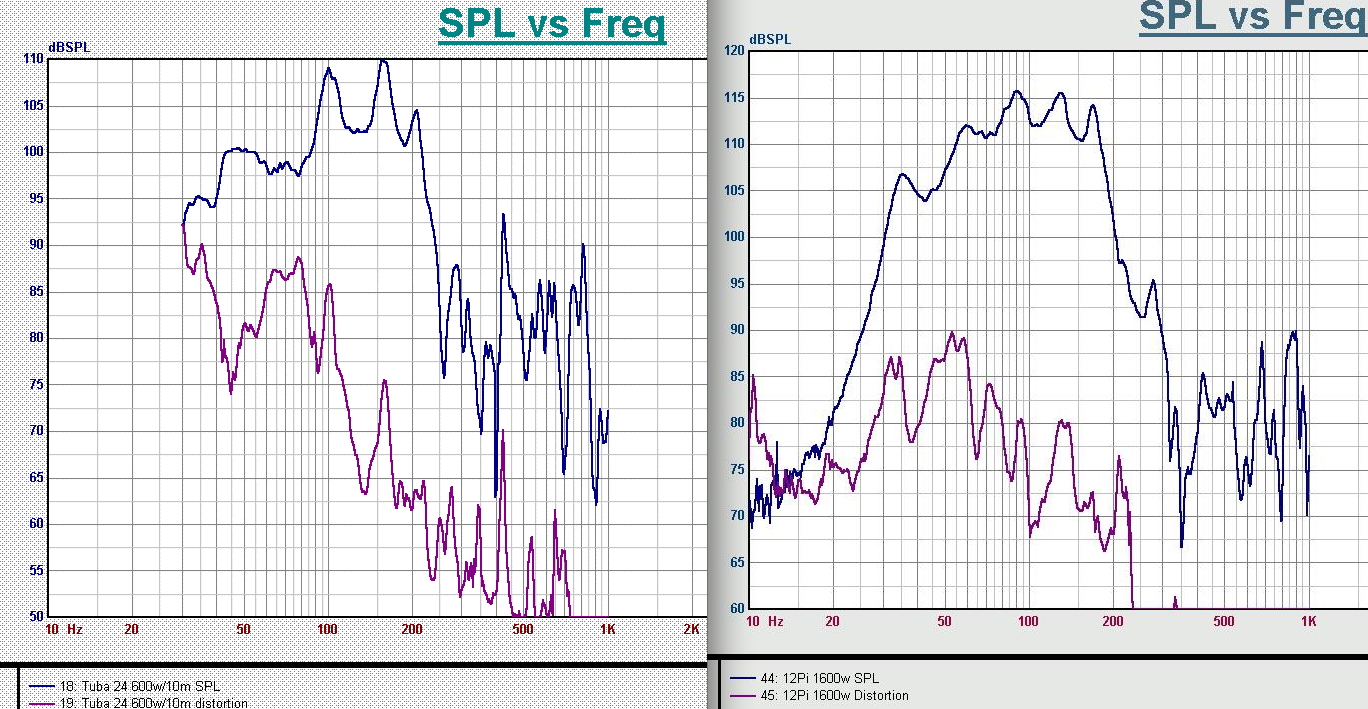

1) I could care less about distortion at low levels, the distortion measurements I previously posted were at the drivers full rated power, which results in displacements around Xmax at frequencies above and below Fb. As you should be able to see looking at the displacement compared to test frequencies, displacement does not correlate directly to distortion. Cone breakup modes, bending, etc. all contribute to a complex distortion response.
The graph you posted shows at some frequencies almost no difference in distortion over a 15 dB range. A 10 dB change in level from 95 to 105 would require at least 10 times the power, and more than 3 times the displacement, yet at 31.5 Hz the distortion level only rose from 6% to 17%, less than 3 times the distortion. I see no evidence in the example you chose that shows "Distortion increases roughly by the square of the diaphragm displacement", from what it looks like, if anything it's roughly linear, not logarithmic.
2) You can see in two examples of FLH below that they have steep band pass drops above 200 Hz, yet distortion levels do not fall off as steeply as the frequency dips.
All though you thought a deep dip in the response will not transmit distortion within that frequency range, measurements do not bear out your "logical conclusion".
Other than the rapid increase of distortion caused when a speaker is driven past Xmax, very few generalizations regarding distortion can be made, especially when considering resonant enclosures.

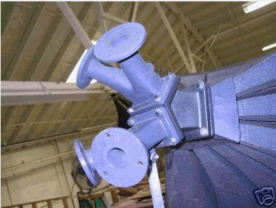

Yeah, as we noted back at the beginning, until more actual data convinces us otherwise, it appears to be a multiple stub FLH terminating on a flat baffle 'wall', which like the BDEAP32 is basically a Bell Labs/WE/Lansing/Altec four driver horn manifold assembly + drivers from the '30s adapted to a truncated point source loaded [mid]bass horn that can be configured into a much larger horn without needing any additional path-length.
GM

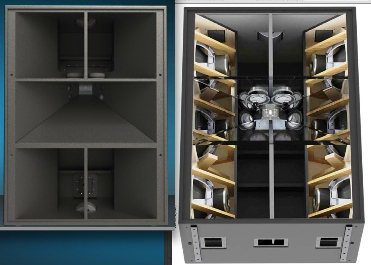

From what I understand it is a FLH with a tweak at the horn exit where the rest of the enclosure acts as an extension of the horn or as boundary.
Also, how small is the compression chamber of the drivers? From what I see in J1-94 he used a VERY small one . what do you think?
The approximate volume of the compression chamber would be fairly easy to determine from DSL's interior view of the JH-90. The JH-90 appears to be a simple short offset one bend FLH peaking around 75 Hz, rolling off at about 18 dB per octave below. The small compression chambers keep excursion in check below Fc.
The DSL BC (Boundary Coupled) FLH horns also appear to use small compression chambers with longer horn paths terminated with the BC. In the case of the BC218, it can be used as either a BC or standard FLH, frequency response of both configurations are in Post #244.
