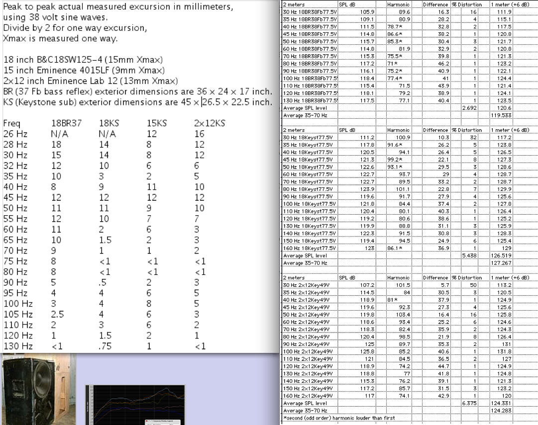

Johannes,1)Distortion increases roughly by the square of the diaphragm displacement.
2)Any distortion lowering mechanism is immensely valuable when trying to push real world spl/dm3 ratio (power density) from a design.
3)This is a very real flaw with classic tapped horns and FLH. They will "amplify" their own distortion products greatly by all that peaky spl-curve ripple that according to Hornresp can be many dB more efficient then the desired passband of the TH.
4) 3 dB more spl-capacity from a box equals one less box needed.
1) http://www.diyaudio.com/forums/subwoofers/185588-keystone-sub-using-18-15-12-inch-speakers.html
As you can see in the actual measured excursion of a bass reflex cabinet and a tapped horn cabinet with a variety of speakers compared to distortion (post #12), your statement is incorrect. Even in sealed cabinets measurements distortion did not increase at the square of the displacement.
2) Agreed, but the charts below (taken from the above post) indicate the TH generates more distortion for a given displacement than a BR.
3) I have not seen any measurements that corroborate your statement.
4) As JAG already pointed out, another box, speaker and amp adds 6 dB.
Of course, as JAG has mentioned in regards to his "large voice coil" findings, a 3 dB difference between a sim and measured response is "massive" 😉.
Art

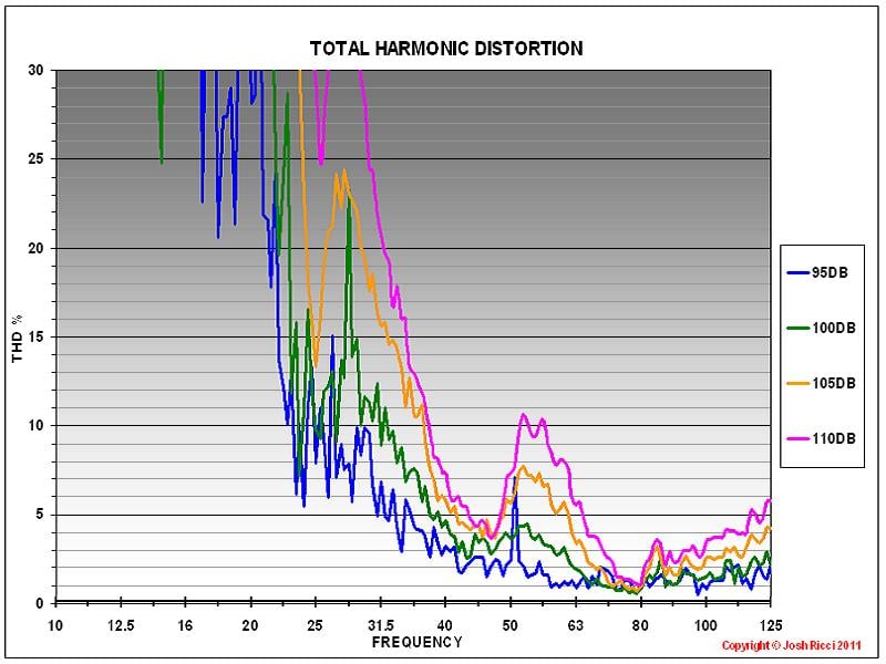

DISTORTION.JPG Full Screen Image | Audioholics
First of all I am not writing about domestic "wife and kids asleep - easy late night listening to Diana Krall" here. I am constantly referring to high power-levels, so the roughly square relation between power-level and the amount of distortion is not from 0,1 mm to 0,2 mm diaphragm displacement. Once you start to push the power levels to a large fraction of the drivers rated power and a large portion of the xmax - then you start to see "Distortion increases roughly by the square of the diaphragm displacement".
Please see the measurements in the graph above.
This is very dependent on the amount of compression and the suitability of the driver. A TH usually have more spl for any given cone displacement. it is always better to measure distortion based on spl then displacement. If the TH is 5 dB more efficient and produces twice the amount of distortion for a fixed displacement the TH comes out ahead.
Most tapped horns have way to much compression. A S2 (in Hornresp) of less then 50% of Sd is too much compression. JAG used 201 cm2 in his simulation of a tapped horn for the B&C 12NW100. This is 201/550 = 36,5% of Sd. He has still not shown a simulation without very high compression-ratios. Many times this compression is asymmetric due to the expansion of the horn, warping the cone and suspensions. This will increase the distortion-levels very noticeable when you start to push things hard (as in typical pro sound usage).
Johannes
I don´t have any measurements. It is only a logical conclusion that a deep dip in the response will not transmit distortion within that frequency range, while a peak or at least a level spl-respons will transmit harmonics that fall within that range.
It is easy to hear the effect in real life with a tone-sweep or a tone-generator centered on the frequency of interest. I have no way to measure that effect though.
Johannes
Art
Here's an example. The difference is not more than 3 db anywhere in the curve but the corrected (red) vs uncorrected (blue) sims is massively different, IMO at least. And note that the corrected (red) sim matches the actual measurement much better. Maybe you would not call this massive, but 3 db variation throughout the whole bass region and the very lumpy measured response compared to the uncorrected (blue) sim is cause for concern IMO.
Top - Othorn with Mach 5 UXL as measured by Ricci (data-bass guy)
Bottom - corrected and uncorrected sim (note that while my correction is not perfect it's a whole lot closer to the measurement than uncorrected)
The point of the exercise was to recreate your response curve and displacement curve with a different shape (tapered) and with different alignments.
Please note that I used EXACTLY the same compression ratio that you did in the design I was copying. You chose that compression ratio, not me. If you want to do the exercise again with high compression ratios I can. I'm a bit limited for time but whatever you can do I can match it with a more conventional tapered tapped horn.
