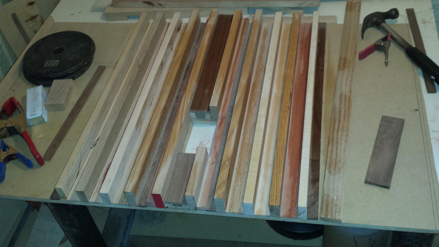

I have some red in the mix. I posted a picture back a couple posts. I wasnt clear on that so Ill take over the apology. I will update tomorrow or next.

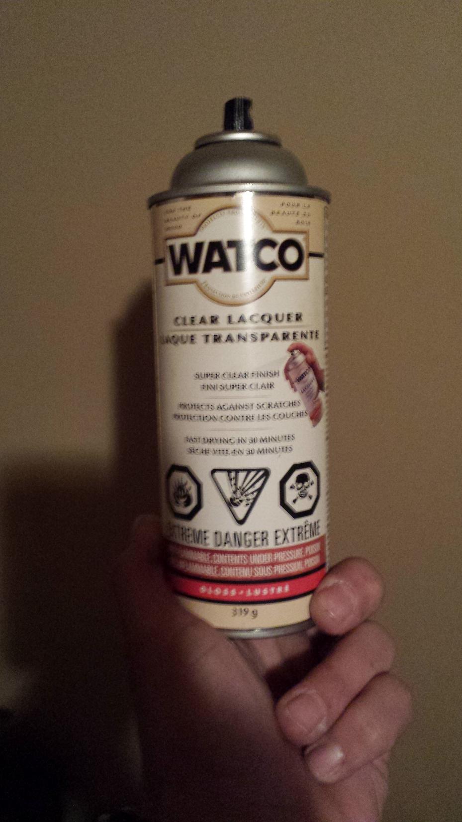

I bought a clear watco spray bomb to test once the humidity lets. I wasn't always happy with spray on clears in the past but I have not tried the watco brand. Some of them tend to dry matte and look unprofessional. I was thinking if I do do multi finishes that will be less likely to leach opposed a thinned brush on clear.
Thanks for the pointers. I will absolutely test everything prior to committing.
I dampened grains here to accentuate them but it looked nicer in person.

They're putting Watco in a spray can??
Doubt that it is actually Watco, since the gov't doesn't like us to spray VOCs at all.
Best buy the can...

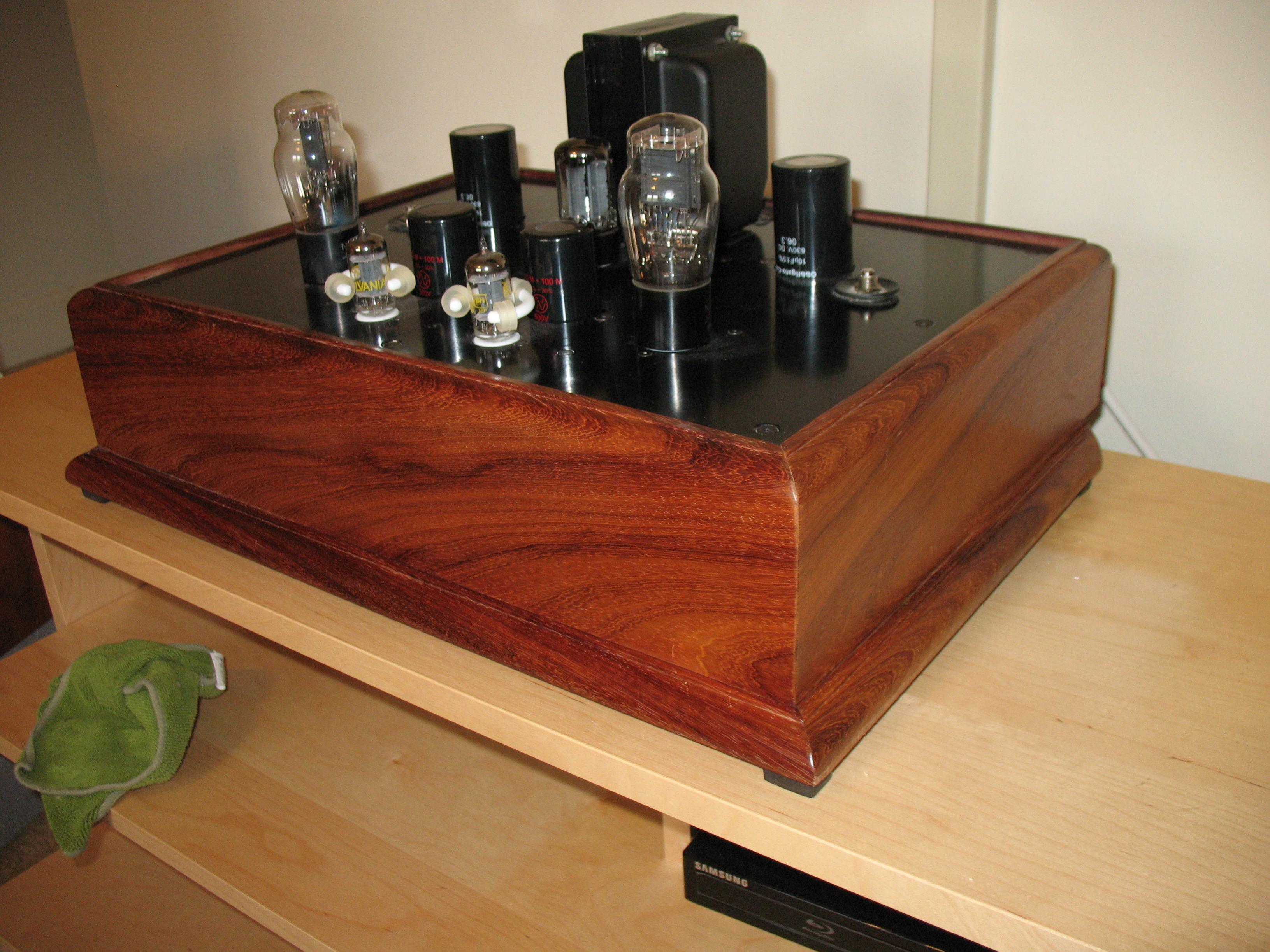

I find that Sherwin-Williams "Wood Classics" satin varnish is just excellent on Walnut or Cherry over a few 1 1/2 lb. cut coats of Amber Shellac. The shellac helps bring out the color of the wood and reduces splotching. I pad on the shellac whether as a base or a topcoat and apply the varnish, surprisingly, with a foam brush.
On exotics like the Padauk used for my 45 amp it's straight shellac: 12 coats over as many days. The first 4 3 lb. cut lightly sanded with 250 Garnet just to level then 0000 steel wool for the next 4 and 4 more of 1 1/2 lb. After a month, paste wax applied and buffed with a micro fibre cloth.

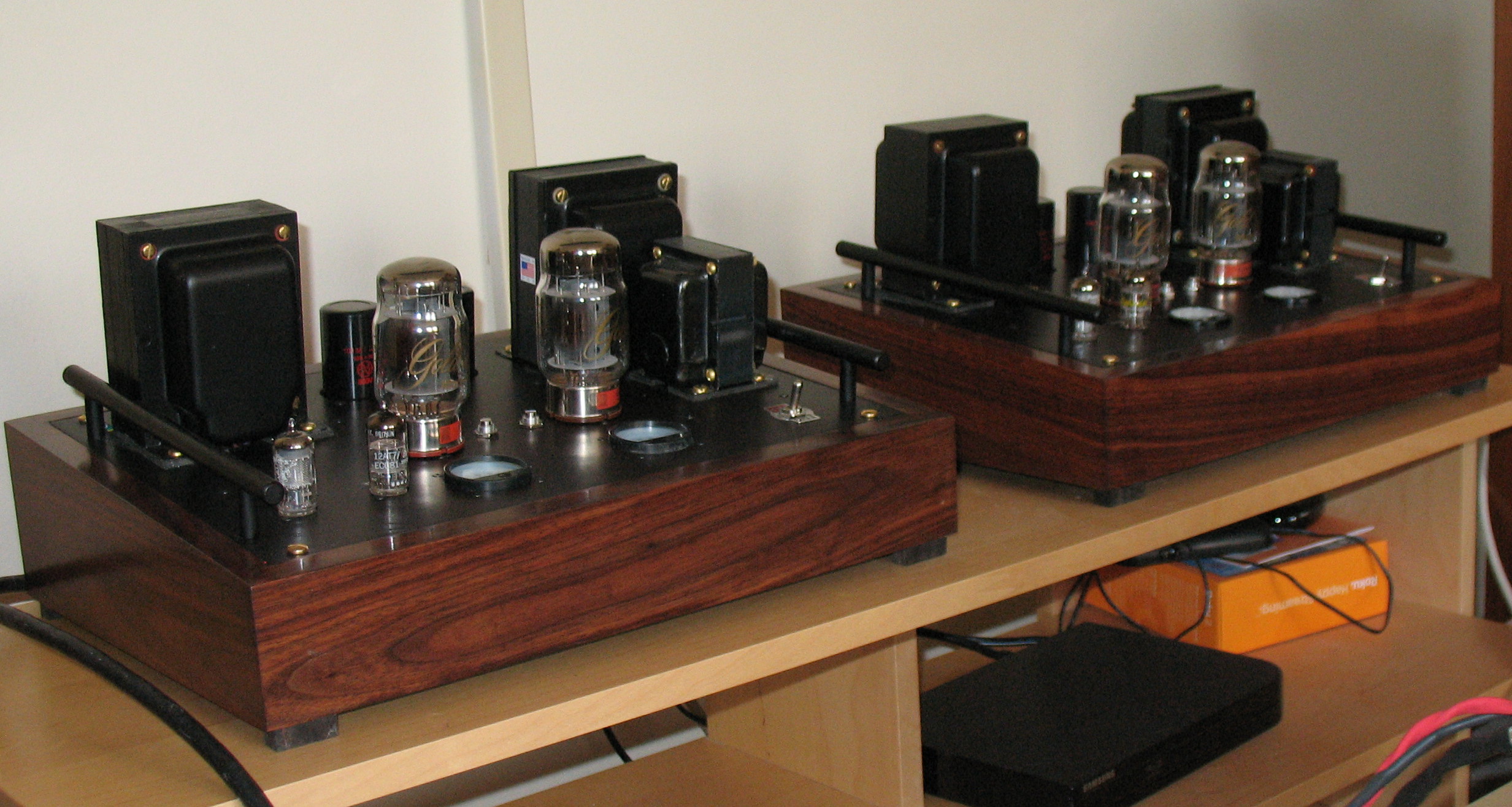

The Walnut mono-blocks are 2 coats of 1 1/2 lb. cut of amber shellac to bring out the color then 4 coats, each one sanded with 250 then 400 grit garnet, Wood Classics Satin finish. After a month, the varnish is waxed using a pad of 000 steel wool dipped in mineral spirits, squeezed out of the excess and used to apply Minwax paste wax buffed with the micro fibre cloth.
