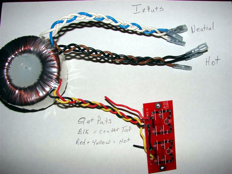

mattjk said:
OK, I followed the instructions from another thread. You are right.
The output measures fine, but when the chipamp modules are connected, the tranny buzzes like crazy and gets hot within 15 seconds.
Is it worth the effort trying to get this thing to work or should I just get a non CT transformer?
Use what you have, just remove some of the diodes and rewire according to the corrected picture here:
http://www.apexjr.com/miscellaneous.html
ok, got it working 🙂 sounds great!
do you think I would benefit going to a 300va transformer?
