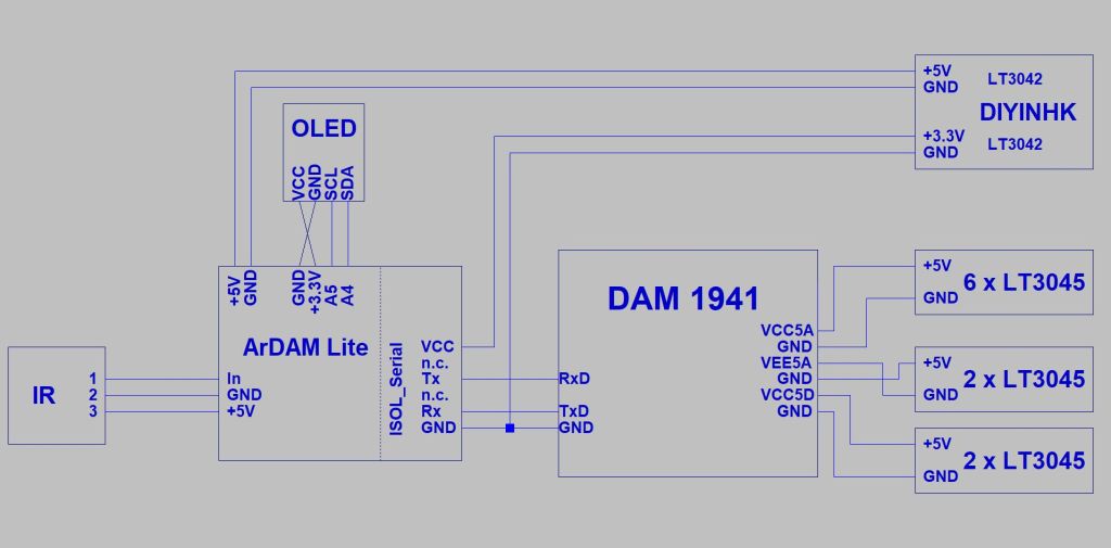

Hi folks.
I am playing with the idea to get myself a 1941.
I've been there before -- more then once. The pricetag is what usually kept me away
from pushing the button.
However. At least I would like to make sure beforehand that I get this DAC properly integrated into
my RPI/squeezelite environment without having the need for any further onboard controls.
Does anybody know if the python library dam1021 is compatible to the 1941?
Has anybody used that library to upload e.g. custom filters to the 1941?
Has anybody been using that Alsa dummy driver for volume control on the 1941?
Why actually doesn't offer the 1941 VC through the generic Linux USB driver?
And than I'm wondering what advantage I'd have to use onDAC volume control,
if any app supplies me with a 32 bit SW VC!?!?
That would leads to following question:
Is there any option to bypass all the Soekris internal filters and SW volume control and
do the related tasks externally on the transport?
I guess running DSD and DOP prevents from using volume control at all. Right??
ESS Sabre is the only one offering it afaik.
Power supply:
I do have several quality 5V supplies around? I do lack a -5V supply?
Is there any common opinion what'd be the best choice for a -5V supply?

If all of your 5 volts supplies have their own transformer just switch the leads to get negative voltage.
I got one of those IFI 5 volts switchers based on your advice and must say it is unlike any switcher I have ever used.
I am using that for the digital supply in my 1941. I am using brute force linear for the analog section.
I get the feeling that smps and digital have an affinity for each other. Makes one think that the smps has an ability to deliver current quicker than a linear supply and this is good for digital.
You mentioned that you are using a capacitor after the IFI - how large? I have looked and looked and cannot find where you specified what worked for you.

+1 for Nick’s UBiB. Tried cheap XPower and Recom SMPS, the TIs and 3045s. UBiB audibly better. Plus the board is ideally suited as it has two positive rails and a negative. Next GB is imminent, might be worth putting your name on the sheet. Was on an 1121 though, not 1941 so usual caveats.

BTW:
I used Ldovr TPS7A, LT3045 (much better, than the previous), Stammheim LT3045, Salas Reflektor-D and UBiB boards.
For me the sonic hierarchy is the same sequence.
Are these (-)5V rails feeding any (key) part directly on the DAC?
Or do they feed another regulation stage?
Why I'm asking? On several other projects best results were achieved by
avoiding daisy chained regulation stages.
The currently best solution seems to be on oversize buffer (supercap - several Farads),
which is considered even better than a LiFePO4. I'm fully in line with this approach.
I currently run an Allos Shanti with >3F on the output feeding my current DAC and RPi .
I used to run iFi iPower with 47k Rifa on the rail (which wasn't worse then the Shanti IMO).
( I guess that answers Ricks earlier Q 😉 )
But again. I'd understand the use of Salas and 3045regs etc. if there wouldn't be any further regulation onboard. And that I don't know.
