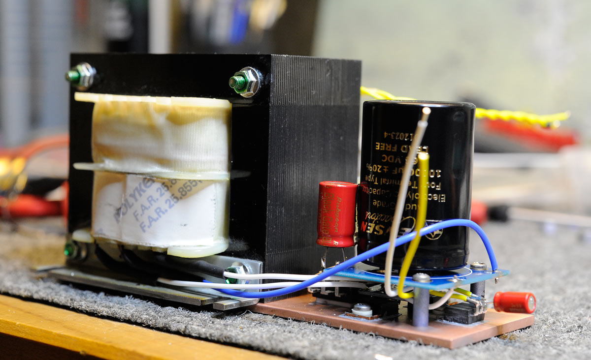

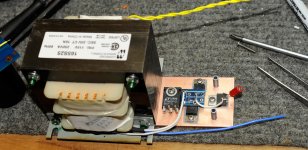

Finally got supplies assembled.
Since they are not regulated I thought it best to be sure i was getting correct voltages before making final assembly - I thought it would be best to text the digital supply and the analog supplies separately. The original board could be powered on separately. Is this still the case?
I connect the digital supply and nothing happens. I figure there is an LED like there used to be to signal and it is obvious from my voltage meter that nothing is happening. I started with a small value bleeder to be sure I did not go over voltage. Which I wouod subsequently make larger until I get the correct voltage.
I measure resistance between the digital power input and pins #3 & 5 for 5 volts out on the adjacent header and there is infinite resistance. I have assumed it would be zero. Is this correct?
I did remove the small choke at the input and have made sure there is continuity between the input pin and the inside pad where the choke used to be. I used a small piece of copper foil to bridge.
Do you think I disturbed something else when I removed the choke?
Does the analog supply have to be on? Is there a relay for the digital supply that is powered by the analog supply?

There is the green status LED on the dam190x1, just like on the dam1021, and with the same function. Digital Power should be enough to get life in the LED....
Why do you want to remove that inductor, you should first get the board going as standard before starting doing modifications....
Nothing will happen unless the Digital Power is within specs, and that's hard to do with an unregulated supply....
What do you mean by "adjacent header", please be more specific, they're all marked....
J4 is the header.
Having read the breathless praise of the IFi switcher I have ordered one of those for the digital supply.
If it really only has 1uV of noise - I know i could never approach that.
I removed the choke when planning on using the SALAS shunt reg and got the feeling from Salas that his reg would probably be happier without it.
I wonder if the switcher would, also, prefer it gone?
It is that insatiable desire to DO something to it. I may replace them in time.
I had to try it to find out - but i figure I am better off using the switcher instead of my mountain of chokes and capacitors for the digital supply. Should have said "looks like I have no other choice. The batteries worked (before) since they are basically regulated internally and had immense current delivery capability. My linear supply was heroic - low resistance chokes - but I am sure your instinct is correct - not up to the task for the current. (choke input - 100mH/.8R with a second stage of 160mH/3.9R)
AS ALWAYS, thanks very much for your guidance and patience.
