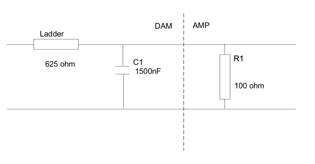

The last lowpass filter is those 1500 pf and 625R output impedance, giving F3 at 170 Khz. If changing output impedance then the capacitor should match....
The reason us DAC manufacturers like the 2V output level is to get better S/N ratio and to be able to driver power amps directly, especially with a good digital volume control.... I believe that a overly sensitive power amp is a bad design, I like the sensitivity of pro amps....
What happens if I see that new resistor as the input impedance of the amp instead of output impedance of the DAC?
How is it? The cap is not on the actual output of the DAC.. as in "last component"? Because if it where, the 626 ohm ladder would be the caps driving impedance and not what it sees?
I became confused now... help!
I doesn't really matter where it's located....

I think TNT was writing about the 100R resistor I thought I would need to attenuate the DAC.
