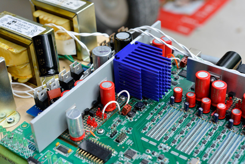

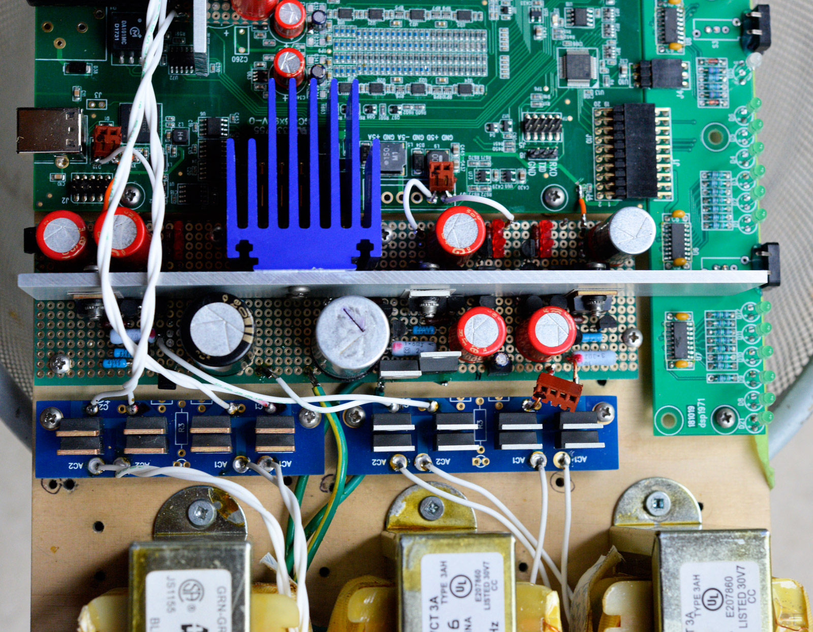

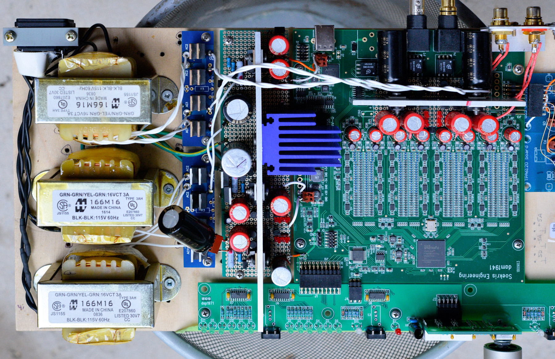

Overall, I have five Salas regulators: 2 in Vref section and 3 in digital section. Each regulator is powered from a separate winding on a transformer.
The USB circuit and display have their own regulators. In a picture, you can see one of the filter caps hanging in a socket; this is from display regulator, as I wanted to see if there is any influence on a sound from this section. Surprisingly, it affects the sound very much and premium parts were needed here as well.

Peter...five ???
Wow.
Can you elaborate why you took this decision and what it did to sound ? I am still on two for analog / Vref and rest is the stock reg at the moment...I thought to change the stock digital out for a Salas...but not sure if that is worth it, but you actuall topped this with actually three more ??.
Wow.
I switched from a stock PS very early in a process of modding this DAC and the difference was quite noticeable, although it’s hard for me now to describe it now: dam1941 - Next Gen Discrete R-2R Sign Magnitude 24 bit 384 Khz DAC module
Power supplies are foundation of any circuit so it’s worthwhile to put the efforts there. My impression is that power supply in digital section is as important as analog/Vref.
I decided to split it into three separate regulators to maximized potential of the DAC circuit.
The level of refinement I’m getting now is on a completely different level then it was initially. Each change wasn’t mind blowing though, but rather small step into right direction. Right now I have a feeling that the limiting factor is not a DAC itself, but rather the rest of my system.
Overall, I think that a single digital supply is sufficient here, and powering display and USB separately adds rather little, although it’s still worthwhile, if no efforts to be spared.
I have to admit, that I was somewhat inspired by that DAC in all my work here: Mystique v3 DAC Balanced
I tried the chokes briefly, but I had a feeling that they were adding too much coloration and the sound although smooth and pleasing was loosing purity.
