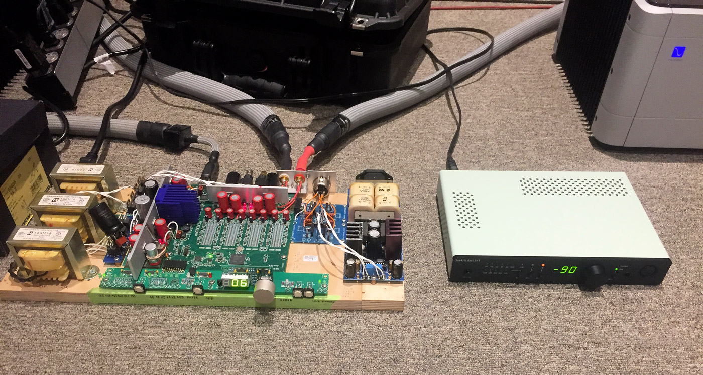

Yesterday I had an opportunity to compare my modified DAC to a stock Soekris dac1541 as well MSB DAC. There were 5 other people present at the listening session.
We listened to my DAC first and it produced favorable impressions: "very natural", "great soundstage", "speakers disappearing", "organic", "damn close to MSB" were some of the comments from listening panel.
Later we listen to stock Soekris: it sounded nice but nothing really stood out: the soundstage narrowed, vocals lost naturality, it just wasn't that much engaging and refined.
The MSB DAC was last; it sounded very impressive in audiophile sense, but at least one panelist commented that it wasn't as natural as my DAC, with highs more edgy and less smooth.

I am curious what power supplies were used for the stock SOEKRIS. Should we assume the same filters were used on both the stock and the DANIEL SOEKRIS? I would think so.
Peter has never said which filters he is using. Maybe there was a mention of retaining the stock filters but I am not sure.
It was Discrete DAC with Premier Powerbase: The Discrete DAC Pricing - MSB Technology
Soekris dac1541 uses switching PS: http://www.soekris.dk/images/dac1541_open_1200.jpg
For comparison I was using stock filters on both DACs: the preference was soft minimum phase (LED off).

when you're saying "stock filter" on both, do you mean what they came with, or both having the new 4K filters ? I'm asking as if it is an older dac1541, then it came with the old 2K filters....
