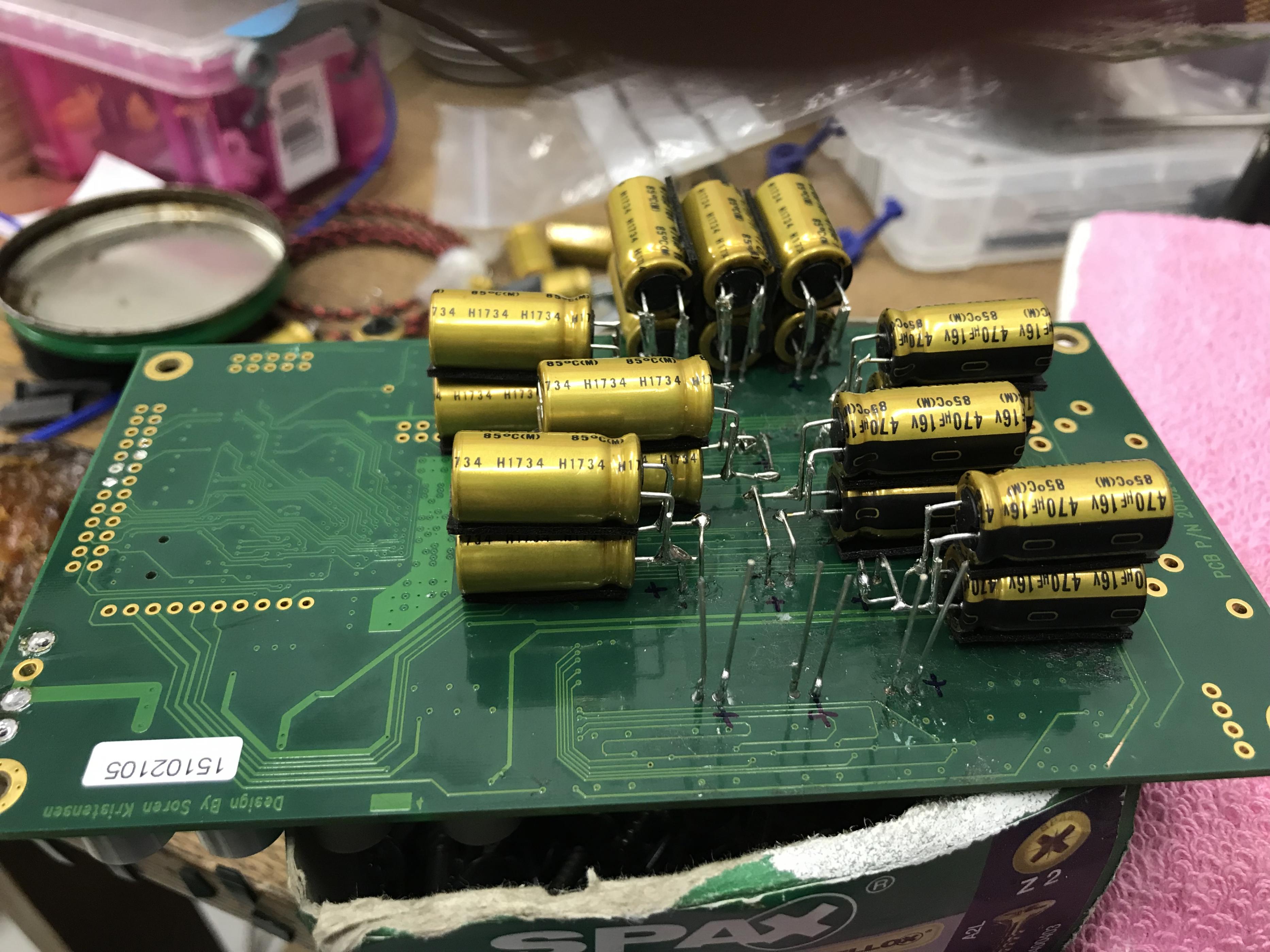

I had same results with 1021. For me works best 3 diferent value caps. At the moment I have 36 pc of 470uf FG caps where before expermented with 3 diferent values 50+100+470uf with better results. Also tryed 24 pc of KA series they also work good.
Could you post pics please? I also like FG. Did you manage to avoid long connecting wires?
Please comment on the SQ differences you hear with the KA series vs the FG series in this application. Thanks
Its on dam 1021.
KA series was the first Iv tryed and as being first try it gave my big ipresions it transofmed dac from stok quite a lot, I knw that caps make difference but newer thougt it will be that much. So I started expeement with caps, first I removed ceramics and it gave me same results as descibed in earlier posts. Then I tryed 12x1000uf FG series. As i had 3 boards at the time with diferent caps on them it vas easy to compare them. Only diference was that one of the boards had 05 resistors oather two where 012, so one 012 board had 24x470uf KA series and 05 board had 12x1000FG series, KA series bord sounded better more natural loats of space benind speakers but stil can hear presence of the speakers. FG series board sounded not as natural as KA but still had good imaging and good base bus on the high end was somethig missing. On third board I had all ceramics removed and had 12x50uf FG+12x100uf and 12x470uf and it sounded the best from all of them beter dunamic better lows imaging unbeleavible, speakers disapier compleatly the presence of the speakers dissapier so after some time of listening uo get impresion that you can take thous boxes out of the room because they do noting the sound comes from 3d image behind them and voices and instruments sounding so real that is scary its like they in the room. At the moment on 05 board I have 36x470uf FG and not sure it still has ceramics in and it need probably another 100 hr to burn in because usually I give good 300hr to burn in before any testing.
System for testing Jungson da88 09 version, sommers epilouge interconnects, DiY book shelfs from scanspeak relevator drivers.
Thanks. There is no pretty way to do this 🙂 Did you hot glue them in the end?
I use double side sticky tape to stack them 🙂

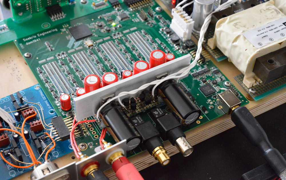

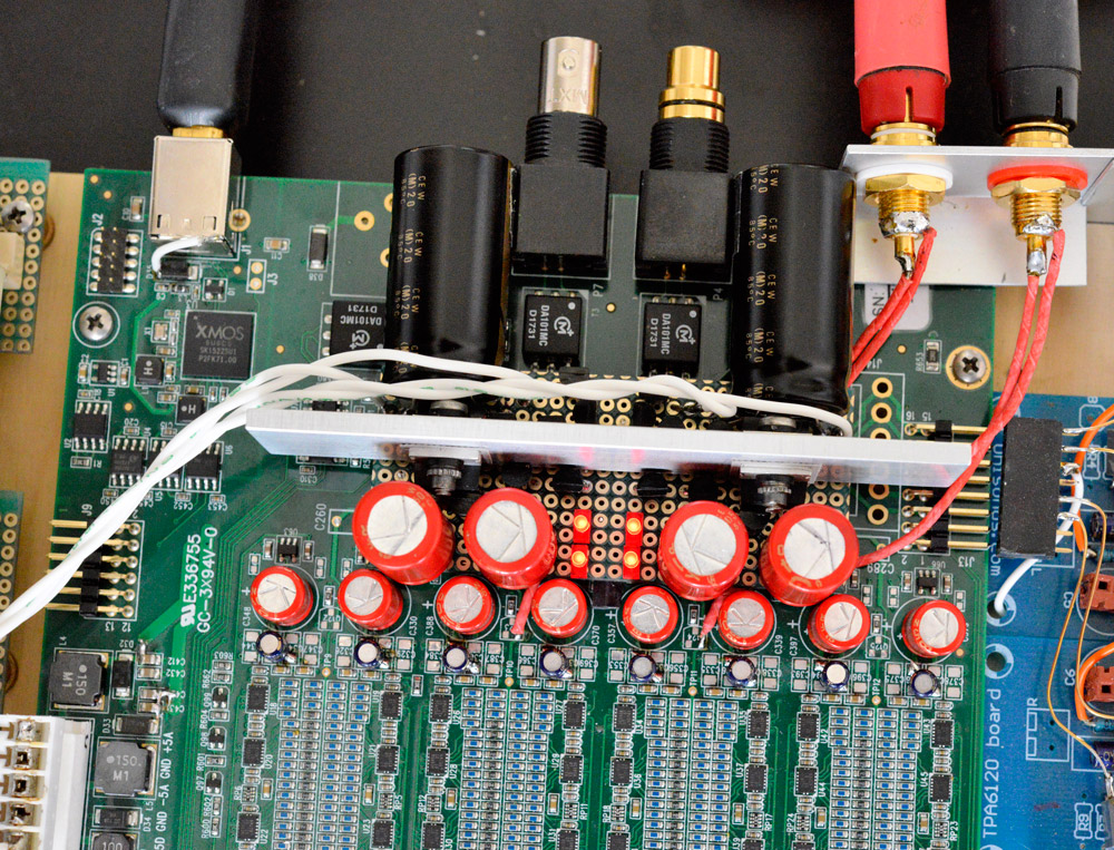

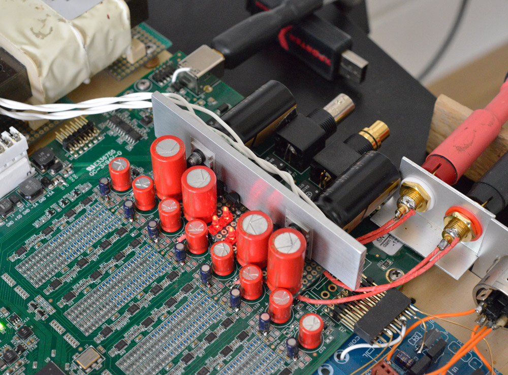

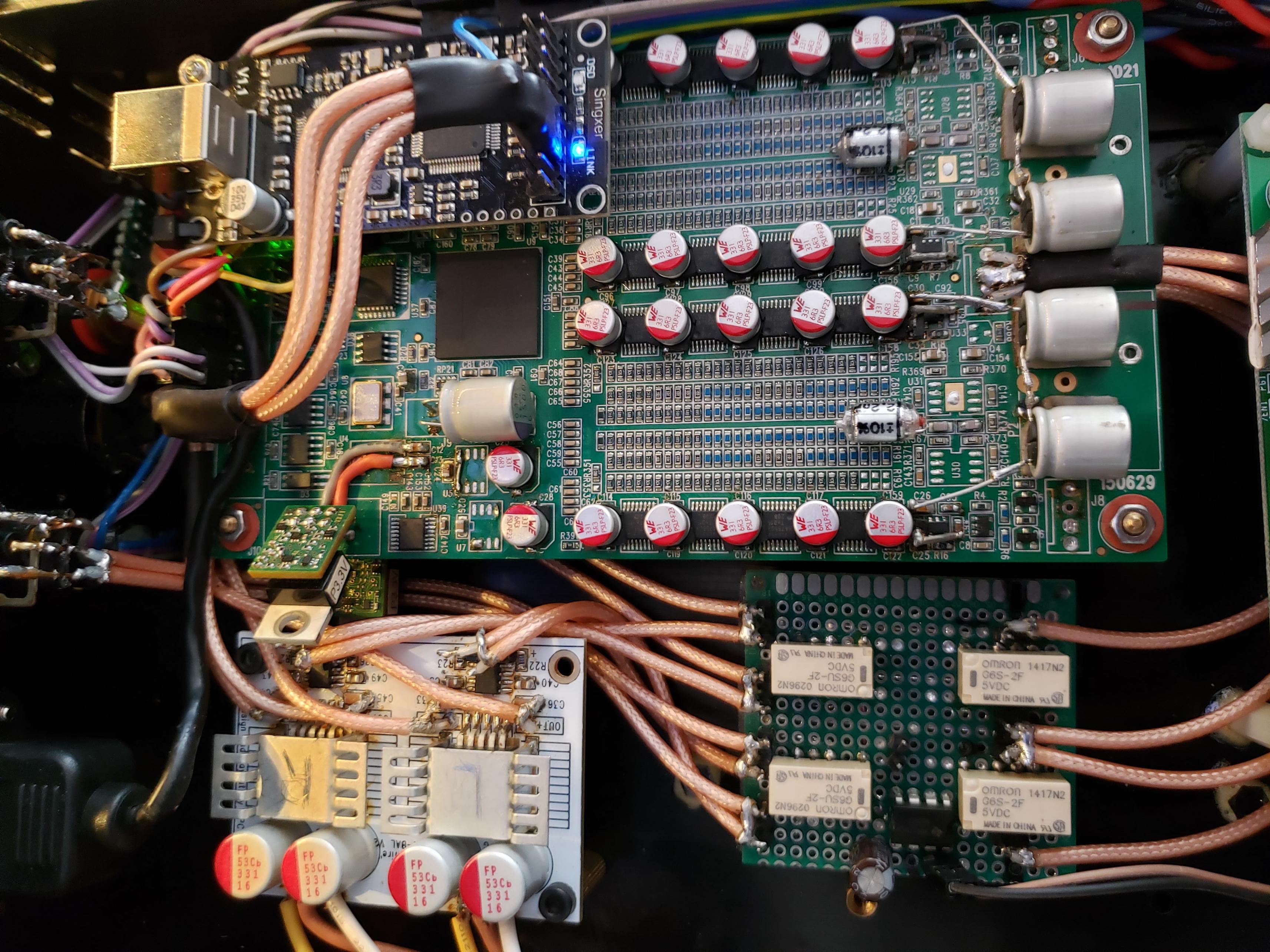

Sometimes though, going with custom board has its advantage. Over the weekend I decided to redesign my regulator board in a way that it fits directly in an empty space close to the output connectors. It also plugs directly into footprints of large caps that were there previously. I had to remove XLR and optical inputs, but I never used them anyway. It all fits like a charm. That's what I call proper integration 😉
