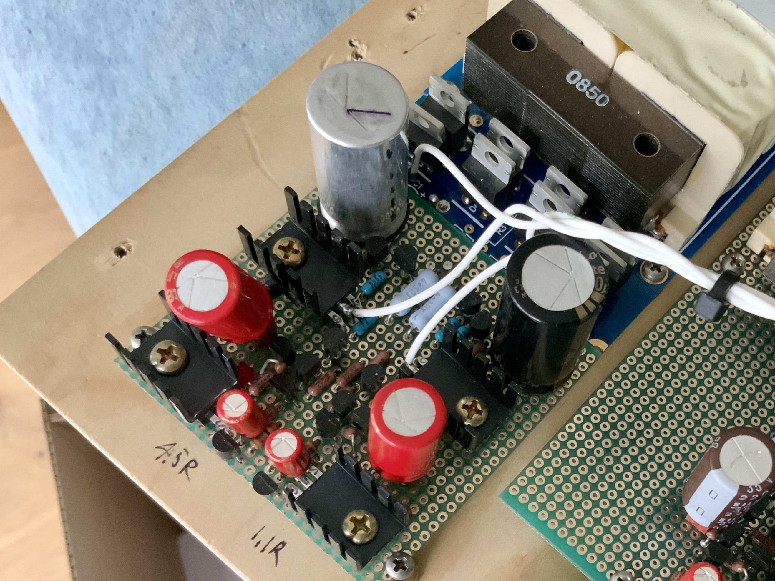

I could not wait and attached the DIyinHK board (LT3042)
0.8uV Ultralow noise DAC power supply regulator 3.3/5/7V 1.5A*x2 - DIYINHK
I used for analog +/-5v directl to the board where the 4700uF sat before...this is a clear Yeeeeeeeesssssssss !!!
The bloated, fat, warm and not very treble intensive sound is gone now....the silmic sound is gone...and it is very intersting to experience how sensitive this DAC is on the PSU-side...
I will build the Ultrabib next, thanks to Analog_SA for sending me the pcbs...you are my man...

BTW, where can I get some of those Ultrabib pcbs, I had to built mine p2p and modding them is not convenient.

Glad you liked it and you join the party...I am very happy with the Mundorf smooth foil currently...did you try the mod getting the 4700uF away and apply your external reg directly into their pads as well ? Big jump in clarity and dynamics...
I will play with caps as well...a 1uF MkP has about the same ESR as a 100uF lytic...but much better HF behavior and much better dialecticum...I would not be surprised if this would even be an option...and the 25uF I mentioned goes down to the 10mohm Soekris wanted to see...
My next thought is: If stuff is so sensitive as we experienced...what is the chain around it ? Those caps are...fed by the opa365s...and that one is kind of fed by....the Lm431 as a Vref source, right ?
Hmmm...so what about going back to the source...what if a Tentlabs Shuntreg, a Salas Digital D reg or a battery would give the Vref instead a LM431 ? Should be easy to try ... Lm431 out, battery like 26650 in....no ?
