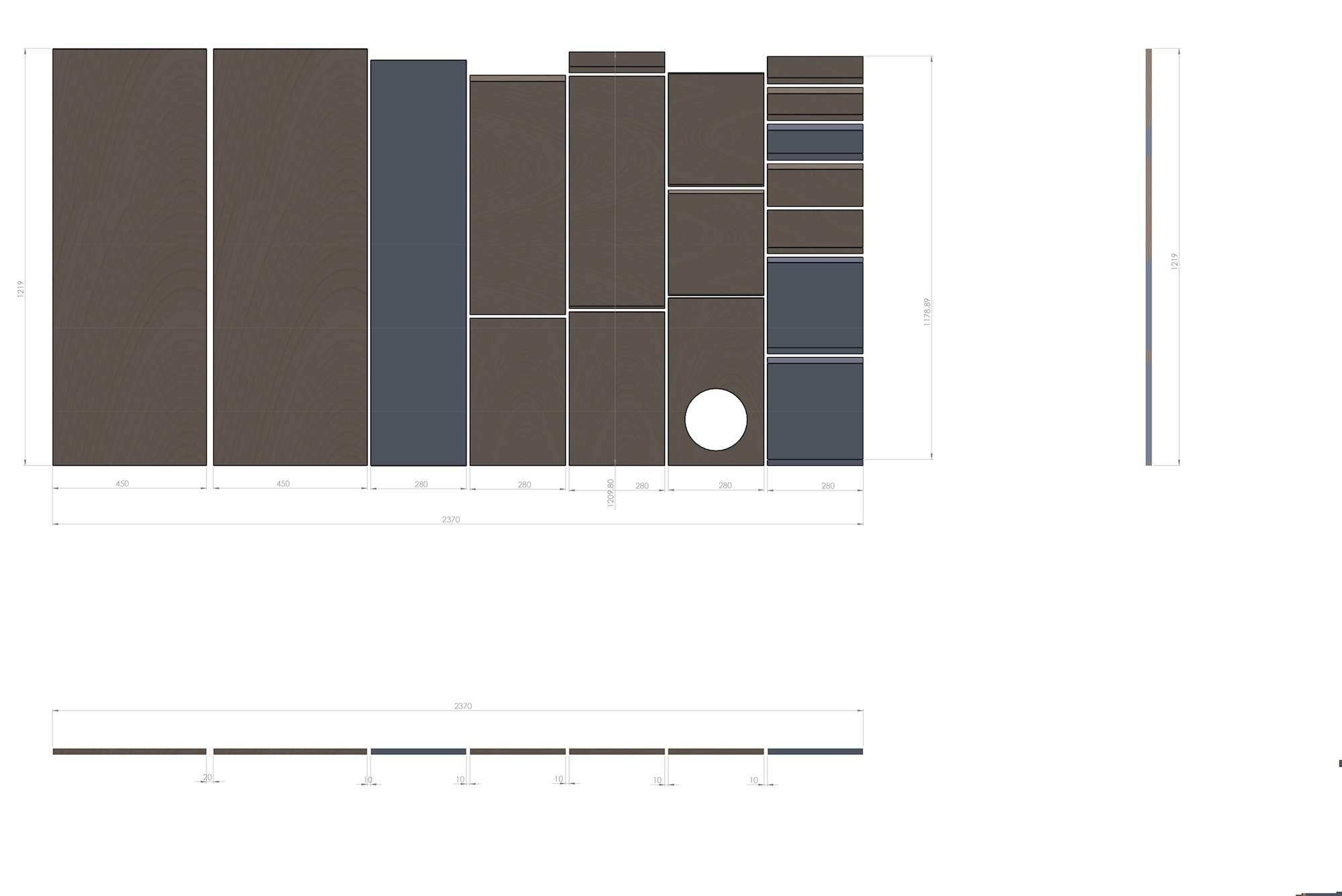

Coincidentally I worked last night until 3AM to retrace everything on my modeling software and everything checked out very good. Now all I need to do is recheck everything with your latest schematic but I recon everything will be ok. I managed to squeeze the whole project into a 2500x1250 mm board, so you can make one enclosure from one sheet. Monday I'll go get the wood and start the work. Thank you and happy birthay!
*later edit*
something like this picture. It's convenient if you buy the wood from some place that can only cut straight, then you can ask them to cut long pieces that you can fit in your vehicle. Then each piece can be sized into the corresponding parts. I left 1 cm between all parts so there's no problems if the initial cut isn't perfect. Units are in mm. The large sheet can be cut into 2 sheets of 450x1250 mm and 5 sheets of 280x1250mm. This way is easy to cary from the store and can be angle cut at home or somewhere else.

I rebuilt the speaker from your latest specs and I think there are 3 angles that don't fit right. First, the 45 degrees angle from the G piece should be 45.5 degrees, then F piece both angles should be 9.7 instead of 10.2 and 17.9 instead of 19. This way the H piece lines up parallel with the bottom part and almost all dimensions work out within 0.1mm from the schematic that you posted some time ago (the one with green writing, not the older one in red). Please correct me if I'm wrong thou. (after the party 😀 )
...and I think there are 3 angles that don't fit right
Thanx for the QC. The angles on the G & F pieces i was working on were correct, the pieces were not correctly drawn. I fixed that and redimensioned and they now concur with your numbers. I have replaced the image in the earlier post.
In actual practise tenths of a degree are impractical to work with, but we might as well be as true to Ron's work as we can.

You are right, hard to nail those angles when cutting/assembling. Thank you for your help, you made it easy for the rest of us to be confident in building this great enclosure!
