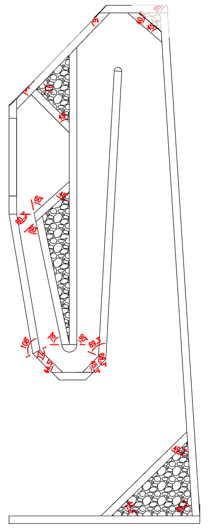

Something like this -- i'd be temped to lose the greyed back corner too. If you are going to curve the mouth i'd extend the bottom.

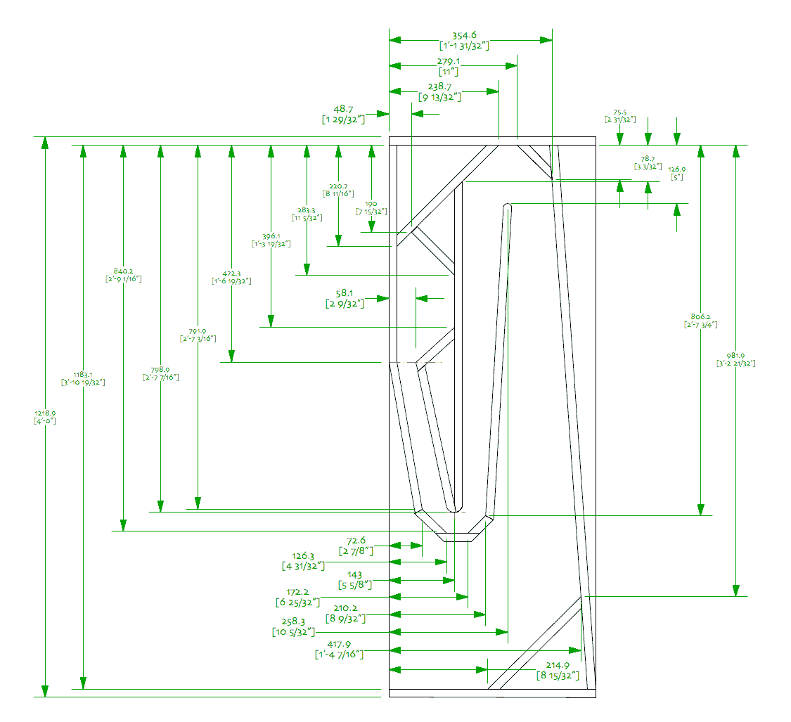

i've given up on the Dallas II as the plans are truly awful to read and most the angles listed on it aren't actually accurate, so you'd be doing a lot of fine sanding. i'd be happy to plug it into hornresp if you can get a reasonable overview of the horn path for me. i started making a 3d model of it and got annoyed and frustrated with the plans, so turned my attention to kirishima as its plans are very well presented.
Windows ate all the original CAD plans leaving only a random collection of raster pdfs -- it has been successfully built from those a number of times. At some point someone will step up and redraw them... i redid Austin A126 (but it took a big push ($$) by another member)

As I have gained a lot from being a member of diyaudio, so I will take on the challenge of re-drawing the Dallas 2 plans for the community.
Save your time - I did that yesterday, and Dave currently has the first rough DXF which was drawn on my steam-powered Autosketch 2.1 (vintage 1995) so there could be some problems with the vintage of DXF, and it doesn't export DWG.
There was some guessing and reconciliation of minor discrepancies in the PDF (missing dimensions, decimal rounding errors on cm metrics, and decimal fractional angles that might be hard to cut) For now all the dimensions, and optional cosmetic revisions have not been incorporated, but that wouldn't take all that much more time.
Also note that Ron's original sketch was based on 18mm material, and would require some adjustment for nominal 3/4" or 19mm.
Having drawn / redrawn / built more than a few hundred enclosures of various styles over the past few 15yrs, I'm confident of the accuracy of the drawing.

its all the angles that are poorly and inconsistently represented that finishes me off. something like that with so many angular cuts needs placement coordinates. even if you've got the wrong angle all you need is the value of the longer side and where to put it, to then get the correct angle.

anyone seriously interested in this project can PM me - it wouldn't take too long to add dimensions to drawings as well as attach a DXF (note above caveat)
edit: actually, Dave will probably be providing a link to this updated drawing on the FH website within the next couple of days
Chris' DXF pened fine in Illustrator and in Vectorworks. I have already laid out all the pieces on top, so that is the much of the work to a drawing all done.

That is where i'm starting. I will leave rationalization to the nearest mm to the builder.

thats much better! i'll put it together and upload this and the kirishima on the sketchup repositories (for the inquisitive) and post a few pretty renders of them next to each other.

prospective builders - feel free to eliminate the "void" cavities hatched in on earlier PDF as filled with sand, etc
and please do the design and drivers justice and use quality plywood, not MDF or stacked lamination, etc
