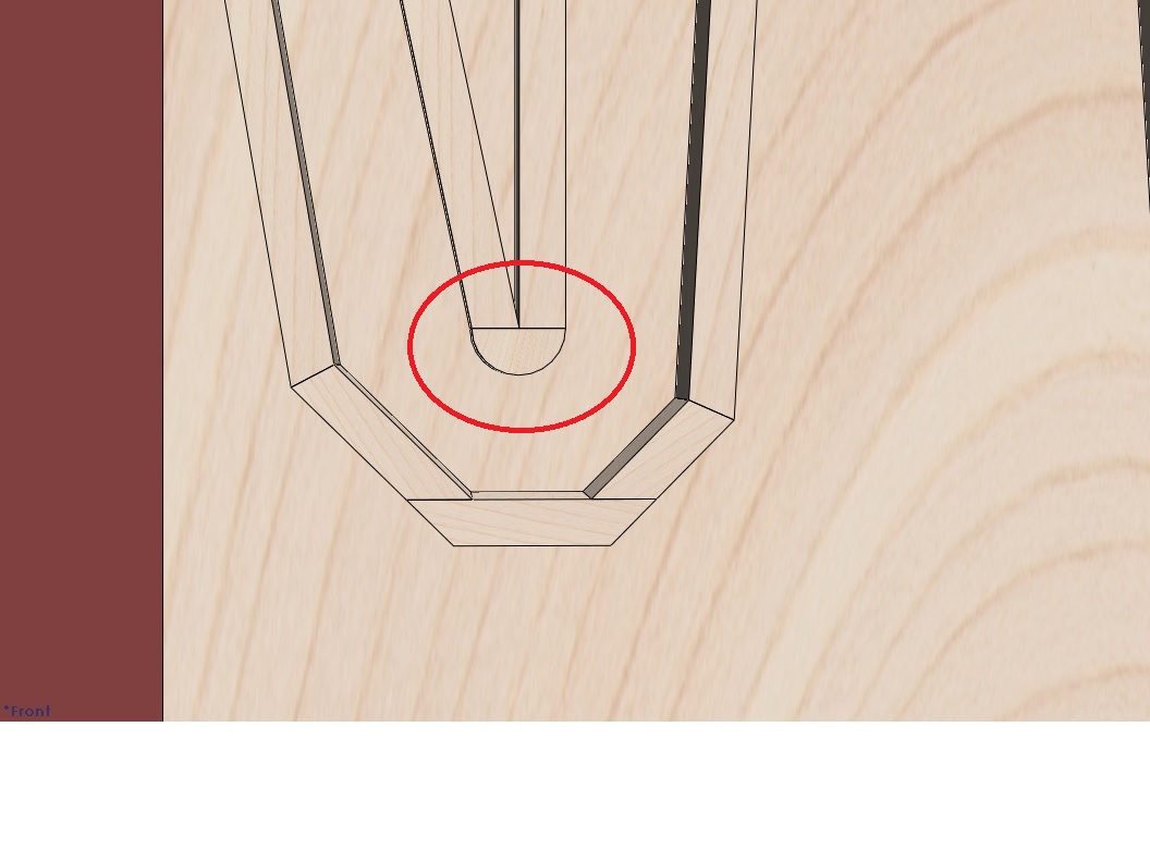

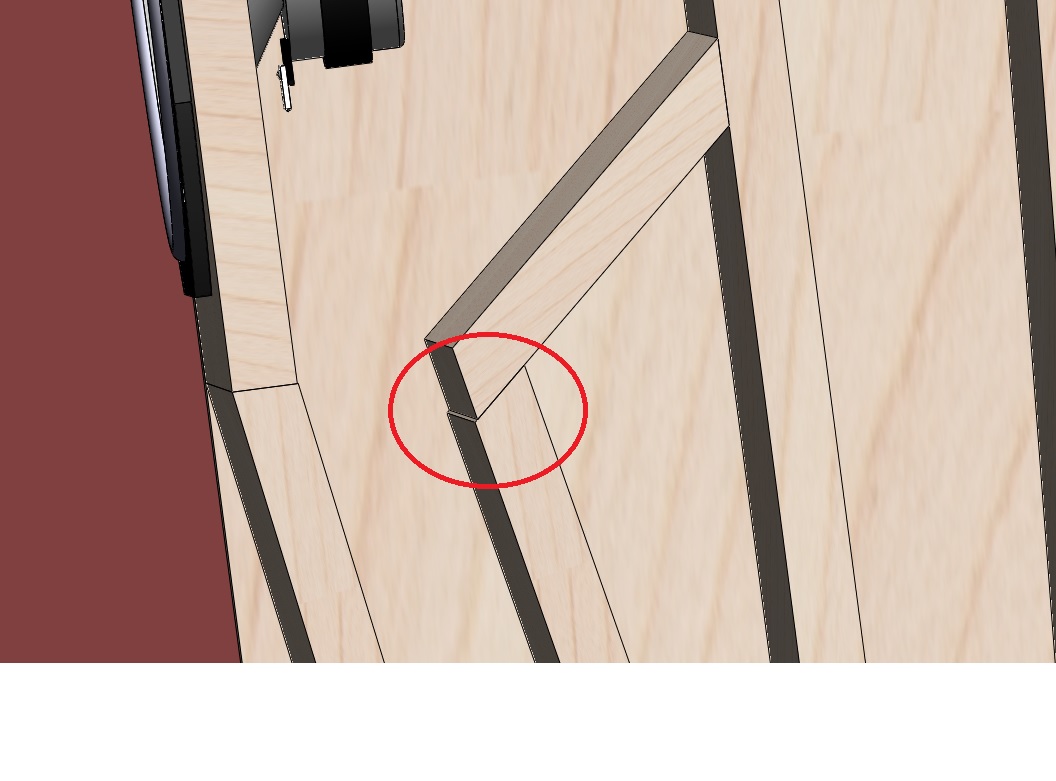

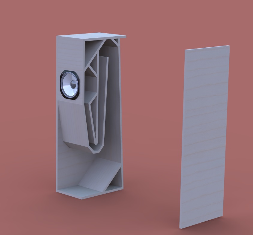

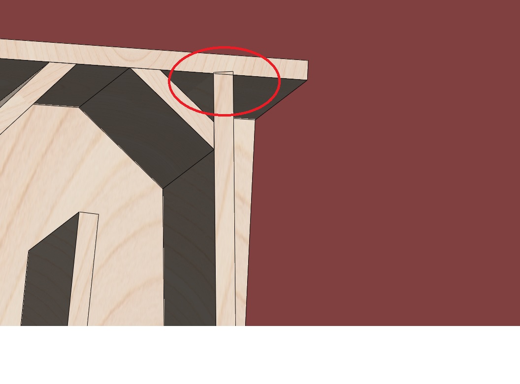

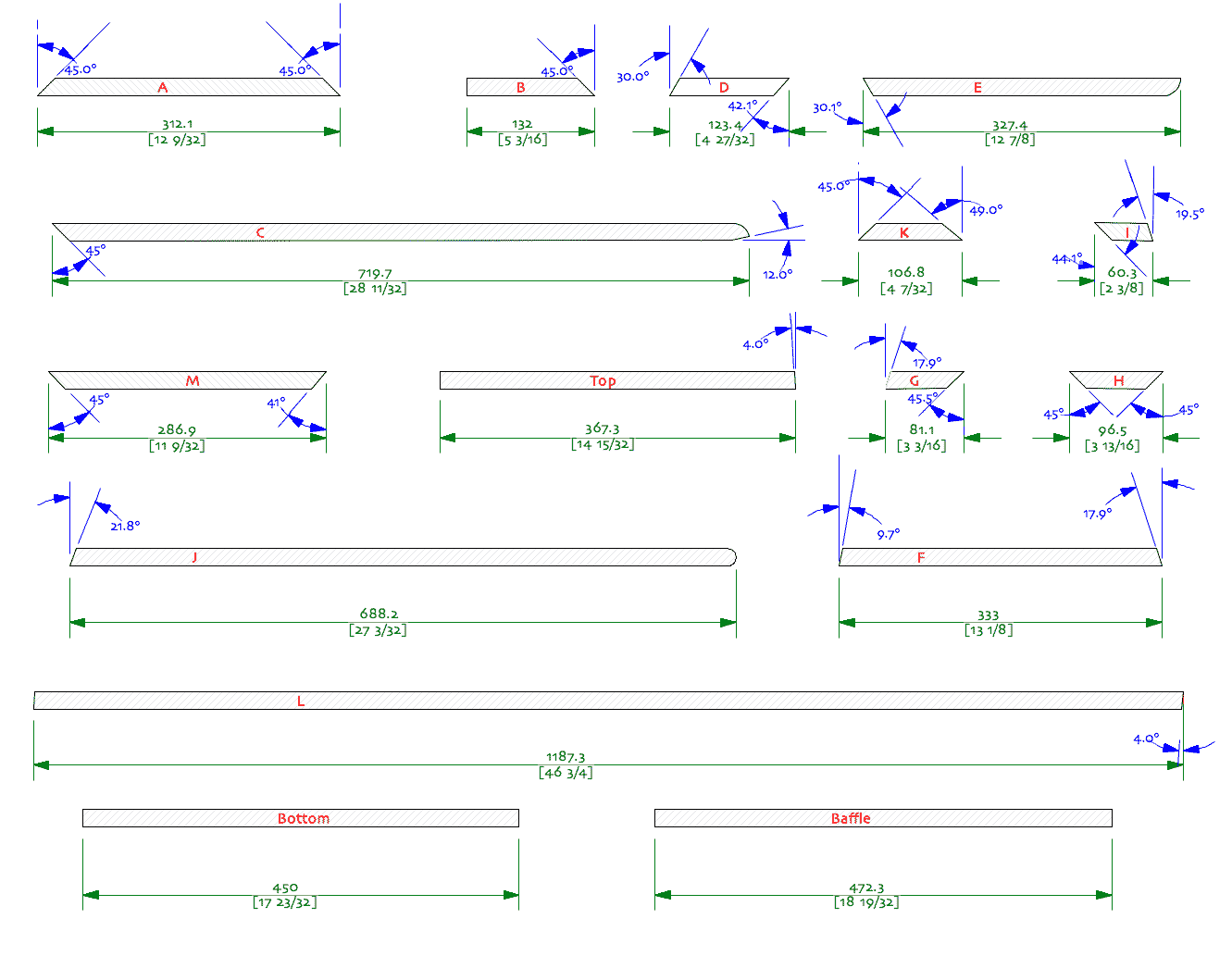

I decided to finish the Dallas II project so I began redrawing from the bits that were left online. I had access to a computer with SolidWorks software so I began drawing each piece and then assemble them together. I only encountered two minor problems and it may be that it was late and I was tired. I finished the 3D model and have each piece modeled separately but they are in the solidworks format. I could export them to dxg I think, have to search a bit for that thou. I attached some pictures with the problem areas but I think that could be very easily fixed. I may try the next week to correct. If interest is shown I could export all individual parts in dxf and archive them.
Forgot to mention that if you have all the pieces cut perfectly than you just connect one to the other, you don't need any reference points but the middle inside piece. That has to be constructed with some dimensions into account. If someone could tell me the reference points and dimensions I'd appreciate. To illustrate what I mean I attached a comparison picture to show how the center arrangement can move. I had no reference for it in my modeling software so I set it by eye when I took the screenshot.
Also there's one piece that I can't see how to easily manufacture, it's the turning edge on the lower pass. It's round and thick. I may make that from a 18mm thick piece and round it by sanding or some other means.
I also made a rough arrangement of all the parts included for one speaker and it seems that they would all fit into a 2500x1250mm plywood sheet with minimum loses.
these are the problems I was having with the Dallas II plans, and the main reason why i abandoned the idea of trying to use it, too much guess work for someone who isn't very proficient at all with horns or cabinet design in the first place.
I will proper finish the project into CAD and arrange the bad angles (IF they are bad and it wasn't a mistake on my behalf) and then post the whole project (individual pieces with angles).The good part is that all pieces are 18mm thick and 280mm width (minus the side panels but those are easy). So all that's needed are the lenght and angles. It isn't the easiest but I read that it is very rewarding. I cannot find another project for fe206eN given my room size with proper bass. The Kirishima is too big for what I need so I'm left with this design. As I recall Dallas II is for fe206e and I have fe206en. I wonder if it would work the same...

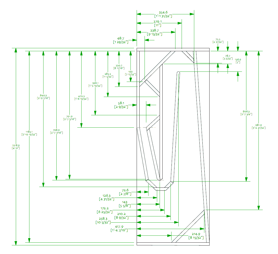

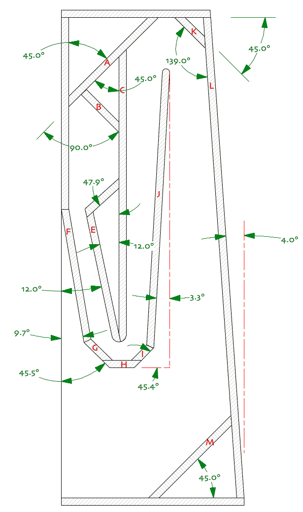

The picture in post #11 is a snap from a CAD drawing i must have done... that means i have plans at least mostly finished.
dave
dave
I trust you in this matter more than I trust myself 😉
waiting for the whole project
Regarding the Dallas II plans: It seems that the thread is dead. I am waiting for the other shoe to drop. Dave, is there anything more to see? I really like what you've done with the other drawings and I think they're enough to go on but if there's more, I'm more than eager to see.
