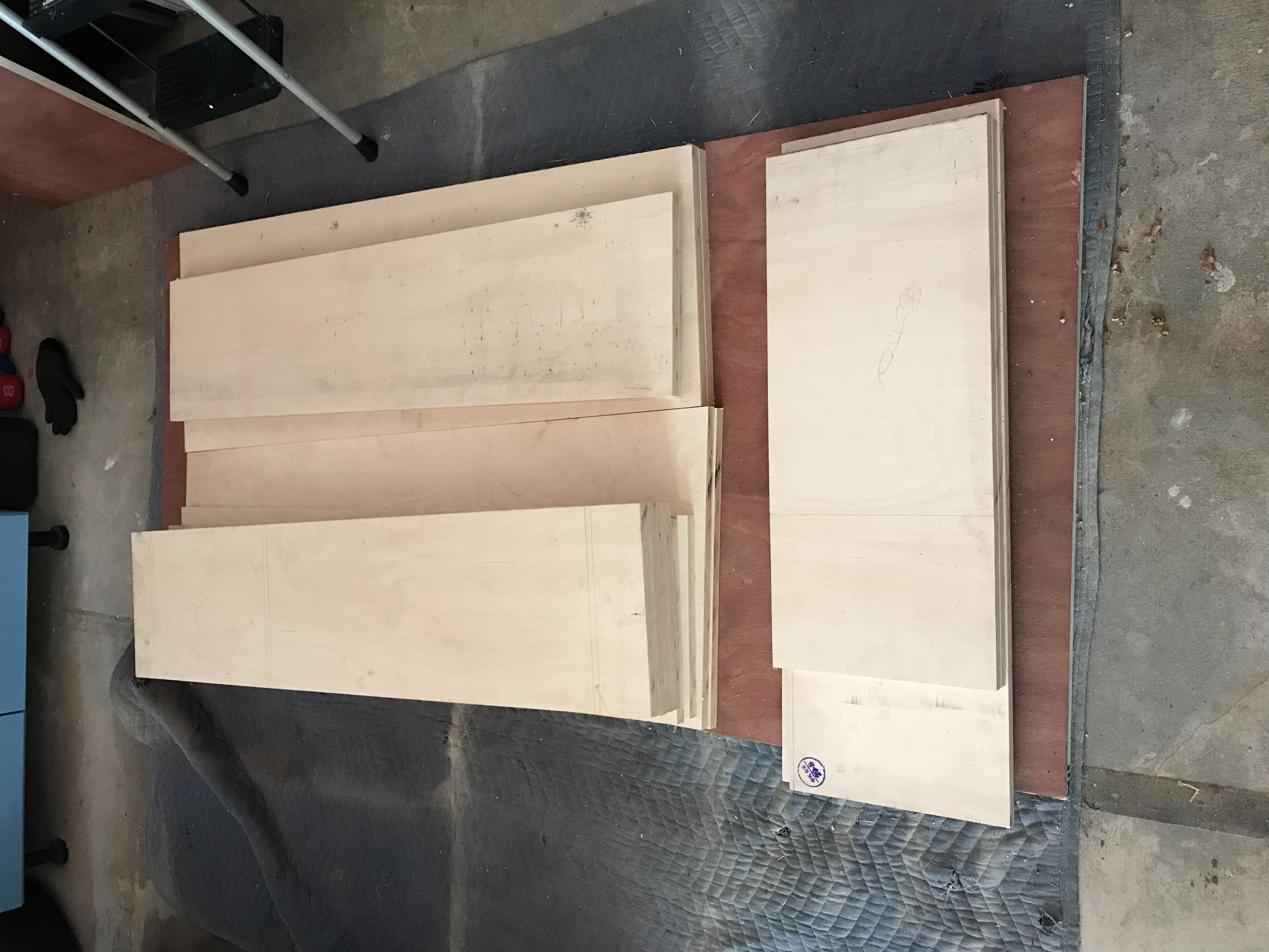

Update and question
Hi all. So. Making progress on the build. I followed the plans here from Planet10 for measurements and applied them to the cutting plans also attached. Fairly easy. I broke it all down with a track saw and it all looks fairly accurate. The interior pieces will be cut down from a series of long pieces all the same width. 11 1/32”. In looking at the pieces I think track saws being what they are and my own human error - over the course of the long cuts I’m off by that 1/32” at times. Should I stick these things on the table saw and true them up or just not bother?

True is more important than exact size. Note that the imperial measurement is an approximation of the (to the mm) metric native sizes.

I re-rip everything so that the odd discrepancy will be cleaned up. That said, having all your 90 degree cuts accurate is vital when so many angled panels are involved. No wonder people gravitate to cnc if they can afford it.

CNC — unless 5-axis won’t help with trimming the ends to the righ angles, and would likely be slower. And it won’t cut any straighter than a CNC panel saw or well setup an doperated table saw. More waste too.
