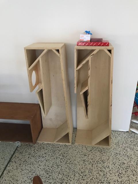

So I’m test fitting. And the throat of the cavity leadindown into the horn is about 1 and 6/16ths inches wide. It looks a little bigger in the plans. The lengths of my boards are right and angles are right there. Does that sound right to anyone that has made these? Using 18mm stock.
Seems a bit narrow looks at the plans. But it’s hard to visualize.
The drawing says 40mm (1 19/32”).
dave
Yep. I think my D board is too long
Update

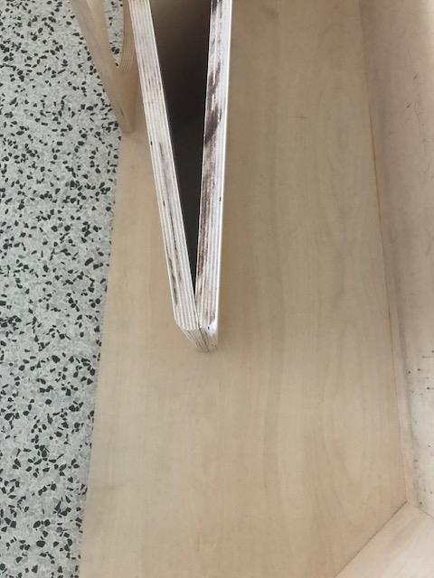

Right, so I fixed the problem with the D boards, and glued the inner part of the horn chamber together. It all fit fairly well.
In one of my initial posts I mentioned the 12 degree angle on the C board would be a problem. I tried to put the board on a jig perpendicular with the miter, but the miter at 12 degrees won't let a perpendicular board clear its housing at that height. A second thought I had was running the board along its edge on a table saw, but the table saw bevels outward away from the fence, and not towards it. So I went with my original plan and took the number 7 jointer plane to the edge after marking the 12 degrees on the board. The No. 7 stanley made short work of it, it was great. It also did well rounding the corners. I smoothed it all with a random orbital sander and we are all good. On the first board i got a little aggressive on one side with the sanding, and in the pictures you can see a gap where I rounded off the flat surface. I will fill it later and I'm sure it will be fine. For the second board the fit was much better. Overall I'm pleased with the results. Pics attached.
I think a rational person with more tools would have used a band saw and a tilting table for that 12 degree cut, but last night taught me that a well sharpened plane can do a lot of cool stuff.
Edit: The birch looks OK - but I'm considering some higher end wood veneers to make these things really pop. Any pros, cons?
