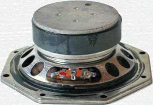

Hi all,
That Phillips driver had its back covered with felt. Can someone describe the purpose of the felt? Why was it there? What did it do for good or for bad?
I ask because it may or may not be useful for other wider range dipoles like that used in the Linkwitz LXmini. In other words replace the tube with a felt sheet and place the driver on a tiny baffle. Thoughts?

All the pictures look like the 5060SQ8 with the chamber cup removed, but I'm
sure they just ordered them without the cup. I have also seen pictures of the
back of the Dahlquist mid and the magnet is stamped with AD5060W8 but I'm
not sure what you'd find inside the cup of the SQ8 maybe a W8?
The 5060W8 that I've seen and bought had a rubber edge not cloth.
"but I'm not sure what you'd find inside the cup of the SQ8 maybe a W8?"
The cone is smaller in diameter, and has a cloth edge (really, a very different driver).
For the frequency range of interest the copper cap may not be needed (except for the lower distortion).
Post 27 is correct. The SQ drivers were not the same. My SQ had a smaller diameter cone with a cloth surround and the cone had a plasticized treatment. I would not expect the same behavior in the lower mid as the W version.
They look the same?
(to Ray Charles and Stevie Wonder maybe)
The SQ version was listed as 5.1 cm deep and 9.5 cm in diameter, while the W and M versions shared a separate chassis and were listed as 5.6 cm deep and 10.7 cm in diameter. The SQ had a resonance of 130 Hz while the M was 85 Hz and the W was listed at 50Hz. The pictures are of the back of an SQ while the other is a poor illustration of an M but enough to see they are not the same. The SQ was a very short travel driver.

I know that they are different drivers, but what I'm saying is that all the pictures that
I've seen of the DQ10s had the fabric edge SQ looking driver and not the rubber edge
W version, yet the DQ10 drivers had W8 stamped on the back.
I'm sure that Dahlquist could have had them made however they wanted or perhaps it
was early and late production.
I just took the cup off of an SQ8 that I have and nothing is stamped on the back of the
driver.
