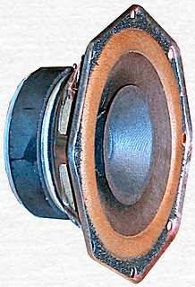

I remember Philips advertising their change to aluminum coils for better power handling.
I know their M version of the driver had a cloth surround. They could have had some cloth versions of the W, especially for a large customer. The cloth M version with whizzer cone was used in the Rectilinear III.

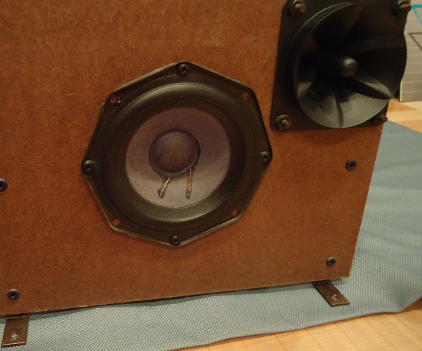

Based on the number of pictures that I've seen with the AD5060/W8 mid woofer I'm
going to say that I was wrong about the SQ8 version ever being used.

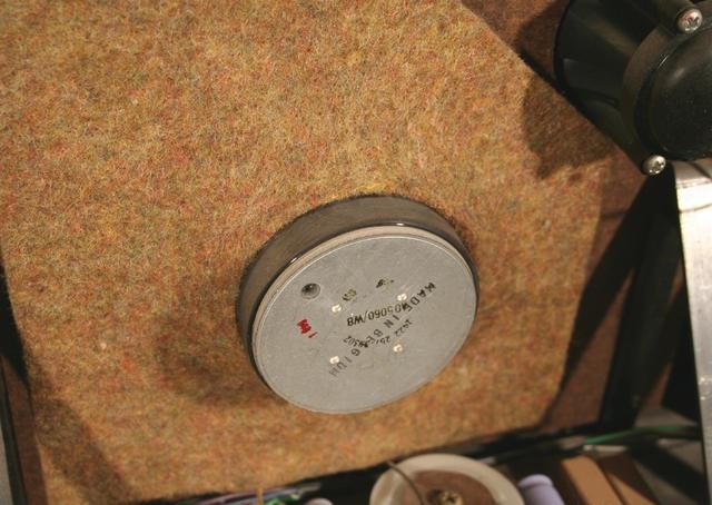

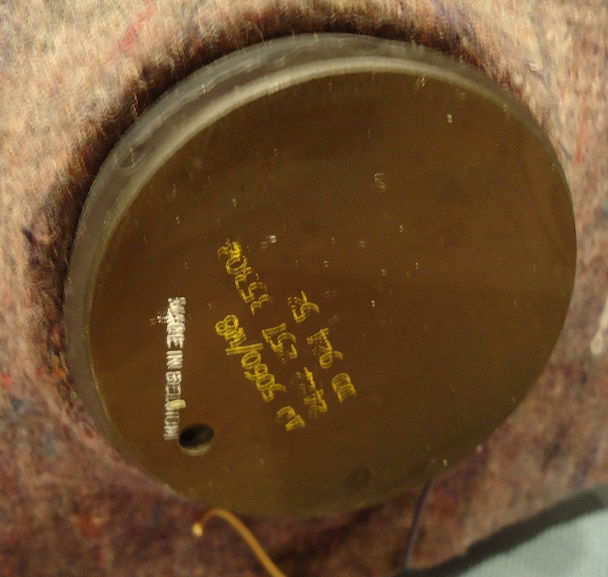

Just bought what appear to be later production, gently used, DQ10s, serial numbers 49XXX
range. They have the AD5062/W8 midwoofers and to not appear to have ever been worked
on. There are no signs of overheating anywhere in the crossover. I believe that the AD5062
version came from the factory and it is a good thing because they have much higher thermal
capacity.
The mid woofers had these markings, guessing that they are from 1983:
AD5062/W8
2422 257 35304
DD 00 315 83
MADE IN BELGIUM
Pete B.
