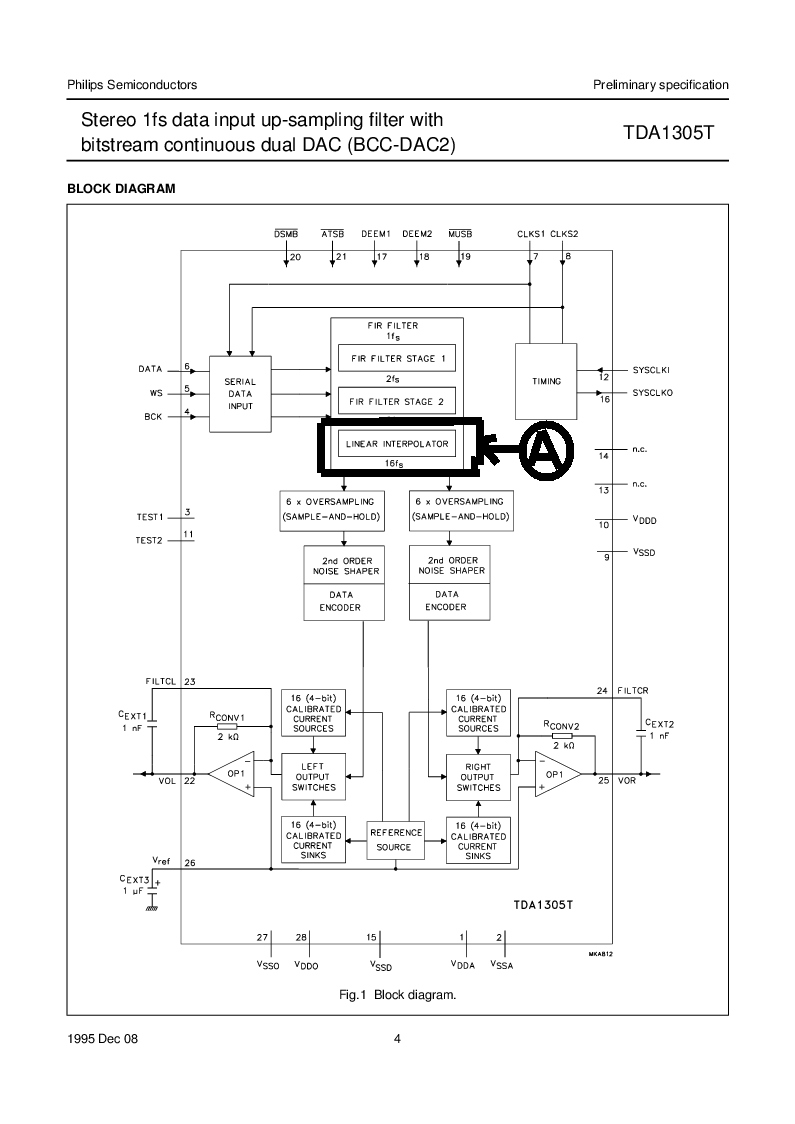

What doing Block A in the image below ?

It says linear interpolation, so I assume that is what it does. I assume the damage this will do is corrected by another digital filter.gumo73 said:What doing Block A in the image below ?

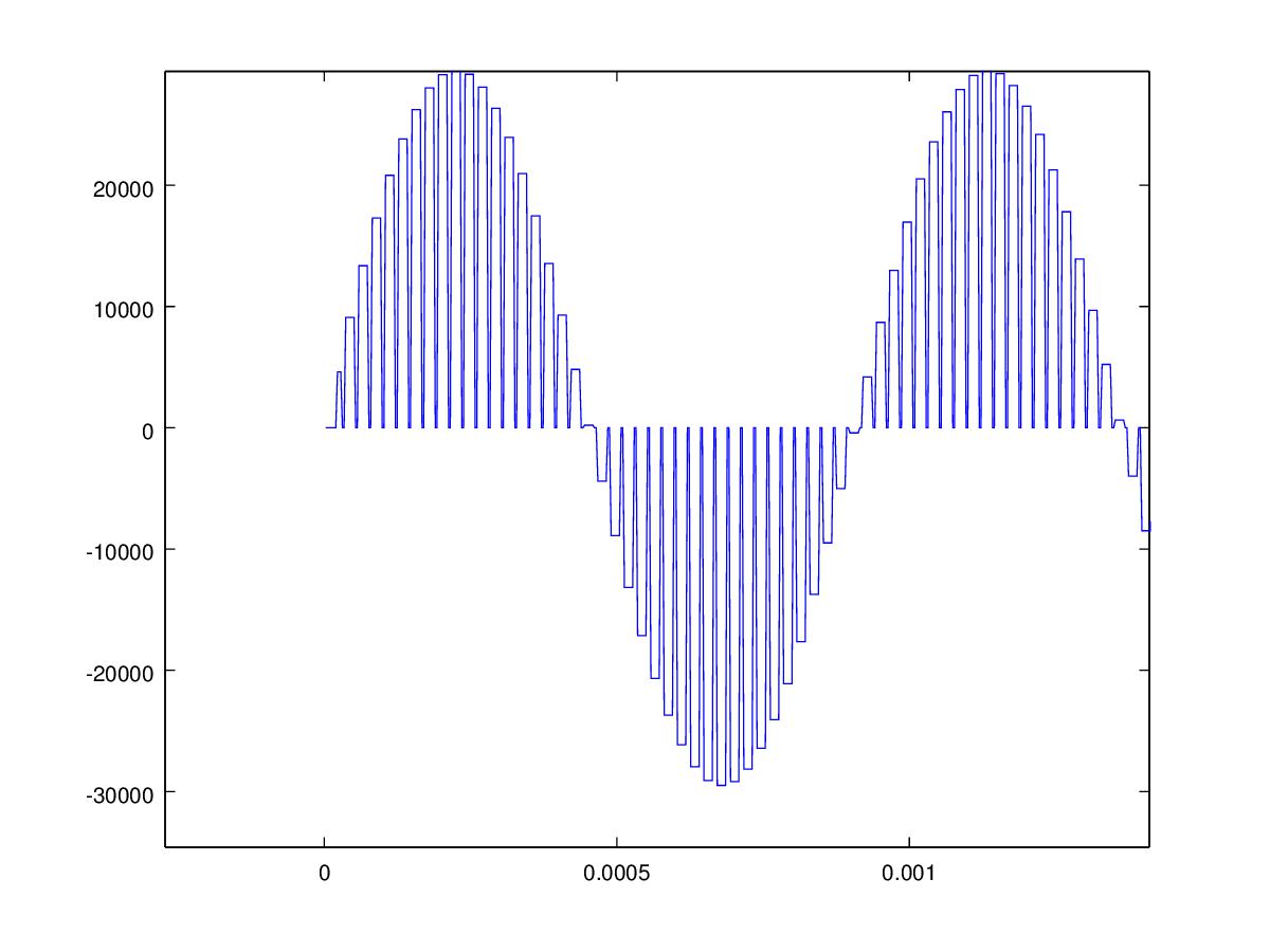

Mouting output
I have tested a muting stage for output of the dac during
settling time .
Muting to 0V is a bad idea fft is worst than normal dac
Good question about the settling time definition. I believe this value gives the time needed to reach the analog output value that is within +/-1LSB of the ideal value. So if you mute the output for 0.2 us after the conversion time, you could eliminate this error.
I think muting of the unwanted part is better than sample-and-hold of the wanted part.
settling time .

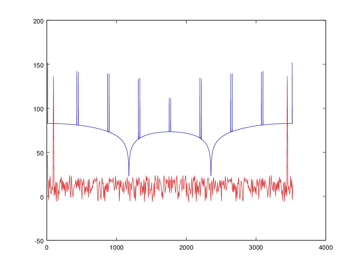

Simulations
This is results of simulation with octave/matlab
Red is original place to the 1100hz (fft)
Blue is the output after muting (fft)
This is interesting, have you shot some photos?
