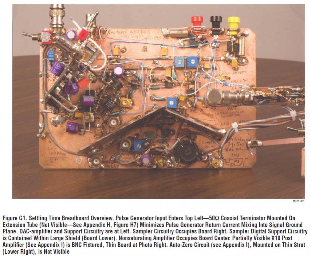

Richard, the paper by Jim Williams is a very very interesting read. Thanks again.
I´d like to quote:
"The measurement results presented in this publication
required painstaking care in breadboarding, layout and
connection techniques. Wideband, 10μV resolution
measurement does not tolerate cavalier laboratory attitude.
The oscilloscope photographs presented, devoid
of ringing, hops, spikes and similar aberrations, are the
result of an exhaustive (and frustrating) breadboarding
exercise1. The breadboard was rebuilt numerous times
and required weeks of layout and shielding experimentation
before obtaining a noise/uncertainty fl oor worthy of
20-bit measurement. In particular, extreme measures were
required to minimize sample command signal feedthrough.
Layout techniques include minimization and restriction of
radiative paths, ground plane current management and
mounting the LT1228 “switch” upside down, allowing its
V-referred substrate to approximate a monolithic shield
for the IC’s internal circuitry."

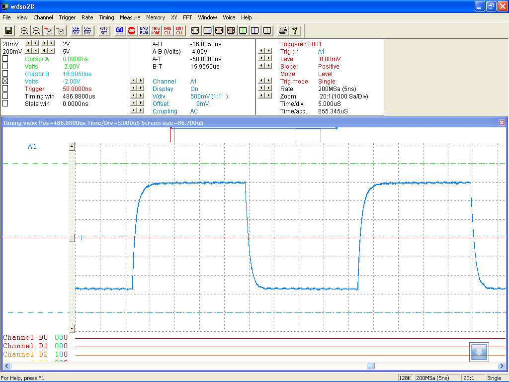

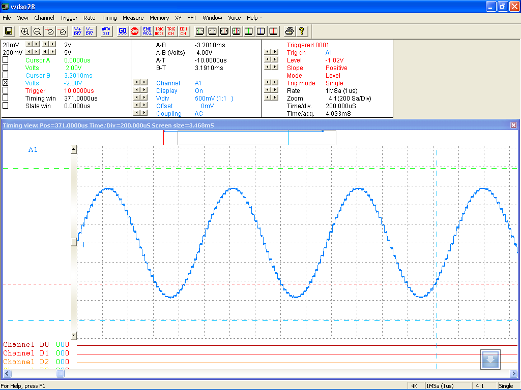

Yes, measurements would be interesting. My DSO is broken.
I just dig up a settling time measurement of my AD1865 + common base I/V stage. It´s a 20khz square wave. IF you look closely the settling time is clearly different for the falling and rising edge, actually the "knees" all look a bit different. Doesn´t tell much. There is clearly noise and maybe a low level oscillation riding on the signal.
That dso was pretty capable in time resolution. Analog BW 100MHz and sampling 200MS/s. The settings above say there were 1000 samples per division! I should have saved the waveform data to zoom in and analyse. Instead I only made screen capture. Vertical resolution was poor: 8 bits and the lsb was noisy always. Still very useful, but gone beyond repair now.
I recall that I made these measurements using a protoboard! No ground plane, nothing soldered. Just having some fun. They would have been a million times cleaner with dead bug technique over solid ground plane. Which is how I plan to do my next dac. (After I fix my lm3886 amp psu. I will make it regulated and with quite a bit of capacitance AFTER the regulators!)
Here's passive i/v versus common base i/v. 1KHz sine. Very different levels.
