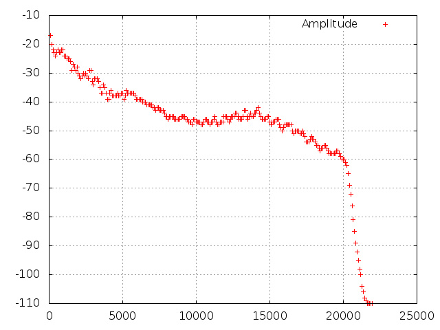

Ok is possible by bad mode to evaluate the delta of bit of audio word
if we think the 0 db at value 2^16=65536 , the value of an example audio track
start at -20 dB this means at 0.1 of maximum range about 6553.6.
The spectrum at 15khz is at -45dB this means 0.0056234 of maximum range this
means a delta 368.54 .
This analyis don't consider the envelope but only attempts the maximum possible delta
on bits

Results of tests
I have tested Delta LSB on a some parts of music tracks .
Is Right 500LSB is a good point to start a dac project here my results by Gaussian Calculus
Medium value 204LSB
3 sigma value 457LSB
If the settling time is reported for only 1LSB change that's a fairly useless specification. But the ADI DAC Schitt uses isn't specified for such a small change - 500LSBs is one figure.
Yes NOS I believe sounds good for the reason of the DAC being at the right value for a greater proportion of the time.
Medium value 204LSB
