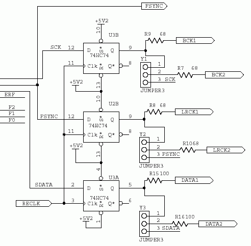

Dear rfbrw
Similar to the transmission end, however reset returns to XRST
CLK is to MCK, the reception end contains three flip flops
as well reclocking the three codes once more. By clocking at
transmission and reception ends it lessens any degradation from jitter arising from the interface, which I consider is beneficial
over the accepted SPDIF standard.
A complete study of jitter would show many other areas where jitter can arise - including the manufacture of the Cd itself. The Stereophile article by Reme Fourre What is jitter published in October of 1993 provides a fairly complete cover of the subject
Sterophile may be able to provide a back issue
Between the transmission end and reception end is a
Maxim Max 497 providing 75 ohm drive.

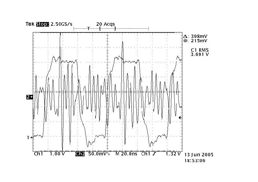

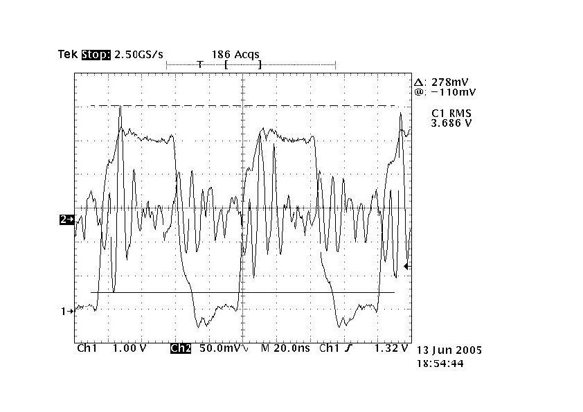

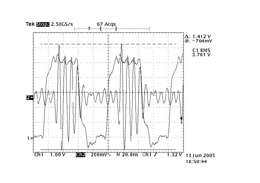

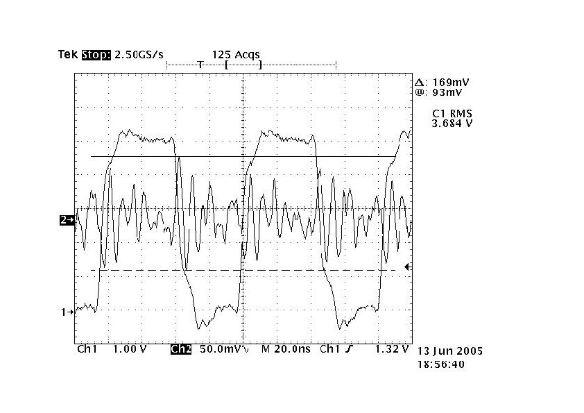

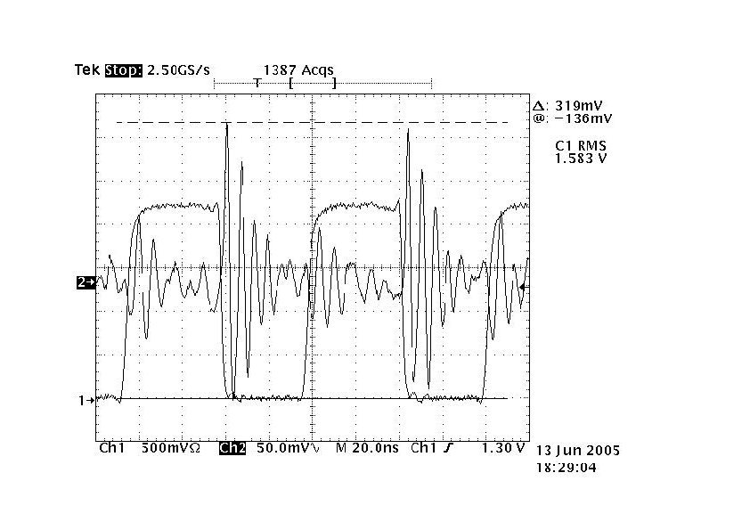

Times ago I had made up a little jig to measure supply rail noise from different cmos gates. It consists of a cmos inverter based 12 MHz clock generator, which is driving a D Flip-Flop tied up like a divider. The divided down signal leaves the bord across a BNC connector fit in, the PS rail signals I am picking off by the means of a TEK P6137; 10.8 pF, 10Mohm, 400 MHz scope probe. With Loong lead lenght.. , though wrapped up as tight as possible.
The 7474 flop is put in a socket, so as to be interchangeable. The local decoupling consists of a 100 uF + 100 nF axial lead kemet ceramic cap, accross pin 7 - pin14 of the socket. No ground plane. The supply is a lab supply with long leads.
Yes, it is a brutal setup, on purpose. I wanted to see the problems better! I know, that the scope probe on pin14 does not pick up power supply voltage bounces only, but rather picks up all the EMI generated
by the circuit. But, I have to note, that this setup produces quite similar signals to which I can see while poking around in a dac or CD player..
The scope is a TEK TDS 654C; 500 MHz - 5 Gs/sec.
Channnel 1 is always the Q output of the flop, connected to the board accross the BNC. Channel 2 is the signal between pin 7 - 14, picked up by the scope probe.
The first diag. is an AC74, the channel 2 input on the scope is non terminated, 1Mohm. [the cable is a 4nsec lemo cable]
Look out for the cursor readings!

What I noticed from these tests above here, that in the case of termination my test setup is not adequated any more to show the differences. The [probable] EMI disturbances picked up by the scope probe are showing the high current peak where the signal changes states, and then I'm quite sure that the remaining resonances are originated both in the circuit & and the scope probe. In any way, quite the same in all cases.
In the same time, in the non - terminated situation, the pic. is changed strongly - the AC logic behaves like a real noise generator! AND, I should add, that THIS is the case in most of the real life circuits! The short signal path leading to the some kohm / dozen pF input pin of the next logic unit is very far from resistive termination!

Dear Joseph K,
Very comprehensive !!! , as you point out unterminated lines
cause these overshoots in AC,
However you have found that given proper termination
there is general similarity otherwise in each family of gates.
The AC gate unterminated is a cause of noise generation
however if terminated is similar to other family members.
It would appear the message is to terminate all used and
unused lines when using AC gates.

Joseph K said:What I noticed from these tests above here, that in the case of termination my test setup is not adequated any more to show the differences. The [probable] EMI disturbances picked up by the scope probe are showing the high current peak where the signal changes states, and then I'm quite sure that the remaining resonances are originated both in the circuit & and the scope probe. In any way, quite the same in all cases.
Ciao, George
Terminating a 10M-ohm probe is not a wise thing to do.
The source impedance ranges from ohms to some 100's of ohms. They can be meaured using a voltage probe.
Nevertheless the measurements are quite intriguing and the results confirm my conclusions.
I did similar things long a go when I still was at Philips. I made a 10MHz pierce osc using 04 logic, tied input of another inverter to Vcc and meaured the voltage at that output. I used a 450 (!) ohm series termination and 50 ohm load termination at the scope. For the Maxwell lovers among us: A much (50 sq cm) bigger loop was needed to pick up similar induced voltages as measured.
Similarly, faster logic shows higher values of groundbounce. For those knowing what is inside silicon, this all sounds like logic......

Hello all,
George, I am intrigued by your measurements and have a couple of questions:
1. Are you suggesting that the ground bounce problem with AC logic can be fixed with a simple 50 ohm termination on the outputs?
2. Has anyone confirmed that terminating AC logic with 50ohm resistors results in the same SONIC benefit as replacing AC with HC.
FWIW, I replaced the 74AC74 chips on the output stage of my transport (Theta) with HC logic and the sound became more relaxed, less gritty in the highs.
If I can avoid the arduous task of desoldering the AC (the Theta uses doublesided, through hole plated PCB's) and replacing with HC by simply soldering in a 50 ohm resistor with the AC, that would be great!
Thanks for any info,
Ryan
