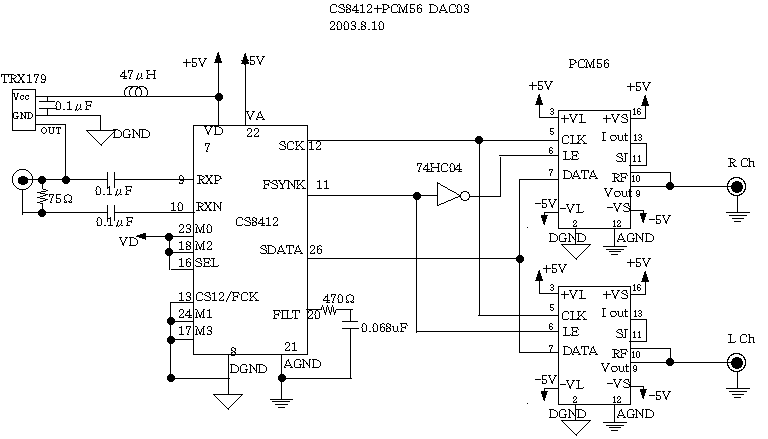

Thanks! yeah i like it but can i remove the filter selection?
Just a another question can i replace the pcm56 with a pcm63 in the schematic below?
thanks!

If your building a DAC like this , have a read of my
June 1997 Electronics World article about overcoming SPDIF
You will need to purpose modify a CD player to extract
DATA, LRCK ,BITCLOCK and using 74AC74 flip flops
clock each of these individual signals upon transmission from
the Cd player and reception at the DAC ie 6 flip flops
or 4 if you want to use the dual feature of these chips.
The aforementioned signals then feed the DF 1700
directly bypassing SPDIF altogther. recommended you
use a line driver such as from Maxim , the Max 497
to effect transfer as 75 ohm feeds.
It works spectacularly , but becomes a unique set up
making that CD player and DAC a tied combination
Its benefits are that SPDIF multiplexing is permanently
avoided. Cheers / chris
