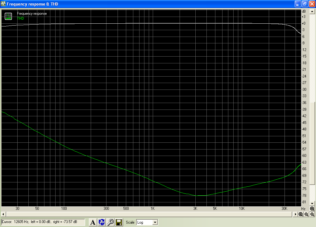

I bought 4 lundahl LL1539 on ebay for 50€ and i'am testing them on the out of my buffalo24.
I attach two measures of frequency response and THD done with RMAA, the first is with the lundahl directly connected to the out + and - of the buffalo and the second is with the lundahl connected to the balanced out of the IVY (the I/V conversion unit from TP).
For now i have had little time to listen the two configurations and cannot say which i like more, one strange thing is that also when the lundahl are connected directly to the buffalo i have really pleasing sound even if we have high values of THD on low frequencies. Maybe i like distortion 🙂.
Ciao
Andrea
(on the left buffalo -> ll1539, on the right buffalo -> ivy -> ll1539)

No wonder you get distortion with the 1539 as they are not perfectly suited to the task. The low RDC is probably the problem together with a low primary inductance.
As you like it so far, I am sure you can imagine how good it would sound with the optimal direct-connected transformer😉.

This is not the first time that it has been reported that the Sabre DAC sounds better working directly to a transformer in Vout (even though the DAC datasheet says there is lower distortion in Iout mode) - maybe it has something to do with slew rate distortion?. I find on the few DACs I've tried transformers, that it's a more natural & relaxed sound.
Don't think you like distortion. But rather the sound is good despite the distortion. THD is pretty useless as an indicator of the pleasure of the listener. Furthermore in your case. The distortion is 'only' in the low frequencies probably because of the small core of the transformer. Your brain does not care that much apparently about distortion in the low frequencies. (I don't think anyone's brain does) But I have no proof that distortion in the low freqs is hardly audible.
