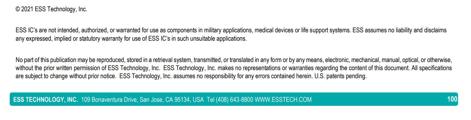

ES9033: https://www.esstech.com/wp-content/uploads/2021/10/ES9033_DS_0.3.pdf Beyond that early version, an NDA would probably be required.
What do you mean? They have published a datasheet on their website that is way more detailed than the one for the ES9023.ES9033: https://www.esstech.com/wp-content/uploads/2021/10/ES9033_DS_0.3.pdf Beyond that early version, an NDA would probably be required.
looks like a standard document to me
