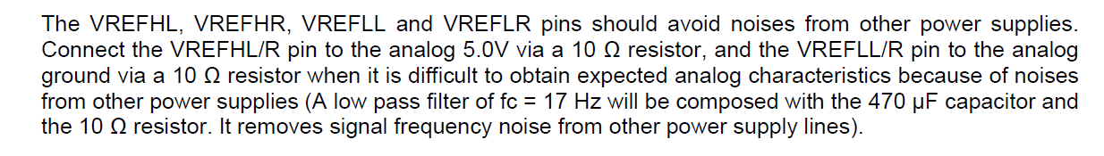

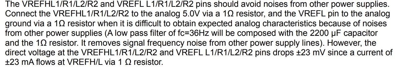

Actually AK4493SEQ datasheet explaines that peculiar circuitry but you may not like the explanation.AK4499 might have been the most obscure in that regard, with a peculiar, poorly documented bit of circuitry in the evaluation board that they knew somehow increased measured HD. But they neve explained why they did it or what it it was for.
Not so sure. The term, 'obtain expected analog characteristics,' could mean one thing over at ASR and another thing to an audiophile-oriented designer. Also, when they refer to power supply noise they don't say if its coupled inside the dac chip or outside the dac chip. There is some reason to believe they are being coy about noise coupled inside the dac chip through the substrate, hence the development of AK4499EX as a two chip solution. In any case, the circuit increases measured distortion so not clear how its helping to 'obtain expected analog characteristics' in that sense.
Moreover, they chose a corner frequency that has a very specific perceptual effect. They also didn't bother to bypass the 470uf electrolytic with a small film cap, which if done helps reduce HF distortion. The only reason I can find for not bypassing it is that doing so reduces the perceptual effect of soundstage enhancement. Now I just told you something else I wasn't planning on getting into...

Chapter 8 in datasheet describes the analog characteristics. Nothing ambiguous about those. Also datasheets are meant to be read as is so no need to read between the lines. If the RC filter is to reduce noise that is the purpose. Corner frequency needs to be higher than in AK4493 (36Hz vs. 17Hz) due to much higher Vref current in AK4499 which would result in a larger voltage drop with 10 ohm resistors.Not so sure. The term, 'obtain expected analog characteristics,' could mean one thing over at ASR and another thing to an audiophile-oriented designer.
