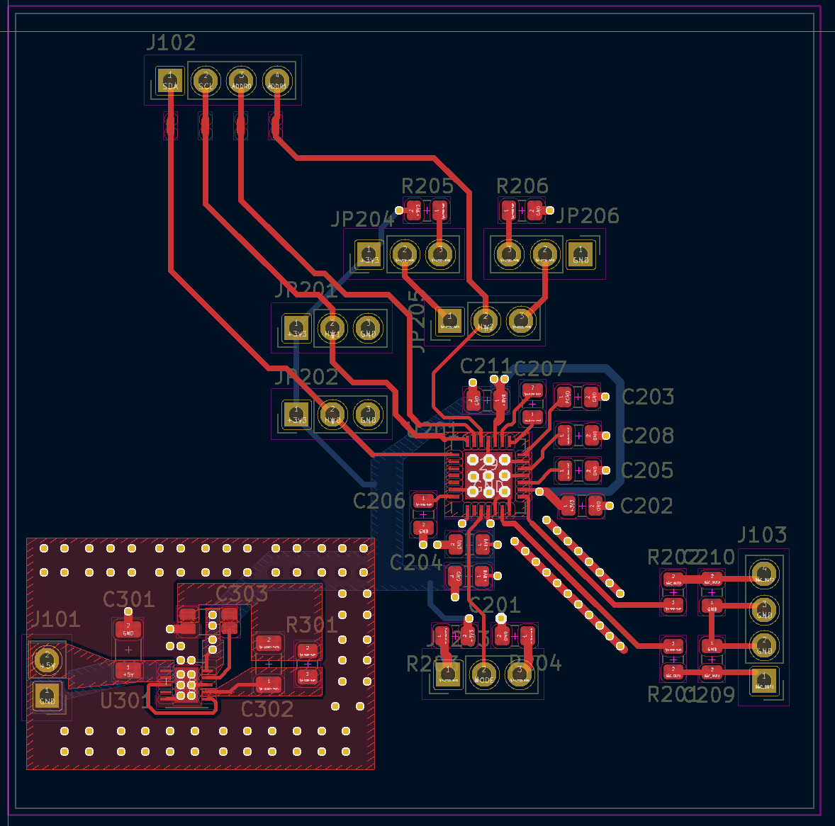

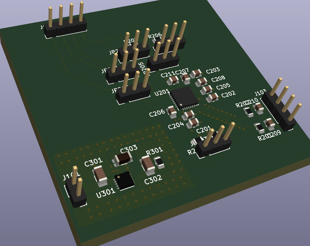

Add fast start-up to your LT3042 regulator. I would move the regulator much closer to the dac chip. Maybe rotate it 90 degrees clockwise and flip over to the other side of dac chip (right).
Ty for the reply, I was thinking if I need the fast startup, why is it useful?
Is the LDO on the right side better placed because it's further away from the digital area of the IC ?
Fast startup does not impact LDO performance and it just adds 2 resistors. For 3V3 it may not be necessary but for higher voltages the output rampup may take seconds. I prefer to use the same schema and layout for all voltages.
The location may not be important but LDO needs to be closer. As there is not much experience of ES9033 it is hard to tell which power pins are most critical. I would place the regulator closest to the critical power pin.
Would you share your implementation with me? seems like you got some experience with that LDOFast startup does not impact LDO performance and it just adds 2 resistors. For 3V3 it may not be necessary but for higher voltages the output rampup may take seconds. I prefer to use the same schema and layout for all voltages.
Fast startup is a definite requirement. I once had a LT3042 based 5V PSU without it and it took many seconds for it to ramp up. That caused strange behavior of the DAC and I think the reset circuit failed to work OK.
Implementation is datasheet wisdom. Just 2 resistors, no penalty.
Maybe look at the ES9038Q2M evaluation board schematic I posted earlier. As can be seen, AVCC gets additional filtering and or buffering since it is a critical voltage reference for the dac output. In other words, the audio output of the dac is multiplied by the AVCC voltage. Any noise or distortion on the AVCC rail gets multiplied into your audio. Hopefully use linear caps for AVCC bypass and or filtering.
Another critical refernce signal is MCLK (either one or two master clocks, depending on implementation). Ideally clocks should be close to the dac chip and copies of MCLK needed by other equipment (e.g. a USB board) should be buffered by something like NB3L553-D. Both clocks and buffers benefit from clean dedicated power and linear type bypass caps. Bypass cap damping resistors if needed should also be linear types such as thin film. My opinion and the opinion of others such as @diyiggy. Other people may disagree, particularly people who haven't tried it.
Also, if using LT304x regulators, the Cset cap should be a linear type, not a class-2 ceramic which is piezoelectric and converts mechanical vibration to voltage noise (among other LT304x implementation considerations). Agree with others that sometimes fast startup can be necessary as some load circuits are sensitive to power supply rise time.
Regarding mode jumpers, if the jumper is removed when power is on then you have a floating input. Better to tie an input pin to Vcc or to ground through a 10k resistor, then allow for a jumper that can connect the pin to the opposite rail which will override the resistor programming. That way a missing jumper will not result in a floating input.
